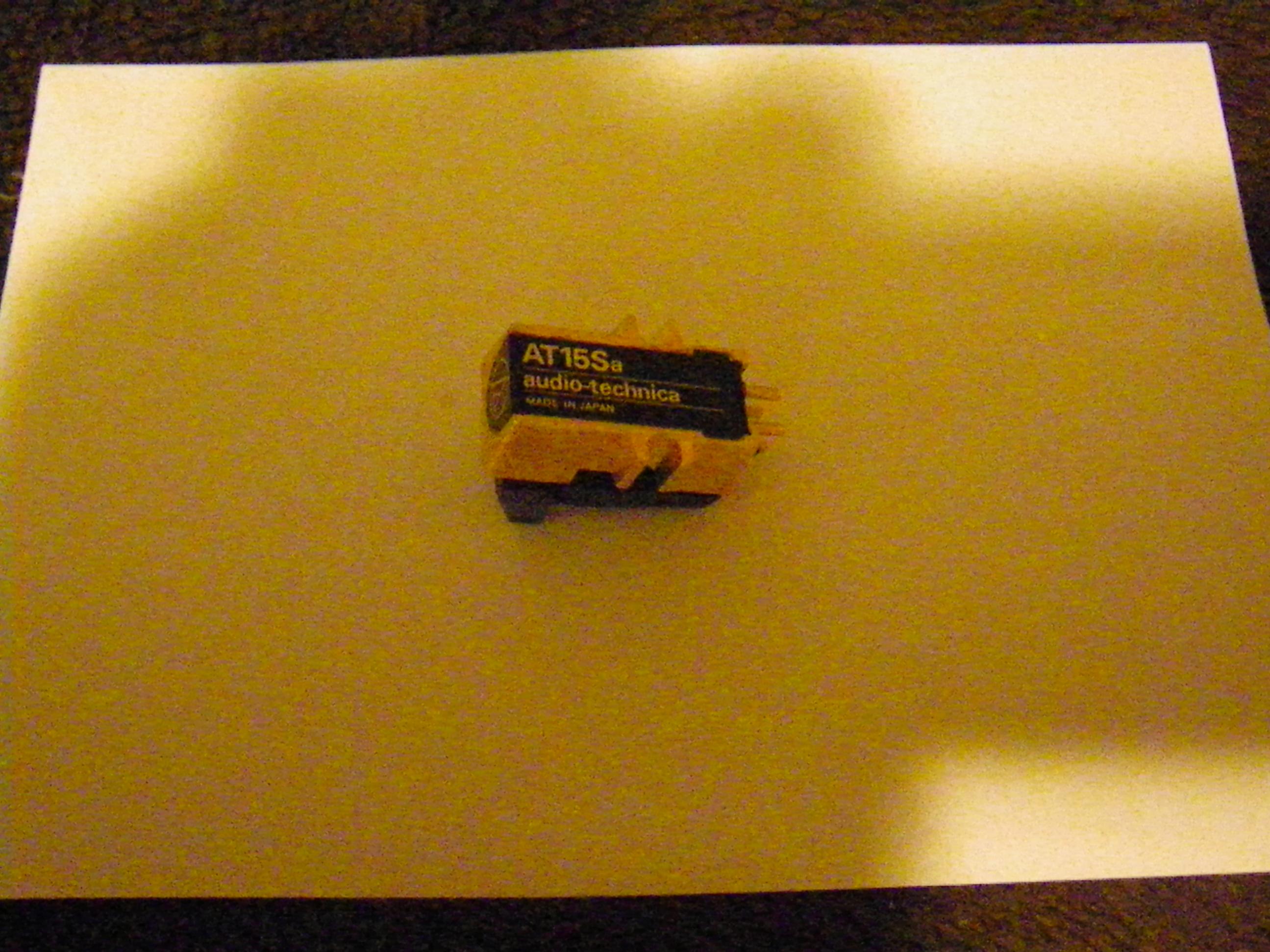

Hello! I was wondering if someone could help me? I just picked up Technics SL-d3 TT with a Audio Technica AT 15Sa cartridge and AT 15ss needle . The needle is shot what would I replace it with and how good is that cartridge and how old? I dont wont to spend to much,but I do want something descent! RT now Im useing a ADC OLM 30 mk111 . I had it in my collection it was never opened from 1975,but it is a spherical!
It must have been a decent cartridge, the vinylengine database lists it as having a Shibata stylus. You could probably get a replacement Jico or stock elliptical stylus for under $100.

How old is it do u know?
Mid to late 70's, but that's a guess.

On a budget go for the Red Ed elliptical :
Ed Saunders Red Ed Cartridge
More I'd say one of these :
LP Gear AT-95VL phono cartridge,LP Gear AT 95VL phono cartridge,LP Gear AT95VL phono cartridge,LP Gear AT-95VL phonograph cartridge,LP Gear AT 95VL phonograph cartridge,LP Gear AT95VL phonograph cartridge,LP Gear AT-95VL phonograph cartridge stylus,L
Stylus should last twice as long as an elliptical.
rgds, sreten.
rgds, sreten.
Keep the AT-15Sa, and save up for the best needle (shibata).
Like Audio-Technica AT-20SL cartridge stylus,Audio-Technica AT 20SL cartridge stylus,Audio-Technica AT20SL cartridge stylus,Audio-Technica AT-20SL cartridge needle stylus,Audio-Technica AT 20SL cartridge needle stylus,Audio-Technica AT20SL cartridge needl
or, if times are tight:
Audio-Technica AT-15E cartridge stylus,Audio-Technica AT 15E cartridge stylus,Audio-Technica AT15E cartridge stylus,Audio-Technica AT-15E cartridge needle stylus,Audio-Technica AT 15E cartridge needle stylus,Audio-Technica AT15E cartridge needle styl
Arne K
Arne K
I've got a shure M97 era IV. I bought it before 1980 and have played thousands of sides with it. It doesn't damage records. The diamond is still good. By contrast, a bargain Grado FTE I bought in 1974? the diamond shattered a chunk off in four or five years. So bargain cartridges can be no bargain. Last year I checked, Shure was still selling the M97.
