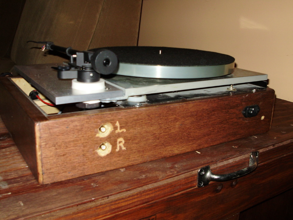

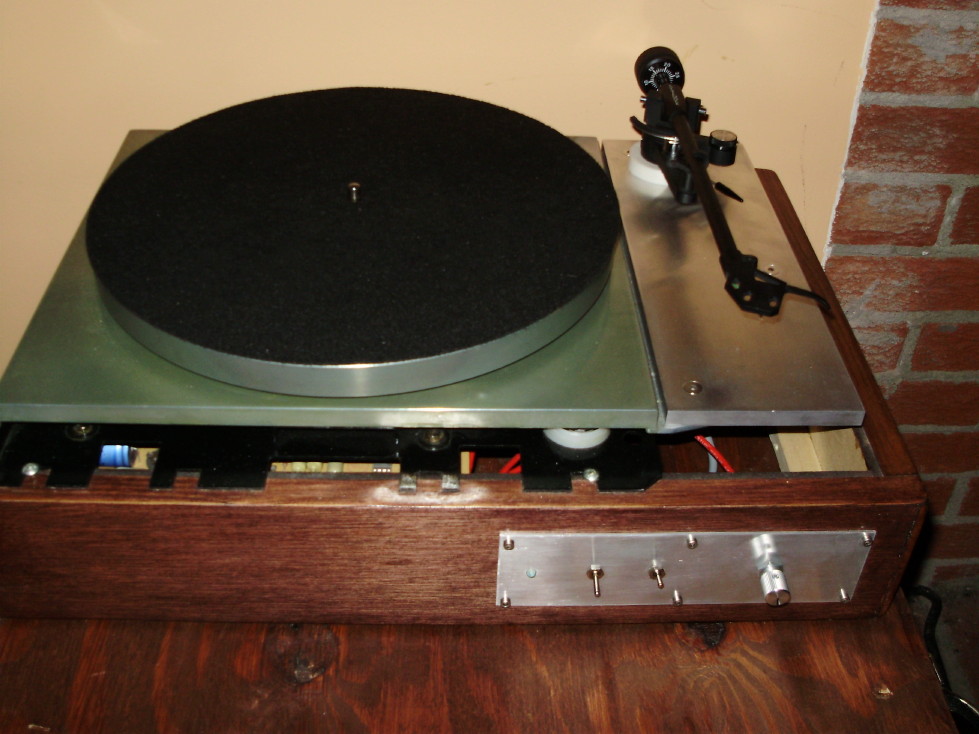

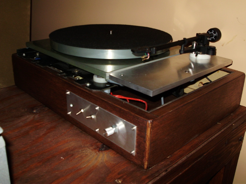

What is all h gadgetry attached to the Thorens? re-plinthed, re-boxd, built in phono stage?
is that they can be stripped of their plastic bodies and re-bodied in wood....and of course they have a well documented reputation for being "bang for the buck".
Your tpnearm was once sold as Systemdek arm,I guess one of the many Japanese versions,maybe from Jelco or other Japanese manufacturer.If I remember well it has an effective mass of around 13gr,therefeore the DL103 suggested here will be a very good match.The TD125 deserves a better tonearm though.A suggestion of SME 3009 might sound funny,but my experience of it on the TD125 even with expensive MC's suggests of a great sounding turntable.

Nanook: I bought this table of my friend and he changed the tonearm for a Systemdek as panicos K tell us but he had to machined a new plate for fit this new arm. He changed too the rca connectors and re-wired all.
