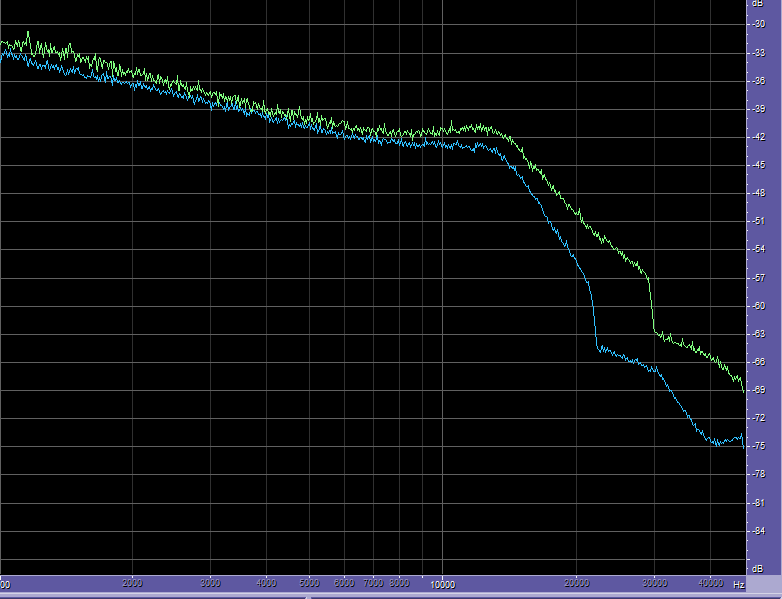

Need to find the source or date the record was made. The classic test records mostly predate digital test sources. It would have been a GR noise generator which are quite random and stable. One issue would be the compressor in the cutting chain affecting the HF part of the spectrum.
In case it was not clear the cutterheads have a 20 dB resonance between 1 and 2 KHz. Feedback is used to control that but the mechanicals are still reacting.
All I know is that my two test records don't show this.
HFS-75 was probably analog, considering the financial and technical capabilities of the magazine and record studios in the UK.
GR equipment was rare in the UK
My Elipson is much more recent and likely to be PC digital
The dubious sources would be early digital made with a too short pseudo random sequence generator. You used to see this sort of design in "circuit ideas" letters in the electronics magazines in the 70s and 80s. Few people had access to FFT in those days to detect the artifacts.
Vibration of real objects is different from electronic resonances that most people are schooled with. Rather than a simple transfer of stored energy from one form to another, energy is stored in a bending tension that propagates within the body. A closer electrical analogy is a transmission line.
Real objects bend and propagate vibration in degrees of freedom depending on their shape and support. The outcome in response to an f sweep of stimulus is a series of resonant modes that depend on the phase velocity of bending propagation within the body, compounded by impedance discontinuities. Really, mechanical impedance changes with frequency in a series of peaks and troughs, analogous to an electrical transmission line though that has only one dimension. The modes tend to be widely spaced in the f domain for simple vibration and objects.
So here it looks like something in the cutter process such as the cutter head, or lathe platter, vibrates in a relatively simple way. Then one ends up with a series of resonant peaks in the f domain corresponding to impedance troughs where the body is easy to bend.
It doesn't look electronic in origin to me, mostly because it doesn't show up on the left channel. That said, the pink noise doesn't look too ideal but it seldom does in test records for whatever reason. Maybe that is linked?

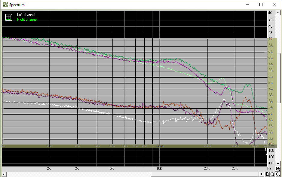

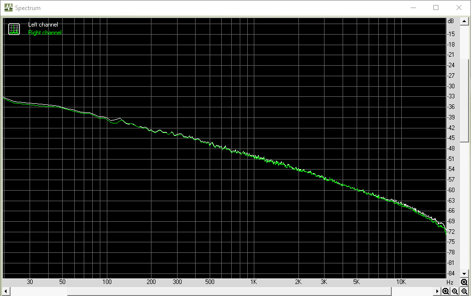

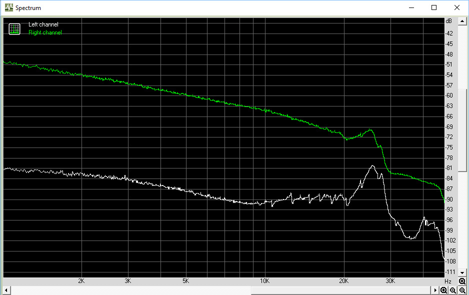

The first two Images recorded with pink noise from the same Adjust+ LP that Scott used, both 33 1/3 rpm.
First image: stereo, both channels from 20Hz - 20khz,
Second image: one channel pink noise, from 1kHz to 48kHz.
And to compare, the third image is the merger of Scott's image with mine, both brought to exactly the same scale and the same level.
The most prominent is the peak in the crosstalk signal between 20kHz and 30kHz, being exactly the same for both, white vs purple.
Since this peak shifts upwards in frequency when going to 45rpm, this is part of the record and not caused by the Cart.

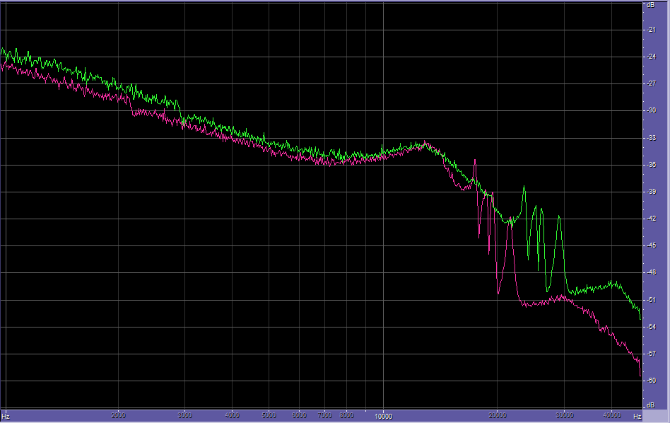

We need to be careful to include stylus geometry/groove interface issues with things that will scale with RPM. I'm assuming the 35% increase in RPM will change the tracing error a fairly minor amount? I have more disks to try including the CBS Labs ones, these certainly predate digital processing. Typical analog pink noise generators used an RC ladder filter on white noise from a broadband generator like an avalanche diode or zener, there are no mechanisms in that process that I know of to make such abrupt frequency response aberrations.

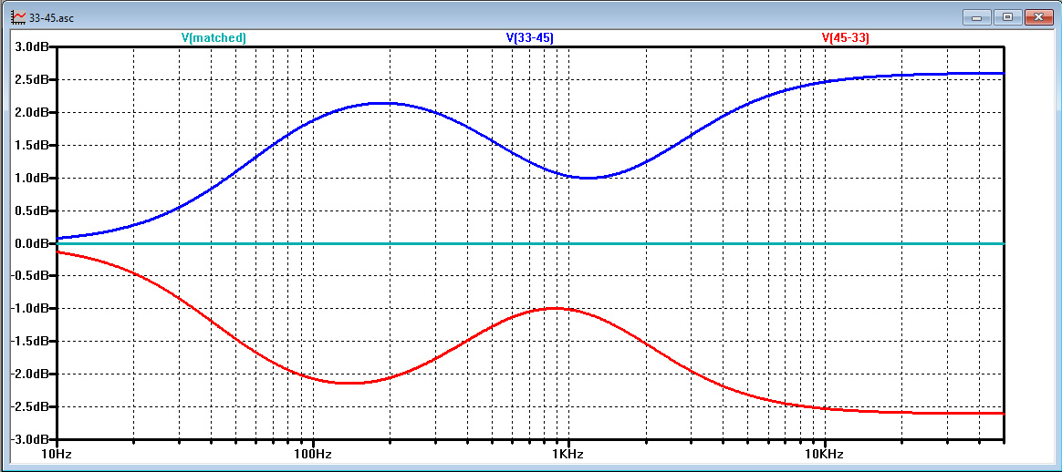

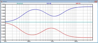

The image below shows the deviation in the FR when a 45rpm RRiaa processed LP is played at 33rpm through a Riaa preamp and vice versa 33rpm played at 45rpm.
May be good to know the effect for exact interpretation of results.
Hans

Actually designing a circuit that caused the CBS artifacts without some sort of delay line cancellation would be hard. Analog delay lines have been around a long time, but I don't see why CBS would have needed one
Another possibility is some artifact of high frequency limiting. An analog pink noise signal with RIAA preemphasis would need some serious filtering a digital one can be generated with guaranteed no energy >30KHz. The measured problems with several different LP's are quite different and to me look more like chaotic behavior than something simply running out of its linear range.
