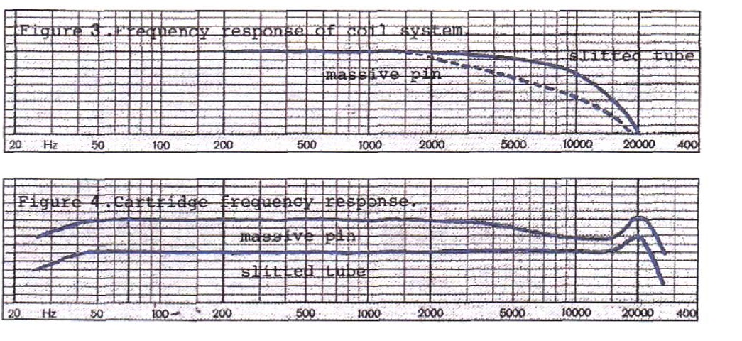

Moving on: Up for discussion is the attached snip from an ortofon brochure for the 520 series from around 40 years ago. This was the first appearance of the split pin generator that Ortofon still use to this day. The claim is eddy current reduction. There is a comparion between solid and split pins. Ortofon use B&K plotters set at 50dB scale for all their other FR measurements, so safe to assume 1dB per division. This does show the classic mid-range dip that some cartridges have. Why this is interesting is that you can still get new cartridges with both pole pin constructions in the OM and superOM ranges and the stylii are interchangeable allowing some testing to be done. And testing is needed as we immediately run into the first problem which was discussed at length in the mechanical resonance thread* here mechanical resonance in MMs, which came to a grinding halt mainly due to my inability to complete a test board. However George did build a unit and came up with some interesting data using a Shure M97.

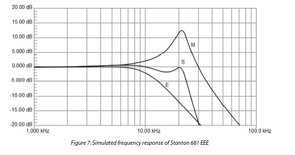

If you look at the work of Hans van Maanen and the very interesting Steven Van Raalte paper from Linear Audio volume 3 you can see that it is possible to assemble a combined electrical/mechanical resonance response that produces the response curve that ortofon show. However I immediately see something I don't like as this requires a 13dB lift from mechanical resonance at 21kHz. 3-4dB I could believe, but 13 is a lot. The 13dB figure you can see is the same between the VR paper and the ortofon graphs. If you look here mechanical resonance in MMs, there is the transmission line model LD has worked on that does show the possibility of this sort of level of enhancement. I still don't like it as that infers an exceedingly undamped setup.
So we need some measurements that try to isolate cartridge response from cantilever. mechanical resonance in MMs shows a measurement of the ortofon solid pin generator using a transimpedance circuit LD designed and build and I have a variant waiting for me to get off the internet and build. With a loading scheme that puts cartridge electrical resonance out the picture you can see that you get a flat response within a gnatfart across the audio band**. There is a rising response indicating something, possibly mechanical, but it's not anywhere near that you would expect cw vR or ortofon.
Overall I am not sure the generally accepted cartridge electrical model is correct! But I have probably missed something as usual 🙂. If we are to explore losses in the generator, we need to make sure we have a half decent generator model to start with?

Still no data, guys? Graphs with no scales? No test conditions, specific groove velocities (there had to be more than one), cartridge and load used?

Yes, I assume the rising response is due to top mechanical resonance. And the Aurak TI preamp used was as per the schematic, no fudges.billshurv;5371289[URL="http://www.diyaudio.com/forums/analogue-source/303389-mechanical-resonance-mms-post5008802.html" said:mechanical resonance in MMs[/URL] shows a measurement of the ortofon solid pin generator using a transimpedance circuit LD designed and build and I have a variant waiting for me to get off the internet and build. With a loading scheme that puts cartridge electrical resonance out the picture you can see that you get a flat response within a gnatfart across the audio band**. There is a rising response indicating something, possibly mechanical, but it's not anywhere near that you would expect cw vR or ortofon.
I agree, the accepted model isn't complete, and fixing that will probably be a good place to start.Overall I am not sure the generally accepted cartridge electrical model is correct! But I have probably missed something as usual 🙂. If we are to explore losses in the generator, we need to make sure we have a half decent generator model to start with?
No additional corrections, and level was 1.2cm/s lateral at 1kHz with some break at 10kHz, spot frequency sine tones.**LD will need to explain if he had any additional corrections in place to get this response.
