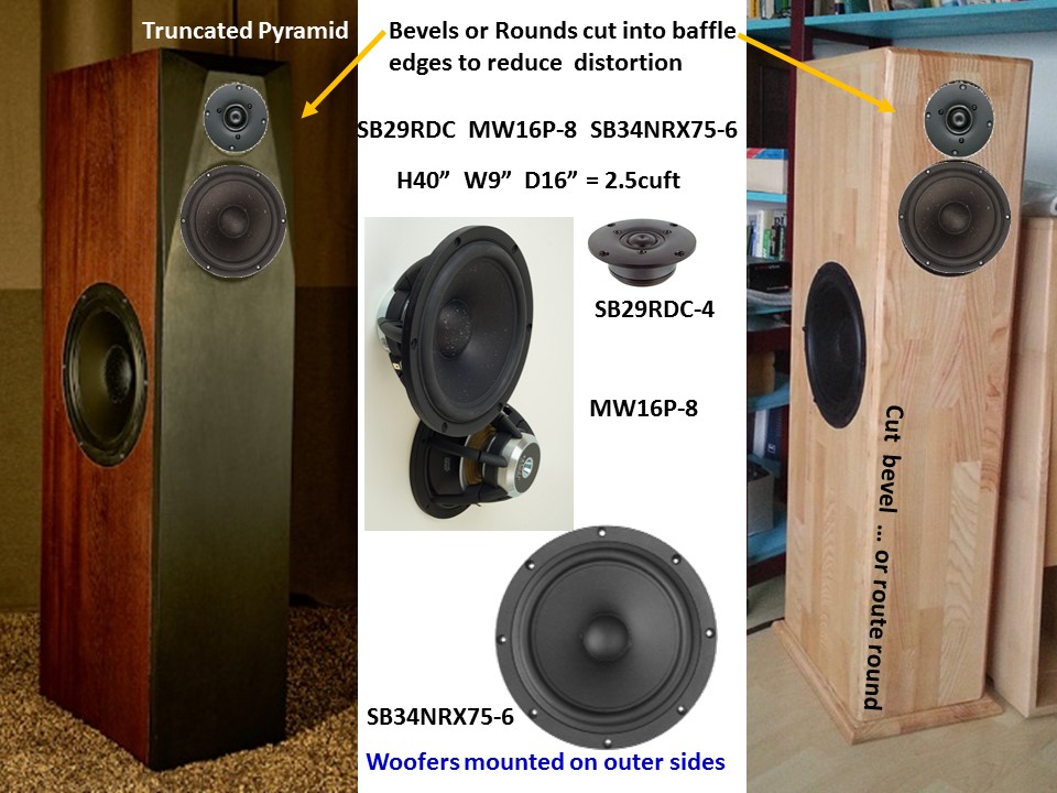

Example cabinets: Adelphos drivers plus a 12" side woofer.
Best sound from both a sealed midrange in 0.3 - 0.4 cuft volume and a sealed 12" woofer in 2 - 2.5 cuft volume.
Putting the center of the tweeter at 34" - 36" uses a 38" - 40" high cabinet with 0.75" - 1.0" edge bevels for reduced diffraction distortion.
I'm sure that these sound great, but just too big and visually overpowering for my room. I need something much shorter and smaller in order to be able to enjoy it.
I already tried some speakers that were about 14" wide and 40" tall. Too big for me regardless of the sound quality. I imagine that some people are not as concerned about the visual aspect as I am. But it's very important to me.

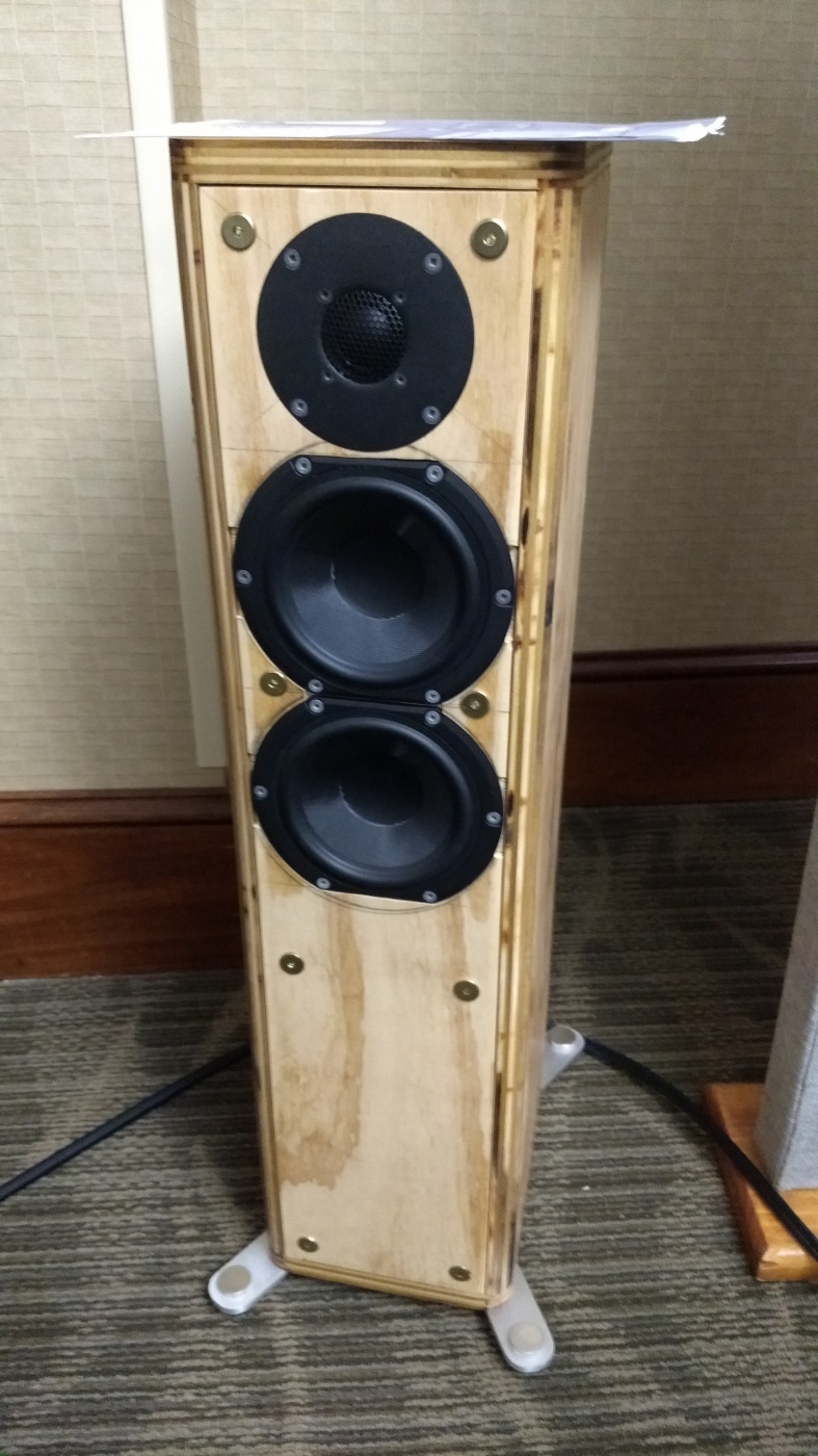

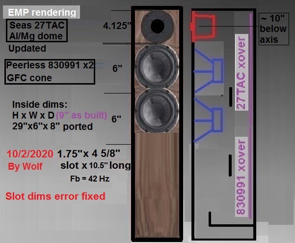

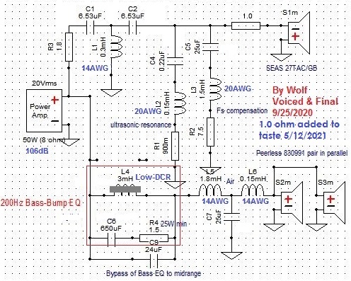

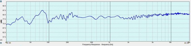

My recently completed EMP fits that bill. I wanted to make a smaller tower with really clean HD for the cost, and capable of packing a whallop in terms of sound. They are really dynamic, and orchestral stuff sounds great on them.
Kit? Not really. You'd need to source your own parts, but free for non-commercial use.

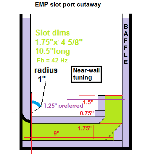

Ports would be 2x 1.6" diameter, tuned to 40-42 Hz range. The 650uF cap is not a typo. The method I used were computer-grade 1000uF polarized back to back, followed by 200uF of poly, came out measured to 648uF.

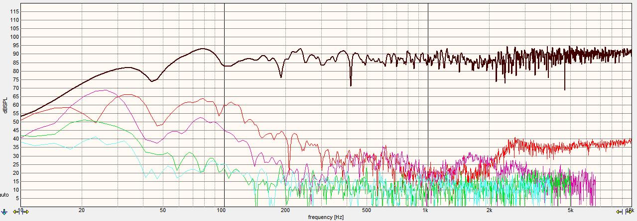

The FR/HD were taken before I added the 1 ohm resistor to the tweeter, so that is not shown in measurements.

3-way. SB29RDC... MW16P-8... SB29NRX75-6(on side)
H=38" W=10" D=14"
The 10" SB29NRX75-6 woofer produces -F3 = 43Hz in a 1.3cuft sealed volume, and would be a better size for your small room. Same philosophy... sealed midrange and sealed woofer... just a better cabinet size for your room. Beveled edges on 1.5" thick(2-ply) front baffle will reduce distortion.
H=38" W=10" D=14"

Shorter 3-way. SB29RDC MW16P-8 SB29NRX75-6
H=34"... to match room furniture
W=10"..including edge bevels...
D=15"..including 1.5" double thick front baffle
three braces...two sealed volumes
Thanks, LineSource. This looks like a great idea and is similar to what I've been thinking about. I'd keep the height down to the minimum. No more than 38". Maybe even a little less.
First step though is to build the Adelphos as stand mounts just as they are currently designed. That's all I want to tackle at the moment. Then later either rebuild them into cabinets like this or simply just add a bass cabinet underneath.
