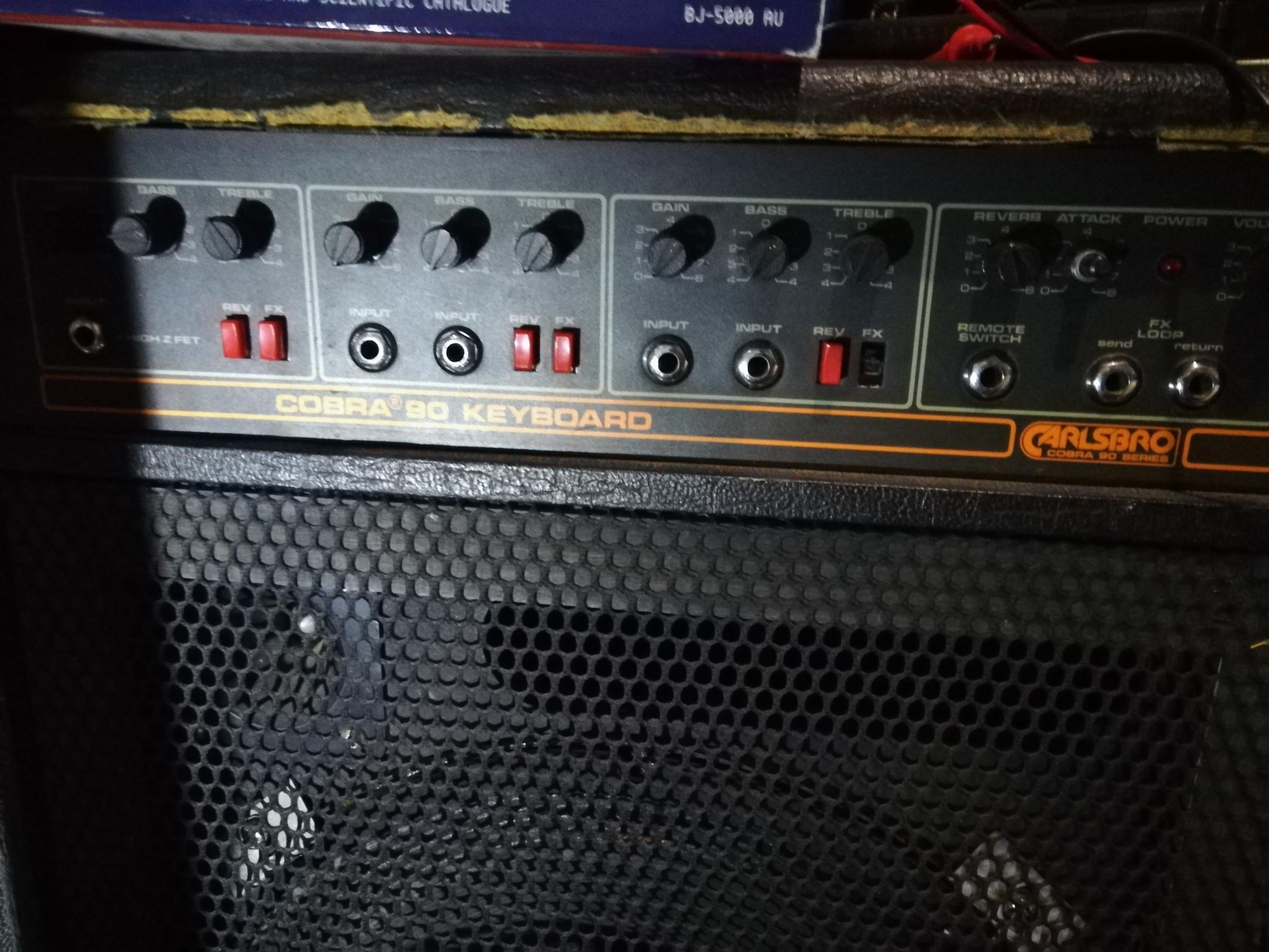

i'm Just sad that my amp which i long cherished has stopped working.
i have changed 2 fresh 2N3055 and 2 big caps, now just want to know the rating of R16,R17,R18 AND R19 as they look like wirewound ones and also where to get these parts.
please help..Thank you

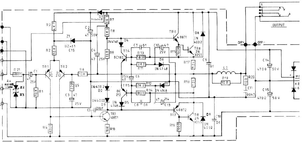

R15 100R carbon 1/2W
R16 100R carbon 1/2 W
R17 0R24 or 0R22 wire wound 2W5
R18 0R24 or 0R22 wire wound 2W5
R19 10R 2W carbon
Why did you change the 2N3055s?
R19 fails if the amplifier is over driven into distortion.

Can you please post the schematic?

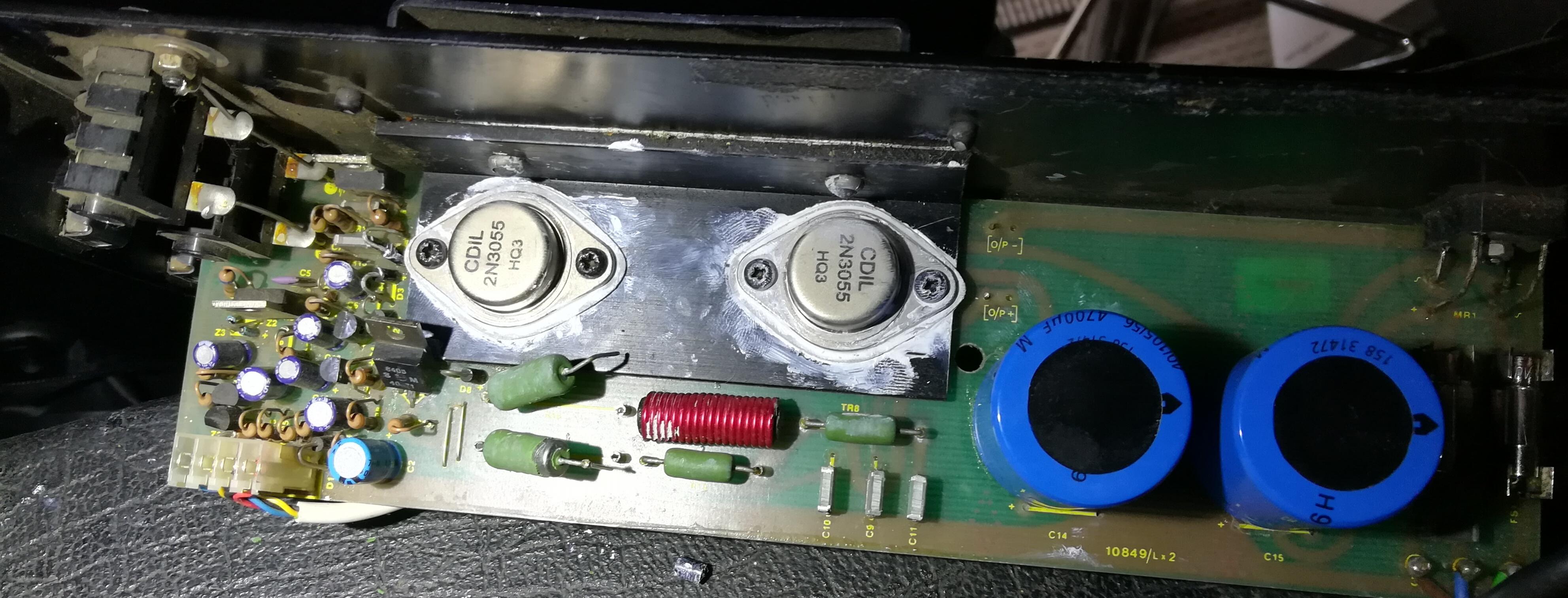

Thanx for your reply,
i changed the 2N3055 cause the fuse was constantly blowing off when turned ON.
After changing those 2 transistors and the 2 4700uf caps, the fuse doesn't blow at all but No sound at all. R17,18 and 19 looks suspicious to me as they looked burnt on the outside.
Someone posted the schematic days ago and it helped me to locate those resistances.
Kindly let me know what you what can be the issue?

i changed the 2N3055s cause the fuse was constantly blowing off when turned ON,and since i did that together with the 2 Caps 4700uf, no more issues with the fuse except that no sound is coming out of the speaker.
speaker checked.
what do you think can be the cause?
Thank you for helping
