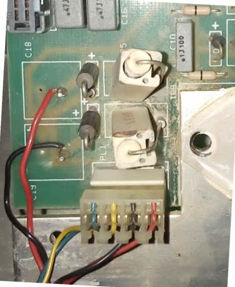

I'm trying to fix this Carlsbro amp, with no success. When I power it up, this resistor (the darker one) starts heating until it starts smoking.. :S
Already replaced the 2N3055, and some transistors.. but still isnt working.
By the way any idea what are these "1C04 9250" and "1C03 9311" ? cant find any info in it..
Also if anyone could share this schematic would be great!

oopps, forgot to attach the pic... Here it goes:
By the way, one thing i've just tried: by removing the two diodes, it stops heating..
they are 2 1n5365 Diodes.. (36V 5W zener).
Maybe they are shorted?!
I would imagine that those two diodes along with the two resistors acting as current limit resistors (the ones burning) form some kind of pre-regulator circuit to lower the main amplifier rail voltage for whatever other stages need to be powered (eg. pre-amp-although 36V is a bit high for an opamp pre-amp, possibly even the input stages of the power amplifier). You say that the resistor is heating with the diodes in, so that points out that one of the diodes is possibly shorted or something further down the line (what the regulator is powering) is shorted.
I think the first priority would be to replace both the zener diodes-it does no harm and see if that makes any difference. Also, once everything else is fixed, you WILL need to re-adjust the output transistor bias now that you have replaced the 2N3055's.
Well good news for now.
I've replaced the zener's and the amp is almost working good. They are feeding a 7918 and 7818, and these regulators were the ones who shorted the whole thing...

You obviously still have a problem with the preamp board so it is probably a good idea to get that sorted before the transistor bias because it will more than likely be a bit more difficult to solve.
For the preamp board, first of all, do a close visual inspection to see whether there are any visibly burn components or traces on the copper side of the PCB and also check to see if there are any dry or poorly soldered joints. It is worth touching up suspect looking joints as even if they look fine externally, they may be flawed underneath. If any components such as resistors look burnt or the area on the board around them is charred or discoloured, lift one leg of the resistor and check to see if the reading matches the indicated value. Again, if any are suspect, replace them with a suitable alternative (1% or 5% tolerance, carbon or metal film and a suitable wattage-usually determined by the size of the resistor).
Regarding the modifications done by the previous user, if these are extensive (i.e. more than JUST a few wires), they were more then likely done by a previous owner whereas if the number of wires is limited and the job is done relatively neatly, then it may actually be a factory modification. With older amps, they were still handmade and were often put into production with faults. It was only later that these faults were found and instead of say, throwing away a stock of PCB´s, manufacturers would just modify the previously faulty board design in house.
Finally, as for the bias of the output devices, it certainly is possible to do this without an oscilloscope. You will need to find the two emitter resistors (similar in size/shape/colour/wattage) to the ones you have provided photos of. These will also be of a much lower resistance to the voltage regulator dropper resistors (in the range of around 0.2 to 0.5 ohm). You will also need to find the bias adjust resistor (small screw-adjust preset type), which should also be on the main amp board. To calculate the bias current, you will need to measure the voltage across one of the emitter resistors, whilst the amplifier is on at both leads of the resistor and do a bit of calculation involving ohm´s law.

1C04 and 1C03 were RCA transistor type numbers. The 9250 is a date code meaning the part was made in the 50th week of 1992. I'll let you figure out 9311 then.
You probably will find it easier to look up if you refer to them as "RCA1C03"
The two types are TO220 package, as seen in the photo. 1C03 is NPN and 1C04 is PNP. They are rated 4 amp, 100 volt, 40 watt.

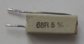

im trying to repair one of theose glx 80 any one know the values of the 2 ceramic resisters r 25 and r26 in front of the diodes as mine are roasted any idea what causes this overheating problem thanks
R25 and R26 are 68r 5% (5W?) ceramic. Mine are damaged too (but not burnt). I think those are current limiters for the mains supply to the preamp boards.

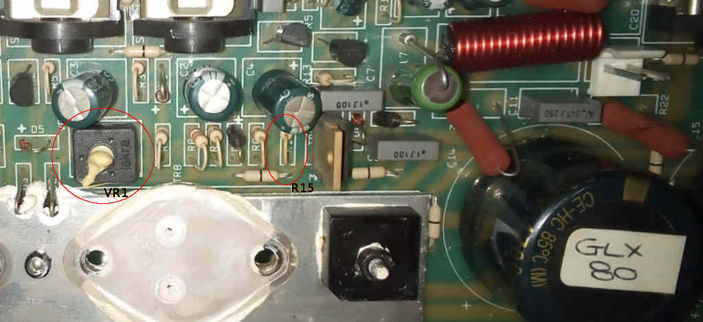

In my Carlsbro GLX80, R15 and VR1 are burnt. Do you know their values?
