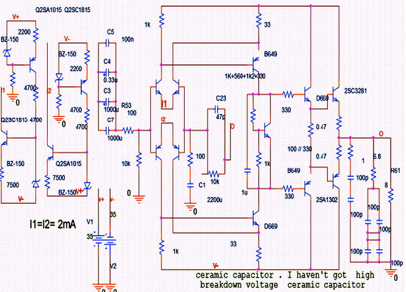

My amp still has a problem which need to be solve . If volume is set at high level and then I turn on the pre-amp , DC protection circuit will operate .
Perhaps overload-protection-circuit operated after I had turned on pre-amp .Then offset voltage got high and enough to activate DC-protection-circuit .
I had to buy new power transistors for many times before .

Thank you very much Thanh, very king to show me your schematic, and those problems with switch on or even switch of, can be solved with big caps to delay the voltage rise into the differential emitters.... resistor and electrolitic may delay enougth.
Maybe if you create some loss in Vas voltage, installing some rail resistors followed by condensers may help.
Did you not apreciate the charge suckout condenser in parallel with your 100 to 330 ohms (tone adjustment and output bias adjustment float resistor)... sometimes it help a lot... try 100N or 220N there...just as a research.
Very good schematic, fully simetrical, remember Leach amplifier, but better in my idea.
As you are using a simulator Thanh, inform us some technical specifications, despite this is not the guarantee of good sonics, have some interesting informs to many data guys.
To me, please, tell me how is the sound.
Oh ! i can't understand .! I don't uses differential emitter resistor .
I actually don't understand because my dictionary can't work .
Adding a capacitor in parallel with 100//330ohms can't solve the problem .

Its sound soft . I think that all stage can be improved more so i improved current source . The output impedence of current source will determine CMRR
i think
clean = low noise
low noise = low noise transistors , caps , resistors and CMRR

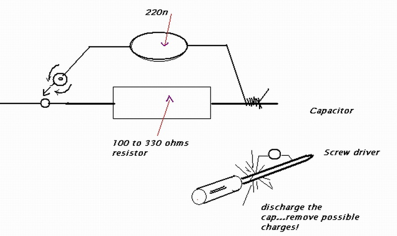

My suggestion thanh, is to hold one 220N capacitor between your fingers, and play
Music very loud, having metal instruments playing.
Now discharge the 220N capacitor, producing a short circuit with its leads over some metal.
Now, playing music, with your fingers holding the capacitor, touch the 100 to 330 ohms resistor extremes...tell me if you could perceive some difference.
Try to observe the effects in voices and bass too.
Good luck!
regards,
Carlos

Oh ! thanks Carlos !
I will try to do your comments !
Big problem is that my amp is easy to overload and that capacitor can't solve this problem .
