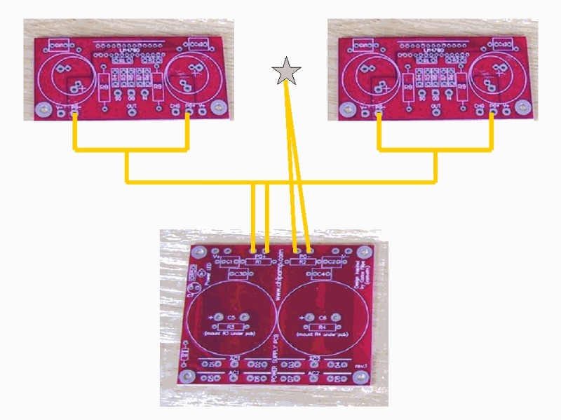

Carlos grounding Scheme
In an earlier post by Carlos he showed some pictures of a grounding scheme he was using with some BrianGT boards. However I can't seem to find it even though I searched for it. Aslo I'm not sure I completely understood it. Is the attached picture an accurate depiction of waht Carlos was suggesting?

I guess this is a question for Carlos -- what is the wire you use for the ground wires. I see that it is thick copper, but is it just stripped solid core wire, or is there some other source for it?
On the chip boards you can fit 1.5mm solid core copper.
Get those boards close from each other.
Then use a thick solid core wire (1.5~2.5mm) to join the two boards.
Coming from the PSU to the center of that wire I use multi-strand 2.5mm copper.
This is all normal electrical wire, no need to get fancy.:tilt:

Another way, which I think is more elegant, is to connect two amp boards OG (output ground) points with a thick wire. Then run both ground returns separately (from a single rectifiers board) to a central point on that wire.
It produces hum free results.
As to the boards designed the way they are, they were optimized for dual mono setup, and they work fine this way.

Upupa Epops said:
Carlos, if you will lead both ground wires separate to the middle between elyts, it will be quite the same silent, but there will be not crosstalk. Do you understand, where is problem of your solution ?
That way it will be silent, yes, IF the PSU is right between the two channels and those wires are very short.
There are several ways to do the same thing.
Placing the chassis ground right between the two channels and connecting everything there would also do.
What I describe for grounding gives you more freedom to where you place the PSU.
This way it can even be external and you still have a silent amp.

Carlos, I mean, that you don't understand me. Correct ground plan haven't common ground wire between both two channels and PS. Correct grounding have two separate ground wires from PA to PS, which both must be connected to the geometrical middle between both elyts. Only in this case you have not ( theoretically ) crosstalk.

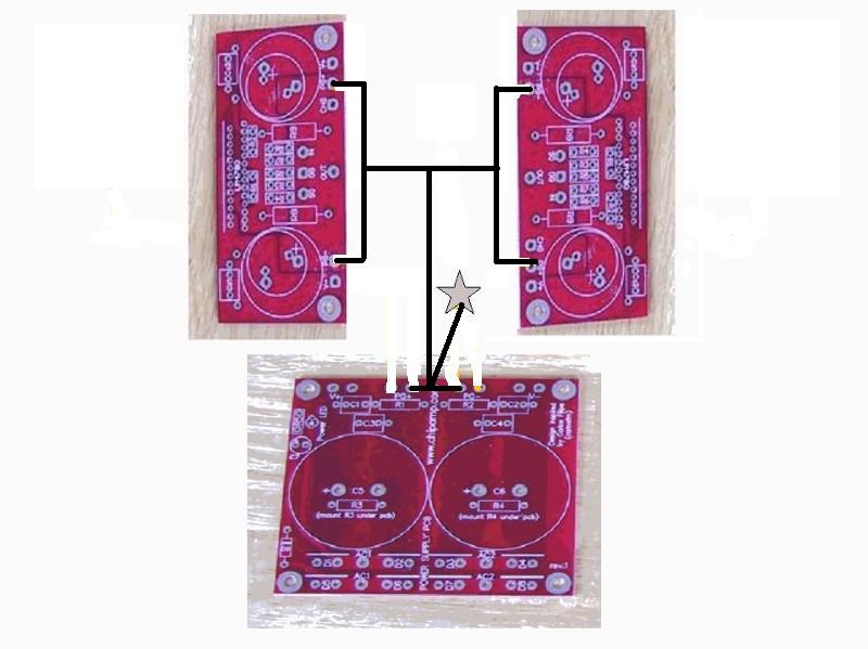

I do mine slightly different. It is hum free for me see the two green wires I made sure they are as close to exactly length as possible. The location of the angar point does not matter, but if the length are not the same may have noise. The red wire is the Earth. Sorry I have no chassis for it to ground yet.
Theoretically, but not in practice.
Yes, I understand you.
Well, how do you make that for an external PSU?
You would have two separate long wires to the main PSU caps?
Hum for sure.
I repeat: you can do that with an on-board PSU, placed as close as possible to the amp modules. Preferably in the middle of them.
There are advantages in having off-board PSU, as there are advantages in having everything integrated.
I prefer off-board, most of the times that's what I do.
