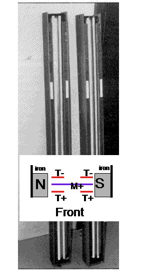

The Scintilla ribbon is 54" tall. I attached a picture plus a top down diagram of the ribbons. There is nothing between the midrange ribbon and the tweeter ribbons to block reflections. The tweeter Al foil wraps over the top of the pole piece to create the reverse current direction between the front and rear tweeter ribbons. All the tweeter foil is connected in series to sum to a 1 ohm resistance. The midrange ribbon is 0.2 ohms and uses a 0.8 ohm series resistance to pad it up to 1 ohm.
I traded my Scintillas for the Full Range because I thought I heard modulation distortion on the tweeters, so I'm curious how the "new Apogee" company's M+T ribbon will be designed. Hoped the diyAudio minds might have some ideas.
The Apogee Scintilla reviews from 1985-1988 are very good. I'm curious to see what today's measurement techniques produce.

Yeah, I'll give odds they did that at the time in order to get the impedance up from 1/2 ohm!! :rolleyes:
I'd agree with your assesment of the likelyhood of IM from that arrangement no matter what anyone does between the two bits of foil!

If it really works, a clever approach to cardiod and, with a 1st order xo, the front tweeters may not "fight" with the mid as much as we might think...but I don't understand what they are doing about combing.
Perhaps one piece of the puzzle: A truly uniform 2" gap is probably not commercially viable so the outside edges of the 1/2" ribbons are likely moving more than the edges nearest the center of the gap...in other words the 1/2" ribbons may be twisting. The twisting action may throw a different radiation pattern than we normally think of...the launch may not be perpendicular to the baffle.
