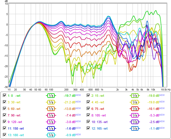

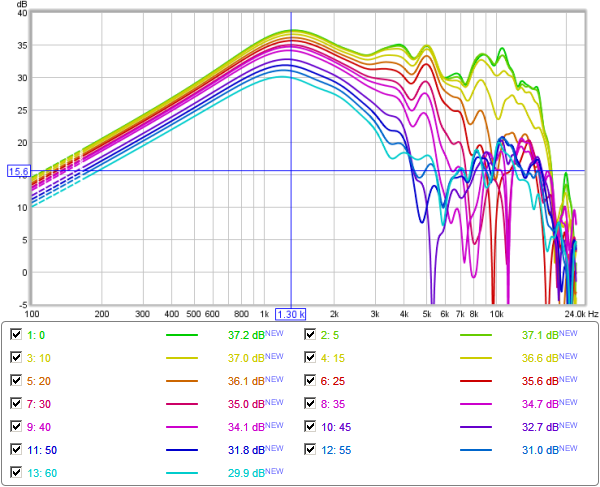

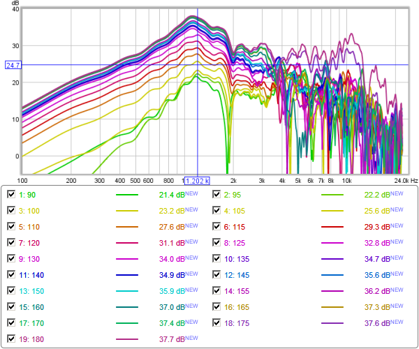

The Vifa driver was measured extensively to get a good grasp of its performance characteristics. A series of measurements from front and back at 27”suggest an acoustic source that starts at neck of driver cone. The driver was rotated in vertical plane through the cone’s neck at 5° intervals. Dual channel sweeps where used with one for loop back timing reference and the other for response measurement. The use of timing reference and use of measuring tape combined together helped in keeping highly fixed measurement distance. Front of driver on axis is 0°. Backside measurements were made from 90-180 degrees and front side measurements from 0-60 degrees(Yes, 75° is missing). Overlays of results indicate highly dipole radiation pattern to 2kHz. Measurements remain well organized to 4kHz. Above 4kHz cone geometry takes over.
The 0° and 15° degree shows some plausible potential use of the driver full range to 14-15kHz
Overlays 0-60 degrees:
Overlays 90-180 degrees:

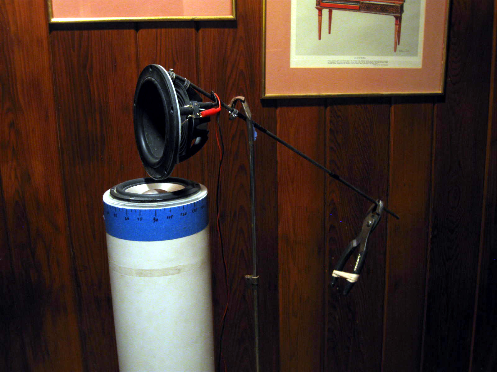

A choice was made to first explore driver alignment with Vifa rim centered above SEAS dust cap. This puts Vifa acoustic center about 1” behind SEAS acoustic center. 1” represents ½ to ¼ wavelengths about an order of magnitude shorter than 2kHz upper range of driver overlap. Driver effective diameters at 1-2kHz and apparent acoustic centers in this range are likely larger factor in polar pattern formed by superposition of each driver’s polar pattern.
Vifa driver connected as microphone with 220Hz signal to SEAS was used in finding driver position minimizing driver interaction. Vifa rim above center of SEAS dust cap produced best null, indicating equal energy delivery to front and back of Vifa from SEAS. Vifa rim is 1” above SEAS driver’s dust cap.

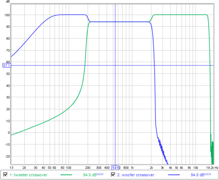

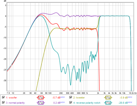

Woofer filter is band pass filtered to 50Hz-2kHz, tweeter is filtered 200Hz-15kHz. Results sum over 200Hz-2kHz range. Secondary filter is used to shelve each driver’s response down 6.02dB across 200Hz-2kHz overlap region. Applying Kirkeby inverse transform to sum of 200Hz high pass filter with 2kHz low pass filter generates the secondary filter. Result is flat sum with monopole behavior 50Hz-200Hz, cardioid behavior 200Hz-2kH, and dipole behavior above 2kHz that is shaped by cone geometry.
Raw Crossover:
DSP:

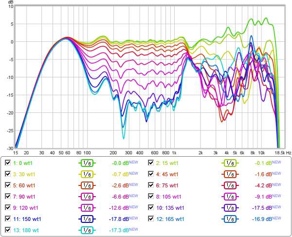

Using Room EQ Wizard software, frequency response overlay views of 13 measurements 0-180 degrees for normal woofer polarity and for reverse woofer polarity is set up. Flat response region for 0 degree normal woofer polarity measurement across 300Hz-800Hz is offset to 0dB and all other results shifted by same offset. The same plot colors are used for corresponding rotation angles for both overlay views:

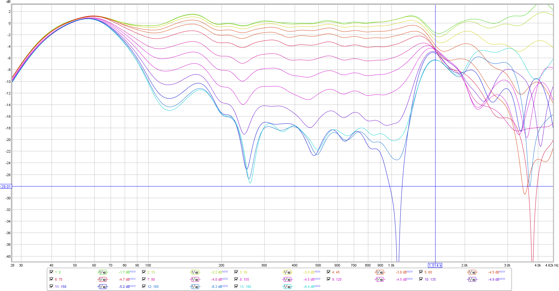

With woofer polarity reversed:
Monopole behavior is seen centered at about 55Hz.
Strong cardioid behavior is seen 200Hz-1kHz, indicative both of good monopole driver behavior and of good dipole behavior.
Measurements with microphone at reference point:
Raw Crossover:
DSP:

A 1/4" steel rod was fitted to one of Vifa driver basket arms with small hose clamps and a counter balance. A small hose clamp at pivot point was used with hook formed by clamp's excess tail catch top tube of folding music stand:

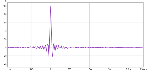

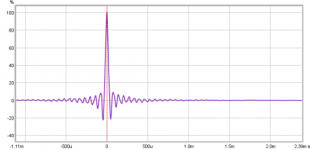

Impulse response:
Frequency response and phase:

Impulse response:

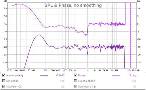

Convolution is used in JRiver Media player to apply correction filters to source file, so music and test signals are treated the same.
This is the measured GD using 110ms Blackman-Harris 7 term window.
