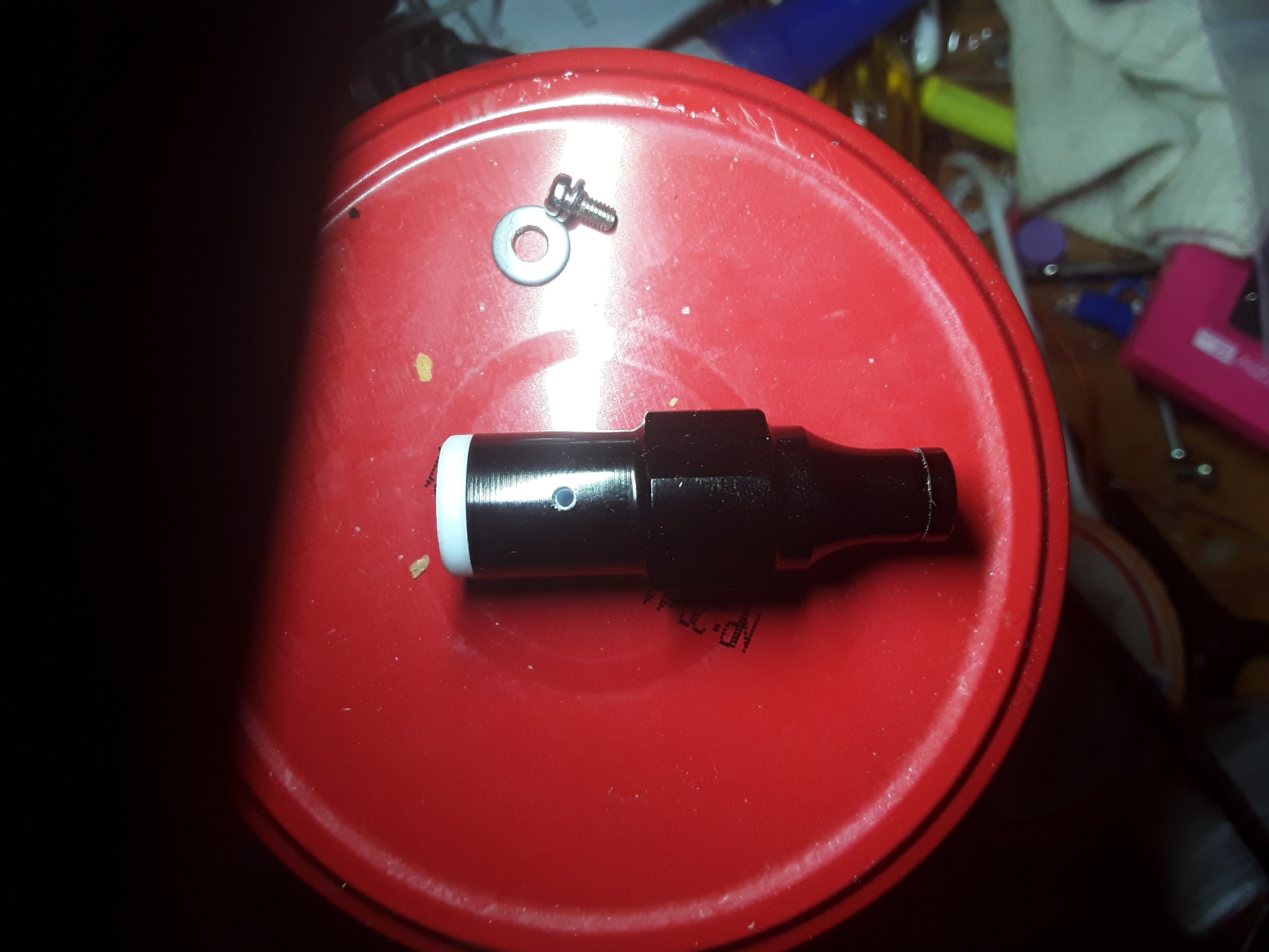

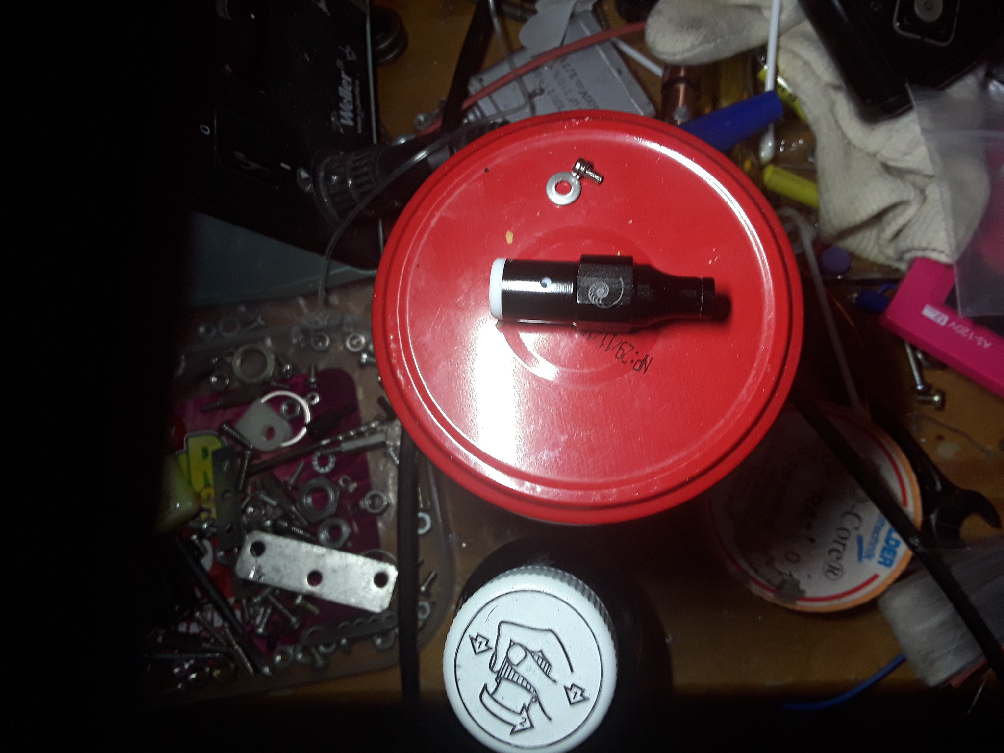

Last week i got a Cardas 5 pin din phono plug from a well known audio parts seller. Not the economy model but the expensive one.
See the photo in the attachment. Could this be a Chinese copy? Will send a photo to the Cardas company too.

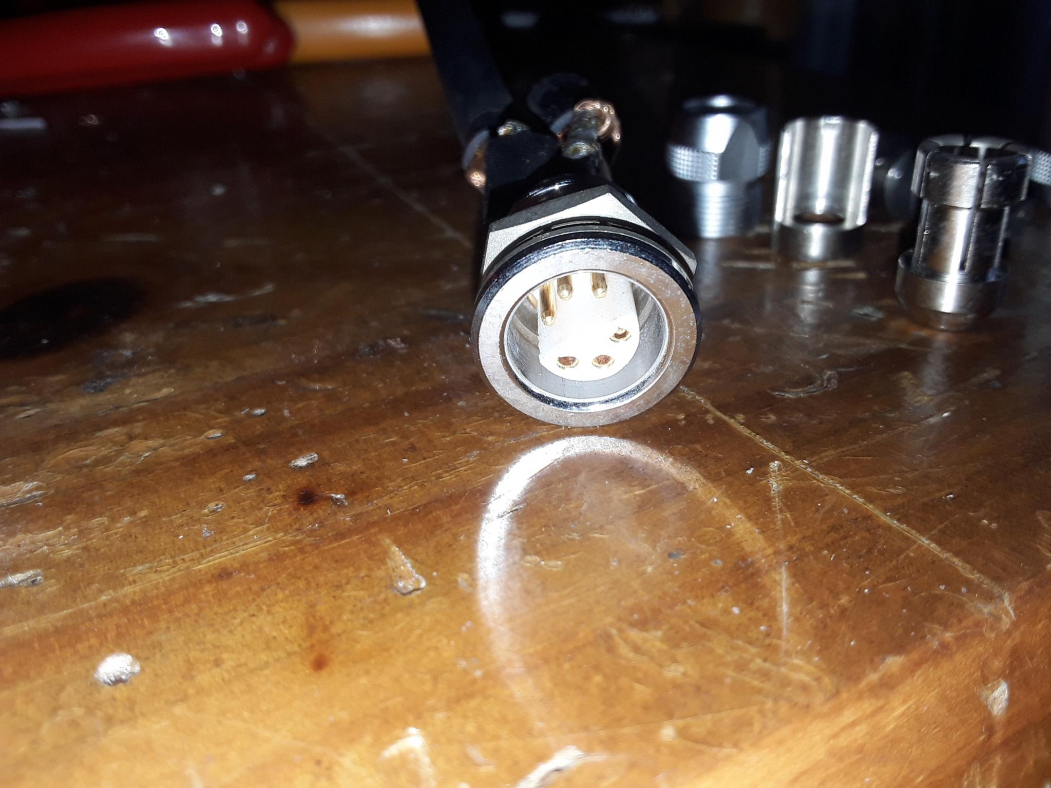

P,s the other photo is a 6 pin Lemo connector which is cheaper than the Cardas but cannot be used unless you have a fully diy tone arm

So also send a mail to Parts Connexion for some clarification. With the 25 % corona discount it is still 58$ and before arriving at my doorstep there are additional costs as well. Greetings, Eduard

At work i use tools like a caliper every day and this article would be rejected in my company. The hole in the aluminium housing is bigger than it should be, that is ok. But the threaded hole in the ptfe should be in the center of the hole in the aluminium.
The threading in the ptfe will be easily damaged because it looks like something that doesnt fit. The aluminium will prevent the bolt to be entered like it should.

It can be called cosmetic because it saw it before even trying to fit the screw. It is 1/4 inch * 72 screw in a soft material so the thread will not survive if the screw cannot enter smoothly.
It is all about functionality which should be at a higher level considering the price.
But we will wait for Cardas to answer my email. But it looks like tolerances during manufacturing are a bit at random.

The hole is slightly offset so that the act of tightening the screw pulls the plastic insert snug against the metal body, so it doesnt rattle.
I suggest if you want a better solution, engineered to broadcast standards that you use Lemo sockets.

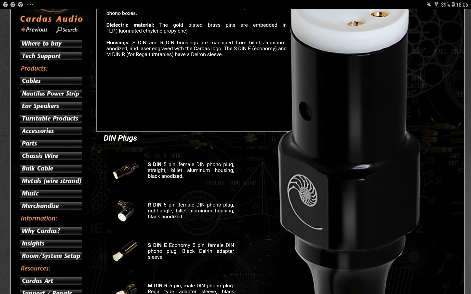

In the attachment you see a photo of the engraved logo from the cardas website.

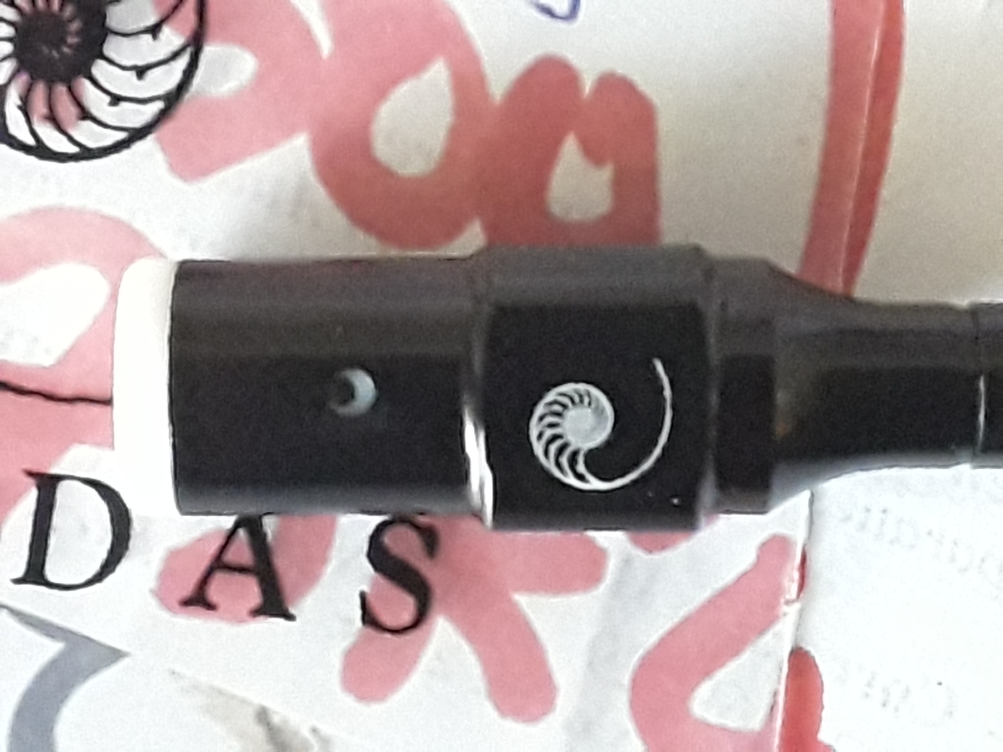

The engraving on my plug.

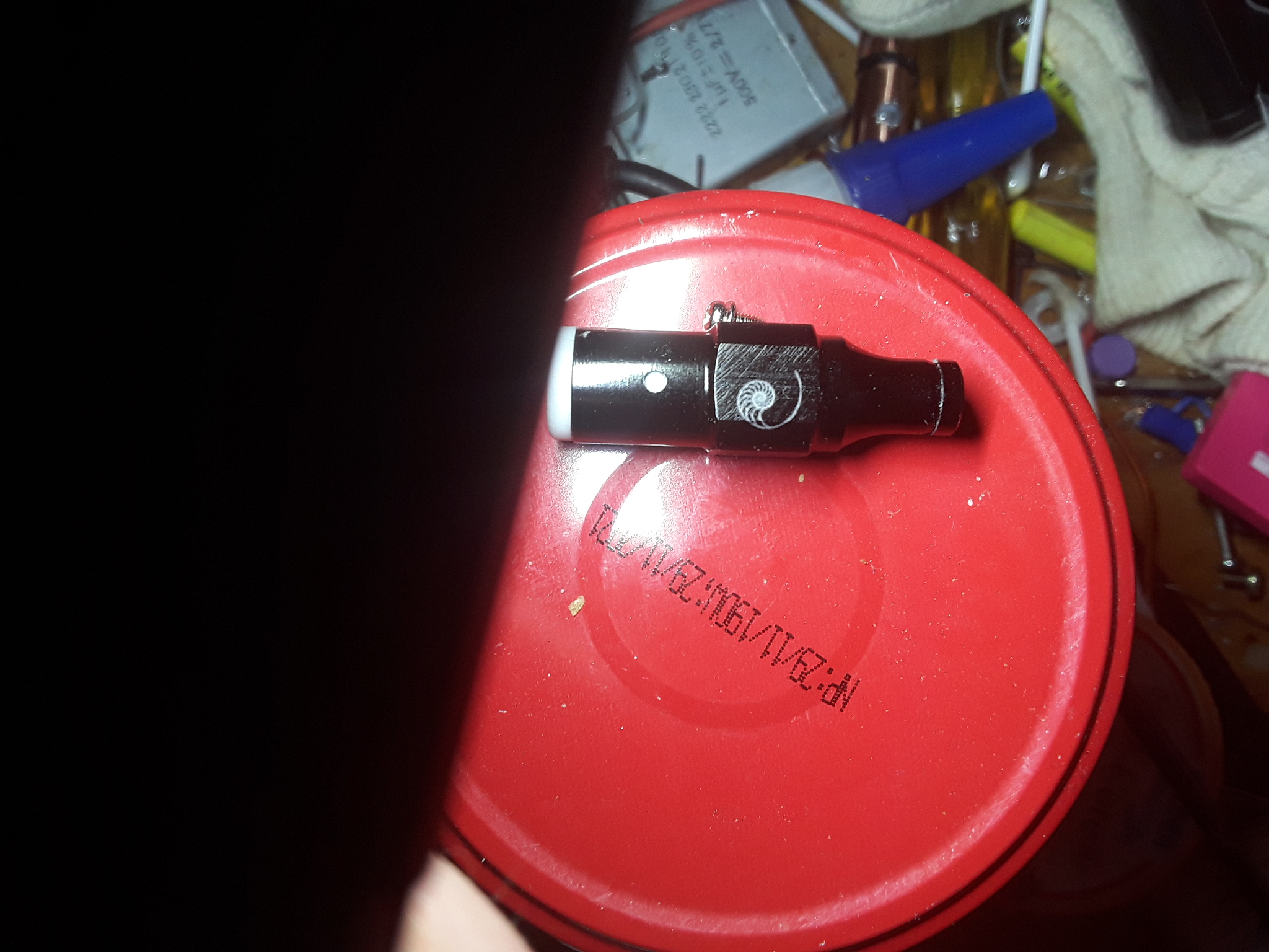

The original hole.
The one i made with a hand held Makita.
The original hole.

Good of them to offer a full refund , if that last photo showing no manufacturers emblem is the one sent to you then its logical its a copy and not OEM.
If that is the case you had every right to persevere with this.
