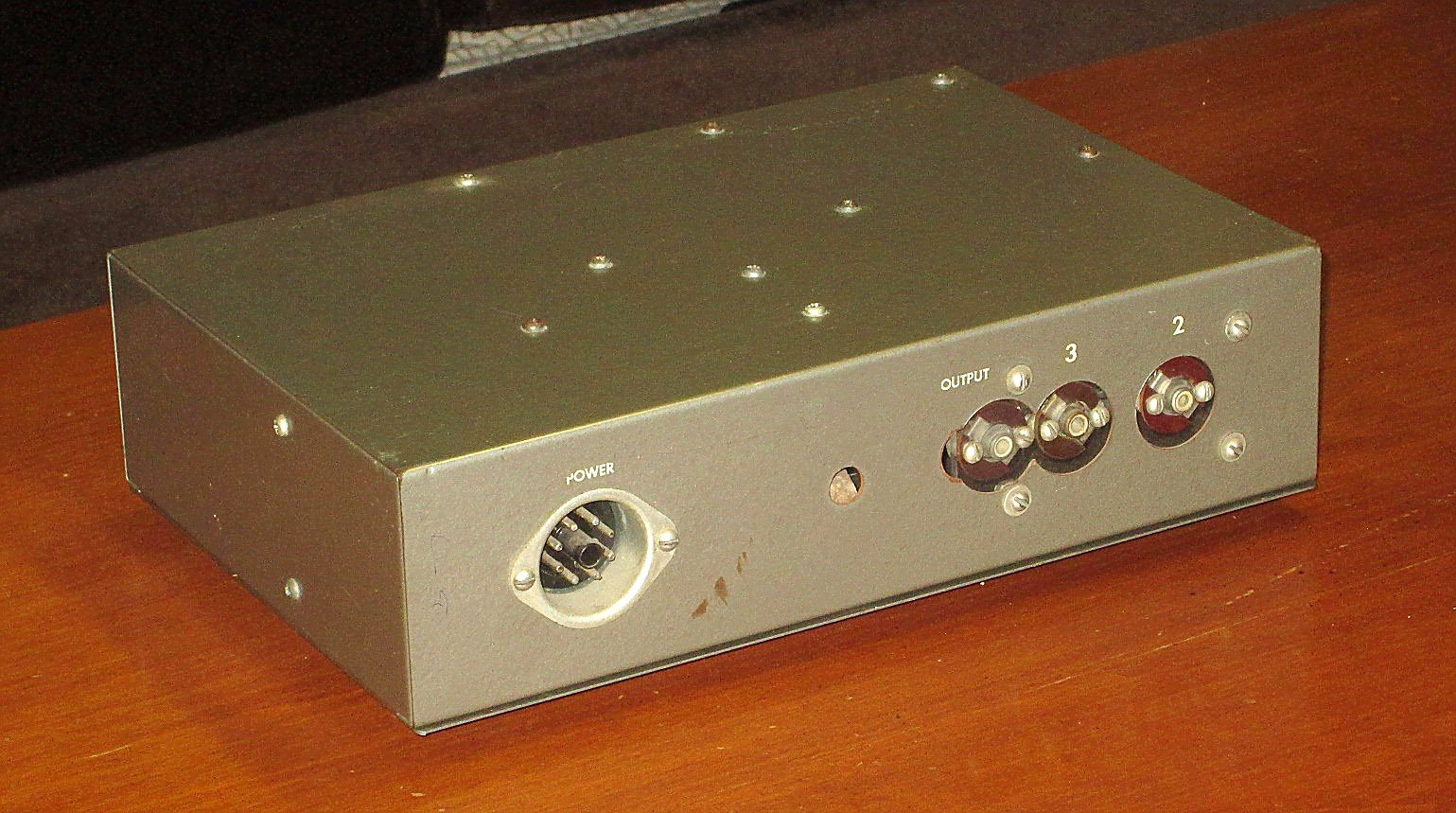

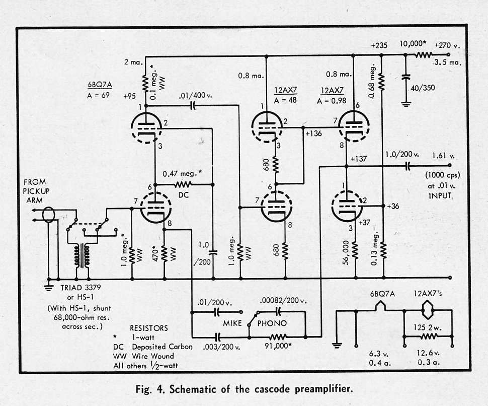

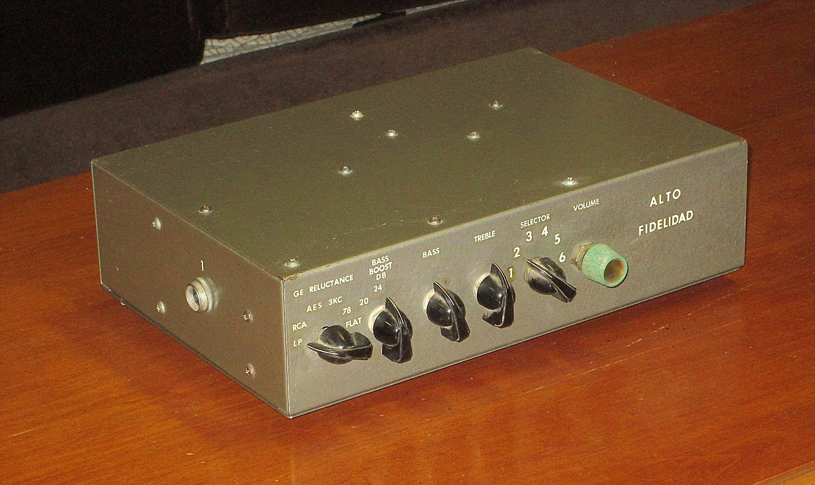

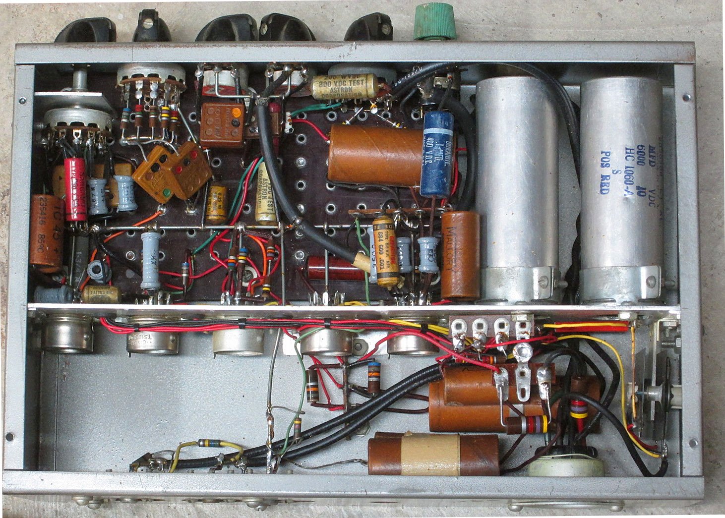

I'm often a contrarian here on DIYAudio, I find many posts long on opinion but short on facts.
For example, the CC R;s are noisey, In 1957 I built this preamp for a General Electric Variable Reluctance Phono
pickup, mV's of signal. Its still here on the shelf but not run for years, Need another for stereo.
While in use it was very quiet.
Next amp your build that needs only a 2 Volt signal has a problem, it may be the
century olde tube making the noise in the cct.
