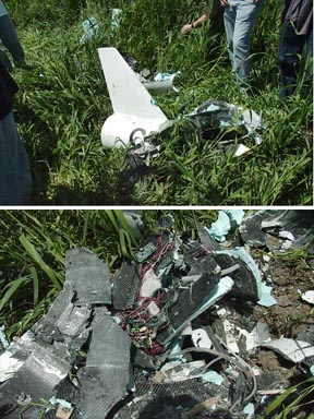

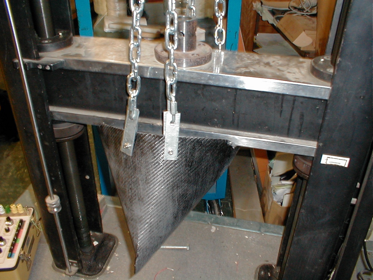

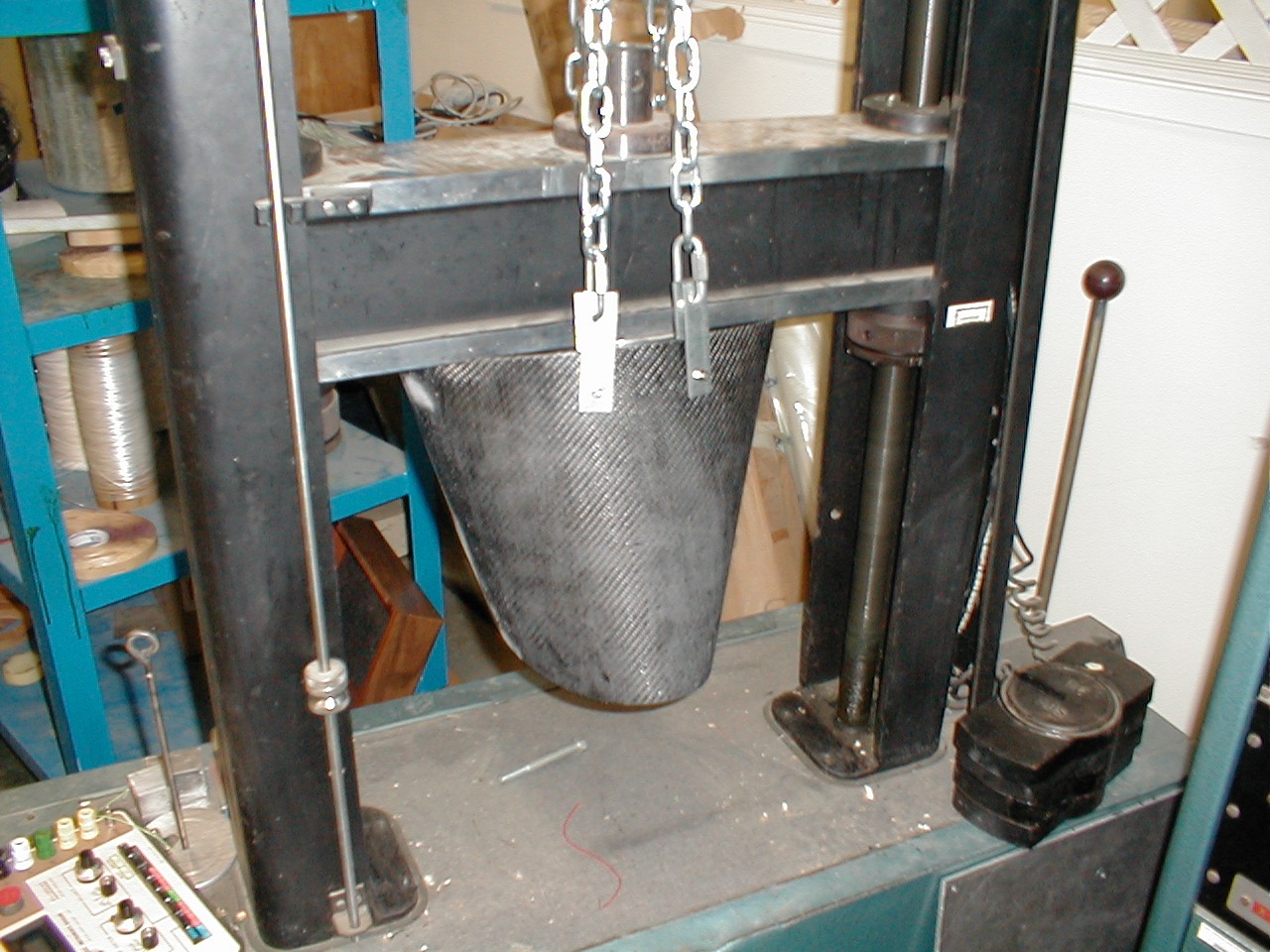

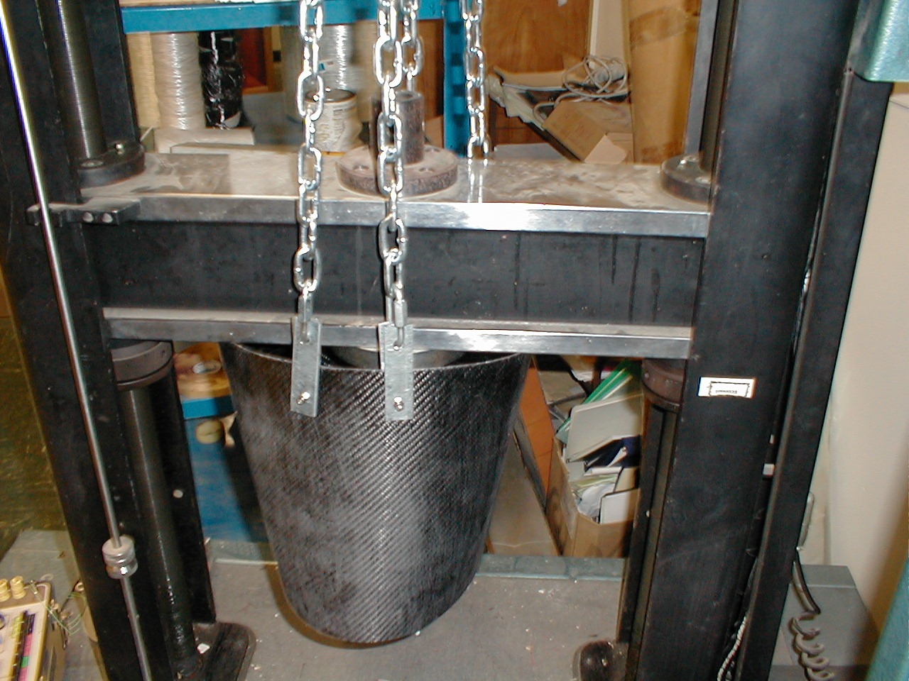

I used to build large composite high power rockets when I was a lad in school...in the way way back...the long long ago. We made a lot of composite, lightweight rocket tubes. It's messy, hard work, and perfect for students eager to learn. Free labor and industry funding helped. Tossed in some photos just for fun. Instron test shows a 12 inch CF tube under 500lb, 1000lb, and 1500lb loads with no internal support to protect from collapsing. Can you spot the young birdbox getting ready to pilot the yellow flyback "Starbooster"? Fun times, back when I had hair

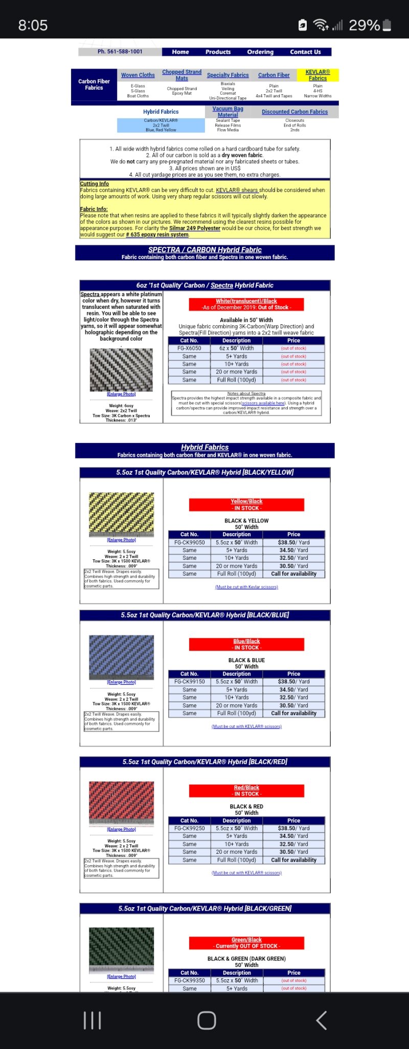

Very strong tent poles [ and main masts for sailing boats] often use matrix fabrics blended from 2 or 3 types of fibre, glass, Nomex and carbon
Like this
https://www.rockwestcomposites.com/13050-group
