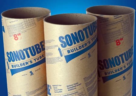

Sonotube is cardboard. It would be a cheaper alternative to carbon fiber. You can finish the outside to your tastes, or at least build an affordable proof of concept. A four foot length of the 0.100" carbon fiber tube referenced about weighs 8.5lbs. The shipping weight of four feet of sonotube is just under 3lbs.
