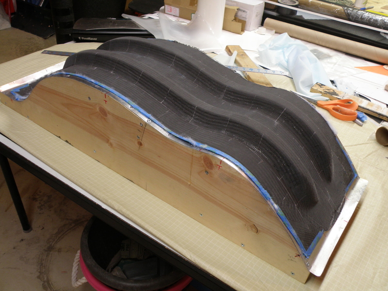

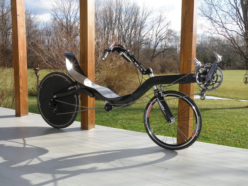

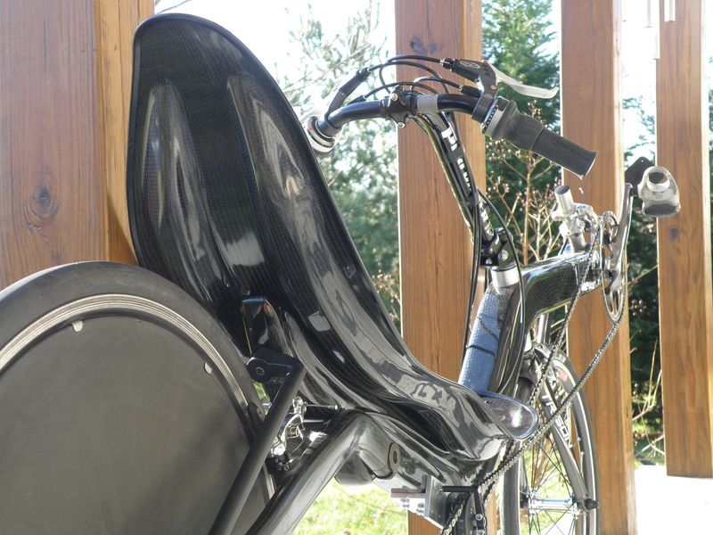

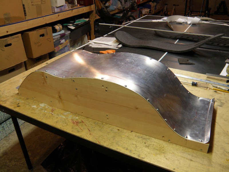

I agree completely with hifijim, except the part about the curved mold being hard to fabricate.
I made the very curvy carbon fiber recumbent bicycle seat shown in the pictures below, using a very simple mold made of a wood frame with an aluminum skin. I don't see why a similarly simple approach couldn't be used to make a "precurved" carbon/core/carbon composite speaker panel.
