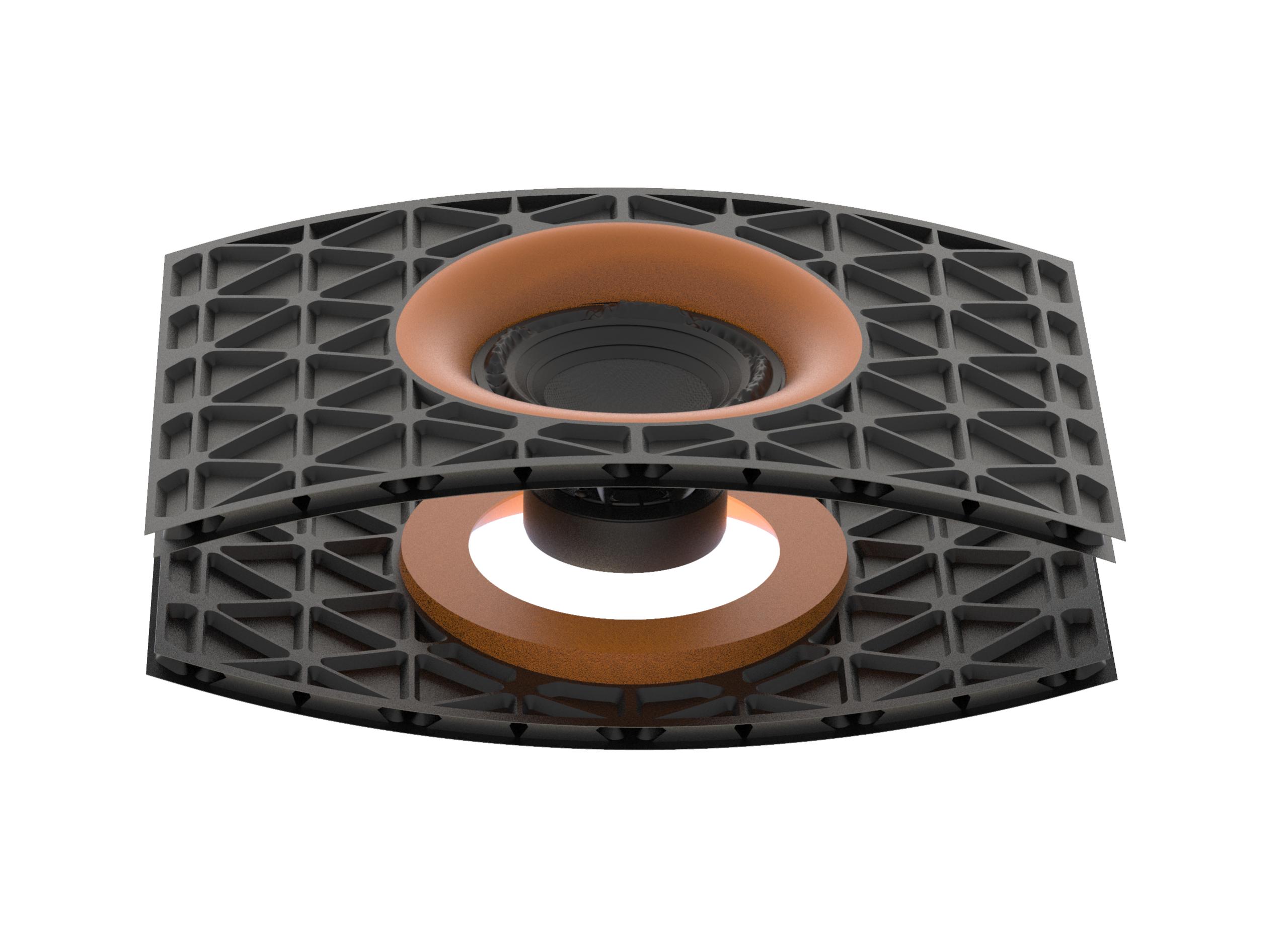

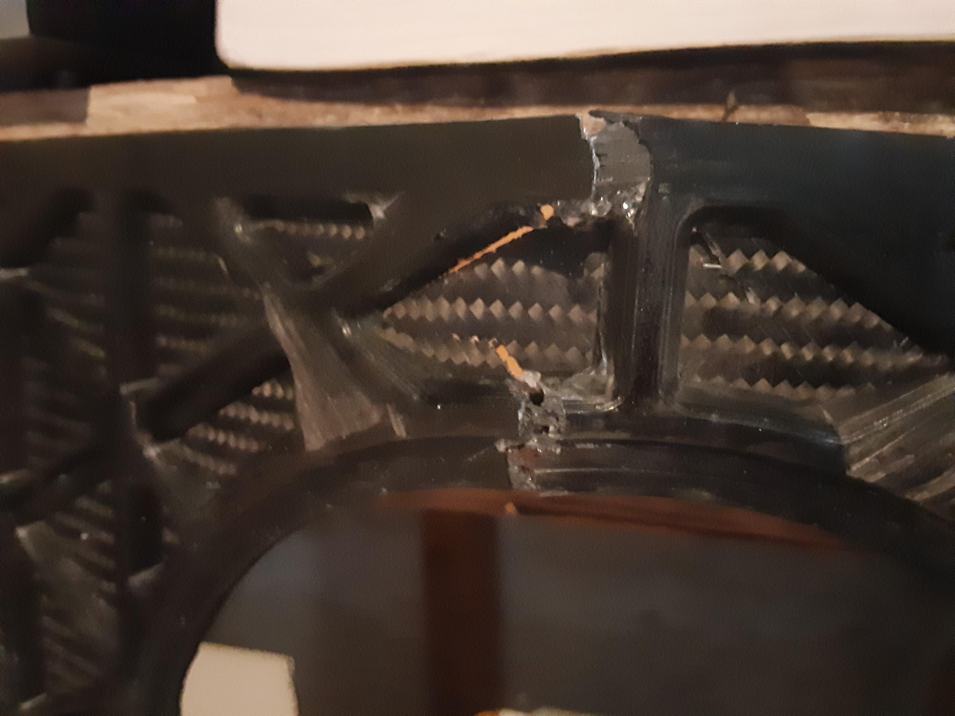

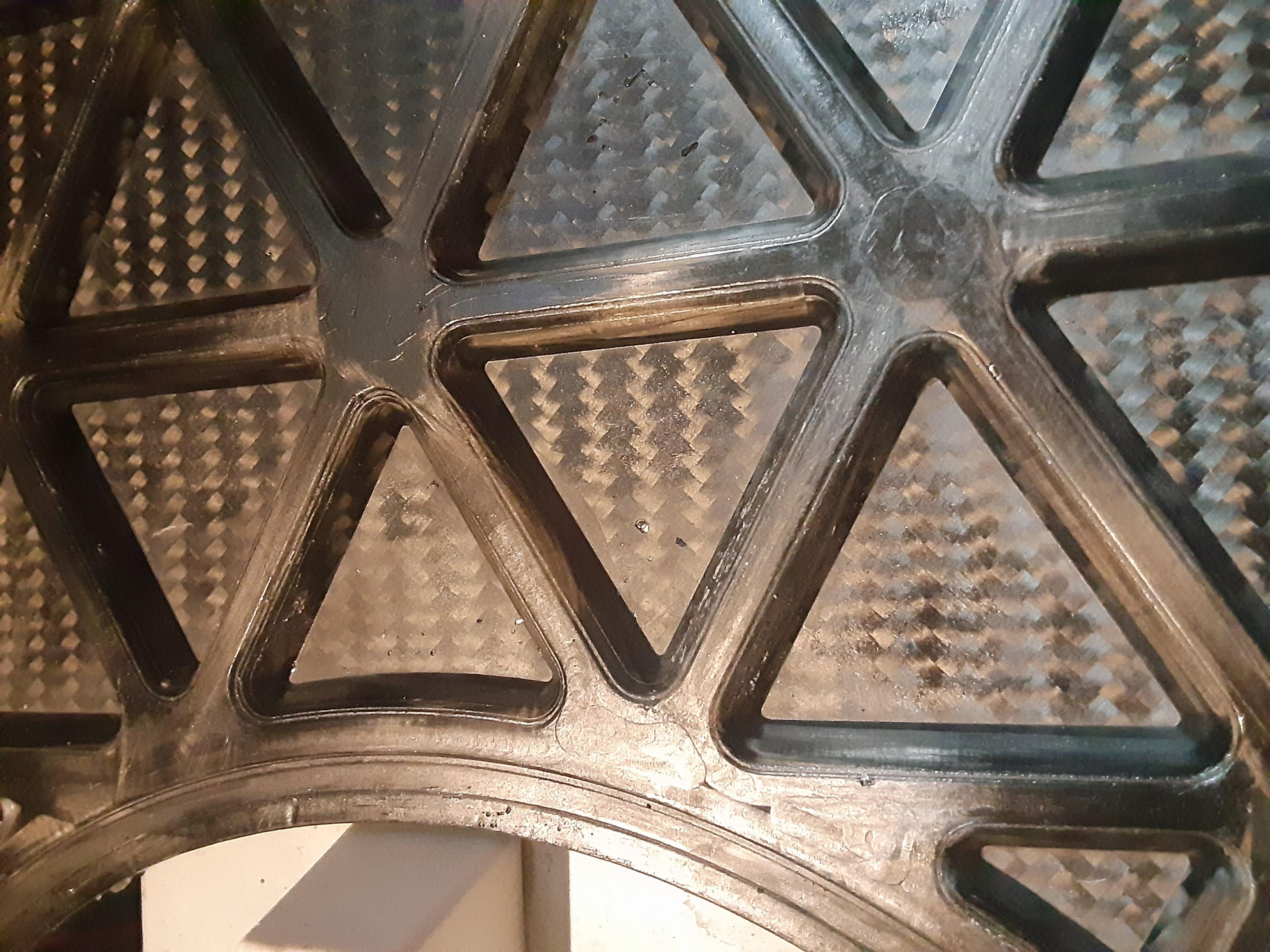

As I am getting closer to a full carbon fiber cabinet build I'll post some of the most interesting results here.

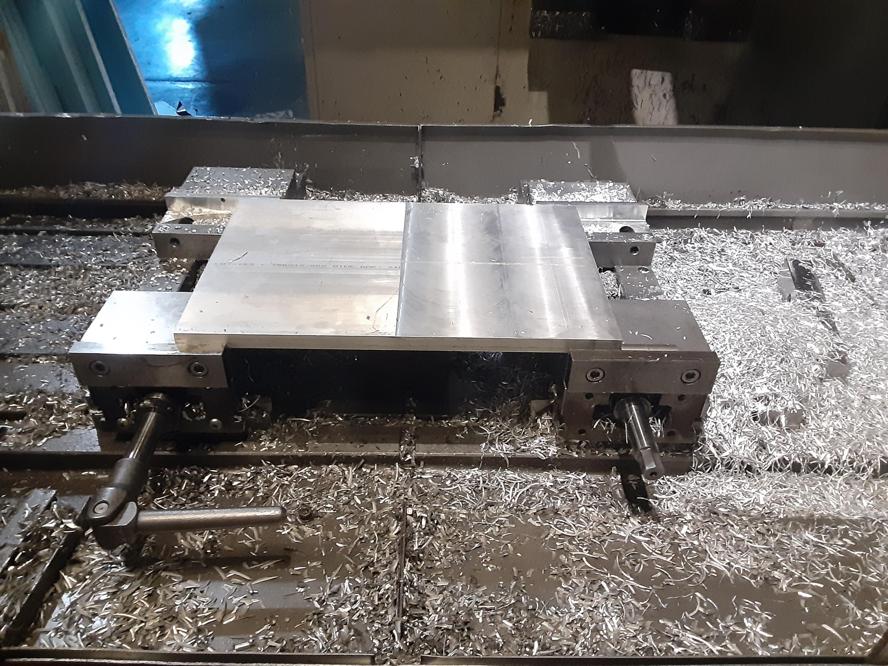

This work is focused on a 2-way Purifi PTT6.5 driver selection. The immediate goal is to access the full capability of the PTT. An overarching goal is to incorporate this work into an off-grid battery powered system. Lightweight, portable, and compact are priorities (aside from sound quality).

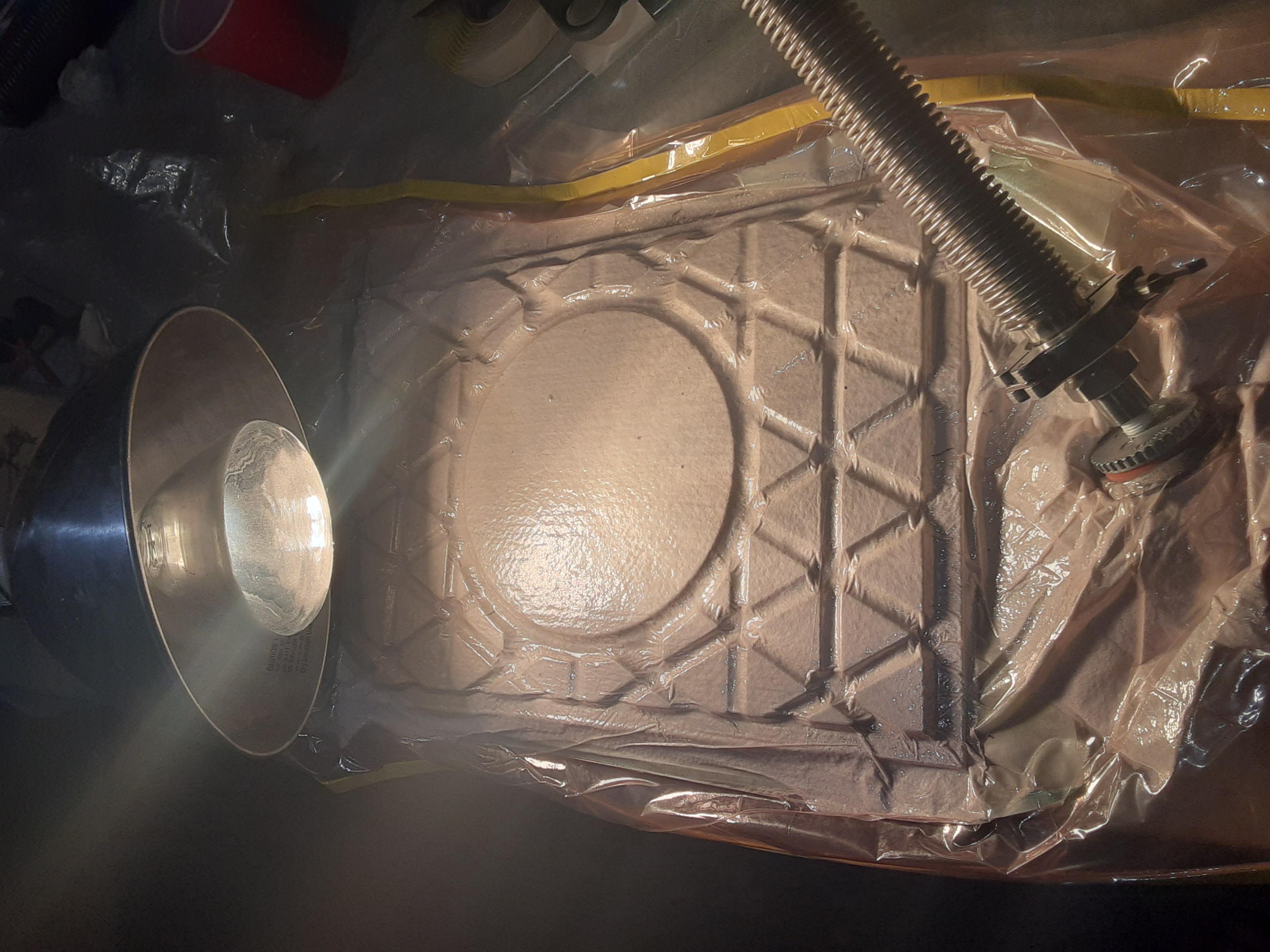

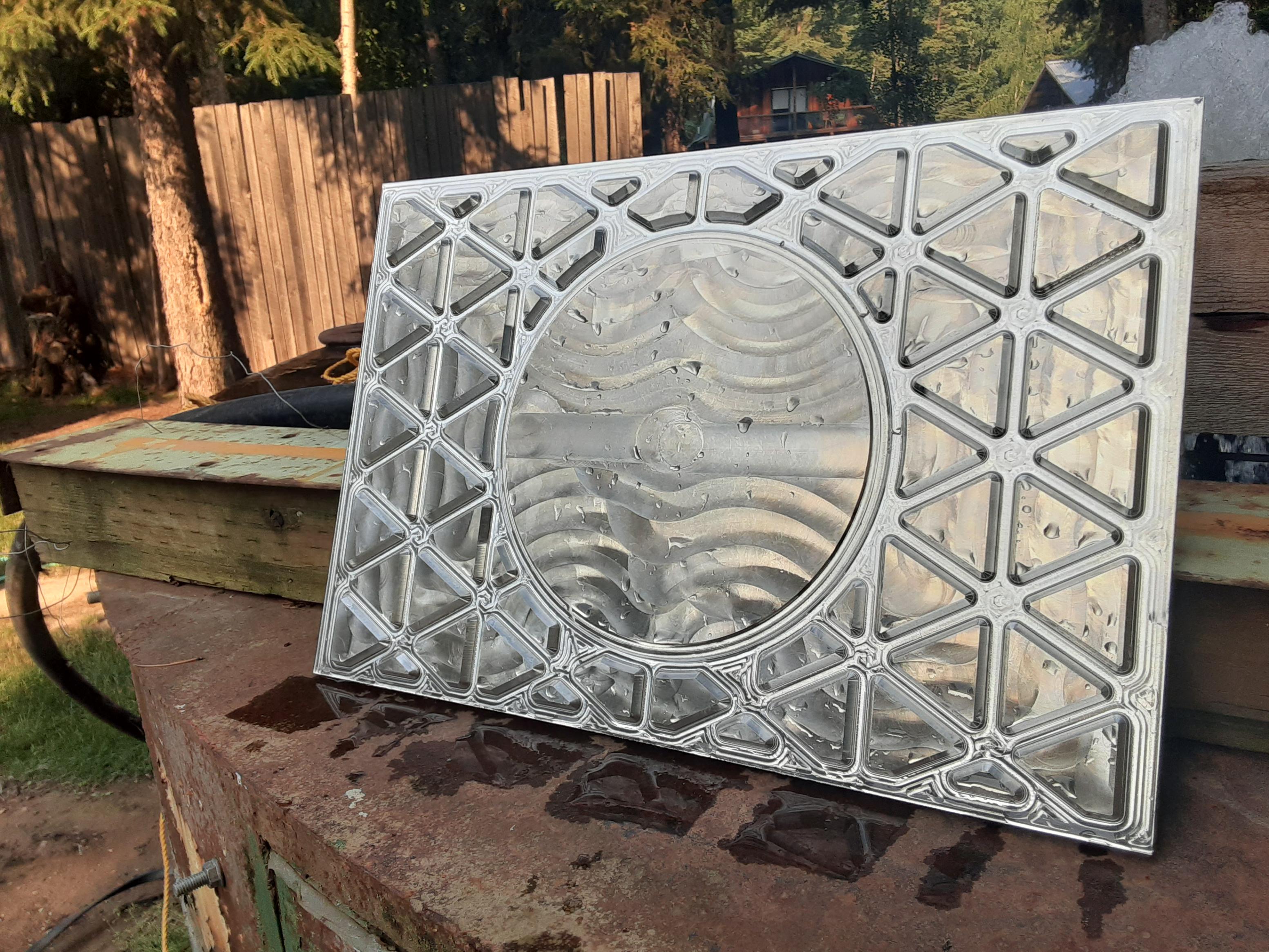

Currently I have made two attempts at an iso-grid style of construction. The initial concept was to use a woven fabric to mold two shells that will then be bonded under tension. This turned out to not be viable as the fabric is not able to drape into the opposing contours; it's basically fighting itself.

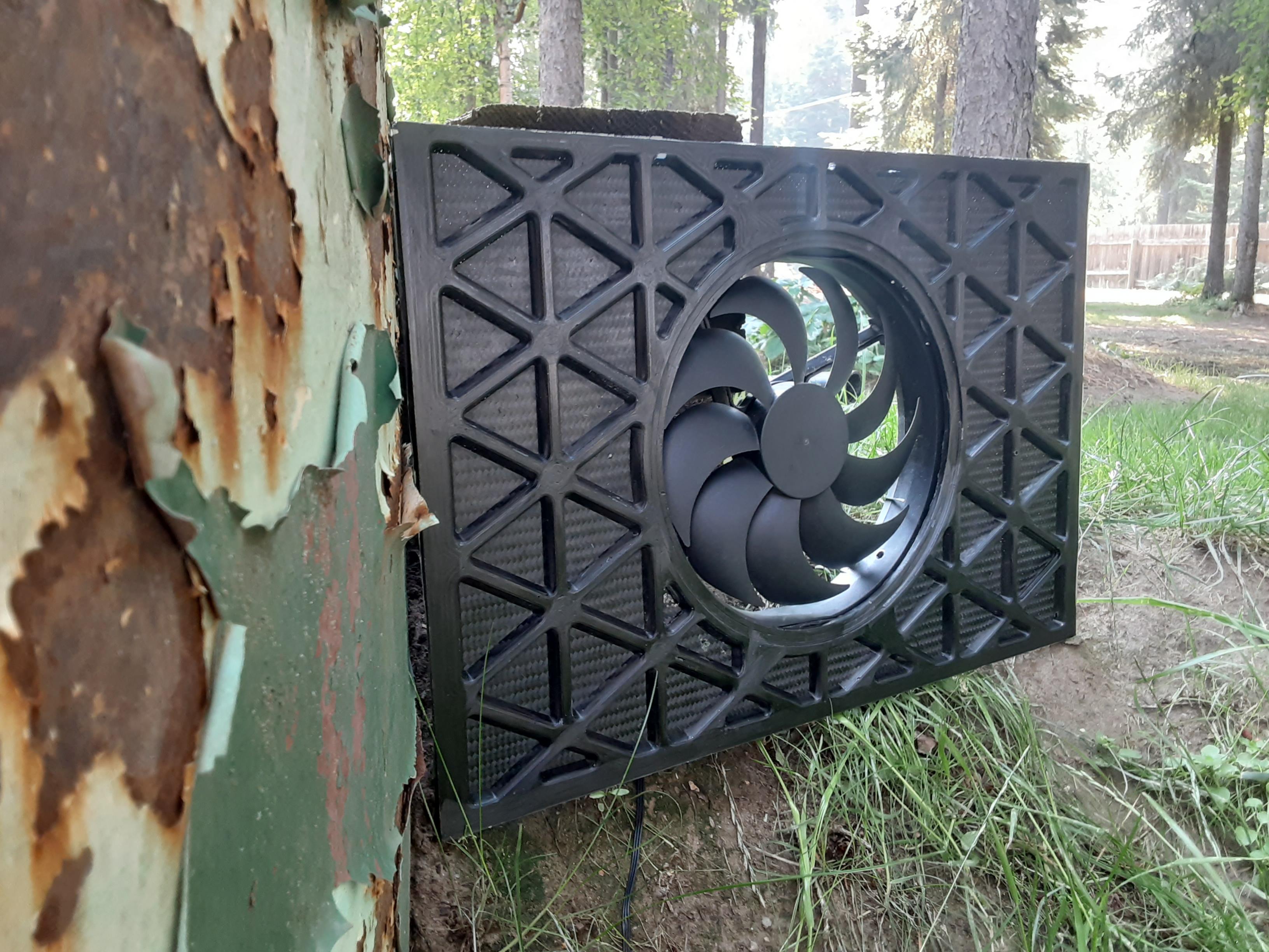

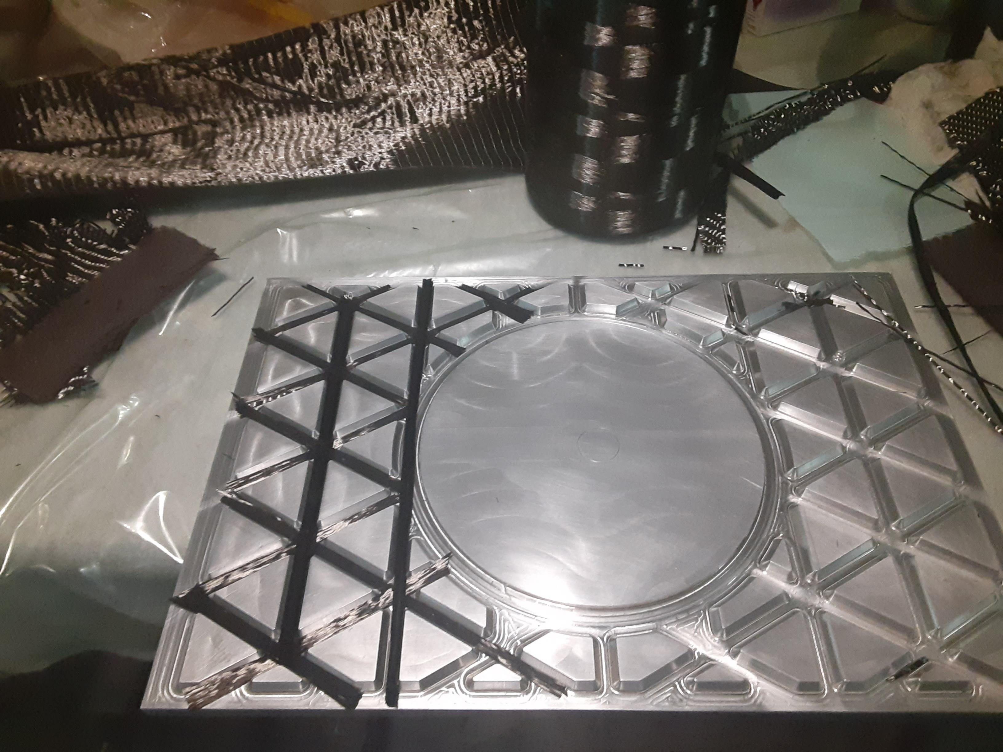

The second attempt utilized yarn that was placed into the ribs of the mold. An epoxy "core" then fills the remaining space until even with the mold face. Cloth is then applied to complete the sandwich construction. This attempt proved viable which brings the current attempts to date.
From the second strategy it is clear that some version of this technique could be used to create excellent results-- meaning smooth surface, no voids, good mechanical performance, etc.
Finally, the always entertaining failure test was performed. The highly [un]scientific test consisted of standing on the panel balanced over a 8" pipe until it failed. The combined cross section of ribs at the narrowest point is about 1.25" X .25" with a thin carbon shell. Rough guestimate puts the failure around 100ksi to 150ksi which is pretty good in my opinion.
Why does failure matter for a cab? The plan is to place the panels in tension. One way to achieve this is to take one panel and bend it into a curve, then take another and bond the two into the tensioned form. A possible problem in doing this is that the panel is already very stiff and bending it can induce considerable strain. So it will be necessary to keep the curvature profile within acceptable limits of the panel's strength. A benefit if curving the panels is free volume creation. Ok, enough rambling.....

Interesting to be sure. Is the use of a stressed member necessary? My experience with composites is modest, even more so with carbon. To date I'm only familiar with molding carbon to finish shape and when I have witnessed any significant flex, catastrophic failure was usually the result.
Carbon fiber is used for high strength systems, and I think it is reflective, you need a softer coating inside to control reflections and wall vibrations.
@seventenths
Induced stress is not necessarily required and you can build up the cross sections for a thickness more appropriate to one way or another. I won't be surprised if it turns out taking more effort to implement than is worth doing. Just a recipe in progress so far.

I share your interest regarding failure modes but it's just not a concern to me personally for this specific use case. I can't think of a more benign application to "catastrophically" fail. Consider: I just intentionally broke one between my feet and lived. Not only did I live, I didn't even flinch.
Think about the cross section, this is a thin skin. This is not a 1/4" solid UHM panel that has 4000lbs of total force acting on it. This is an extreme, not plausible, deliberate destruction that takes 100lbs and concentrates it over a tiny area.
Not saying these things can't/don't happen. Am saying no sleep lost over the very unlikely event that a one pound panel goes "tink" during a heavy metal sesh 😀 But it aint gonna-

Uh, wow. The tooling required to make your own panels! This stuff probably doesn't build with a paintbrush & rasp like they build surfboards of glass fiber & foam blocks.

Oh man, this composites stuff is a lot of fun and I'm really happy to see it here. Way to go on prototyping molds and pumping out these concepts!
I've made things like stressed panels and gearboxes, and even hydrofoil wings, but your structural testing reminds me of the skidplate-[un]science we did - throwing steel L-channel like spears at the panels 🙂
My $.02 on the enclosure is that I'm guessing it's likely to need CLD or maybe a dual-wall sand-filled-baffle that you can drain and refill for portability.(..?)
Looking at the Satori Textreme responses, they're all definitely hitting their 1st, 2nd, etc vibration modes as they go past ~5kH range, even if they do bond the cones to the VC at critical locations. The epoxy makes it more damped/controlled than a metal, but I'm not sure compared to paper, there's lots of coated paper cones out there. But they all resonate based on mass and stiffness.

I made carbon coil springs with a professor back in school, the trick was to bond them as opposite-direction spirals to help constrain the thing under fatigue loading. Also, although Belleville spring washers are more exponential than linear, you can get to linear by stacking them in progressive sequences of cone-up & down, so that some are going flat while others are still compressing
So many failure modes with composites, from things like shear-failure between layers, to micro-buckling of the fibers under compression, to all the issues from trying to fasten things to the actual panel. But they work great as pressure vessels (which is this).
The space shuttles all still used the same kevlar spheres which that same professor made for them in the 70's. He ended class once by looking and his phone and saying "Hmm, it's NASA..." Kevlar absorbs moisture and they busted a backup one they'd kept in humid Florida storage
Anyway, the Tsai-Wu criteria is a nice resource for some models behind loading conditions if you're interested, but I think your testing/listening is totally valid for this. It's sorta interesting that each individual fiber strand is full of weak sections, and breaks almost immediately on initial proof-loading, but the shear strength of the glue means that the rest of that broken fiber is supporting load only a few fiber-diameters away from the break
