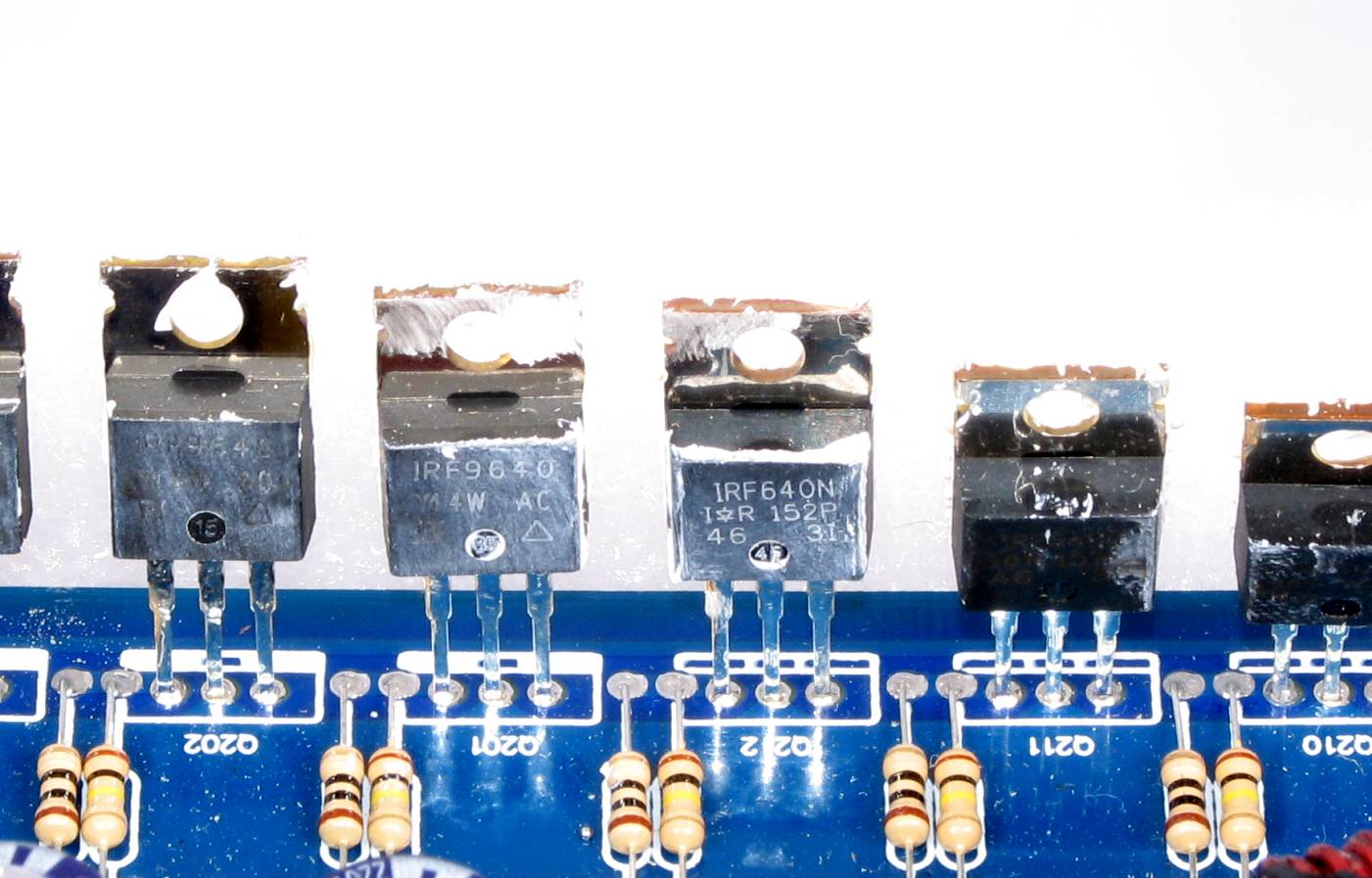

What's up guys, I'm seeking some information on the output mosfets for this amp particularly the insertion arrangement.
It was started by another person but they pulled the outputs and I think they got it mixed up, so far I see the amps uses 640s and 9640s (the "s" is for plurality).
It's 5 pieces per rail on one side (10 pieces for complete rail plus/minus), what fets do I insert on the positive rail and what fets for the minus rail?

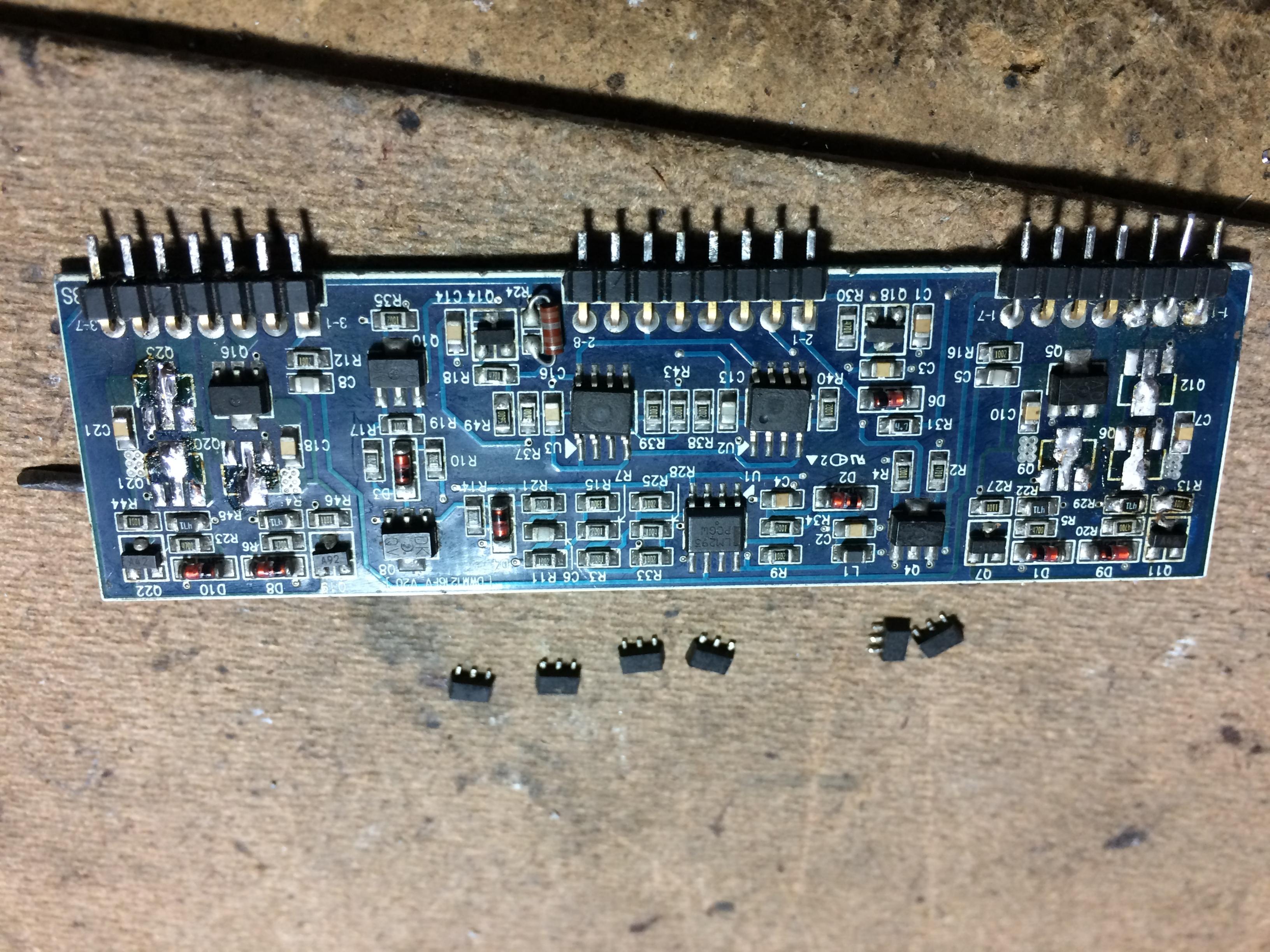

The audio driver board is giving some issues, the amp is making a squealing sound (even without input audio) with the output fets getting hot. I think I want to rebuild the board before I reinstall it, does anyone knows the part number for Q18 and Q14 and R24 and the U2 and U3 scratches off IC's and if there are any known parts that's likely to fail on these board?

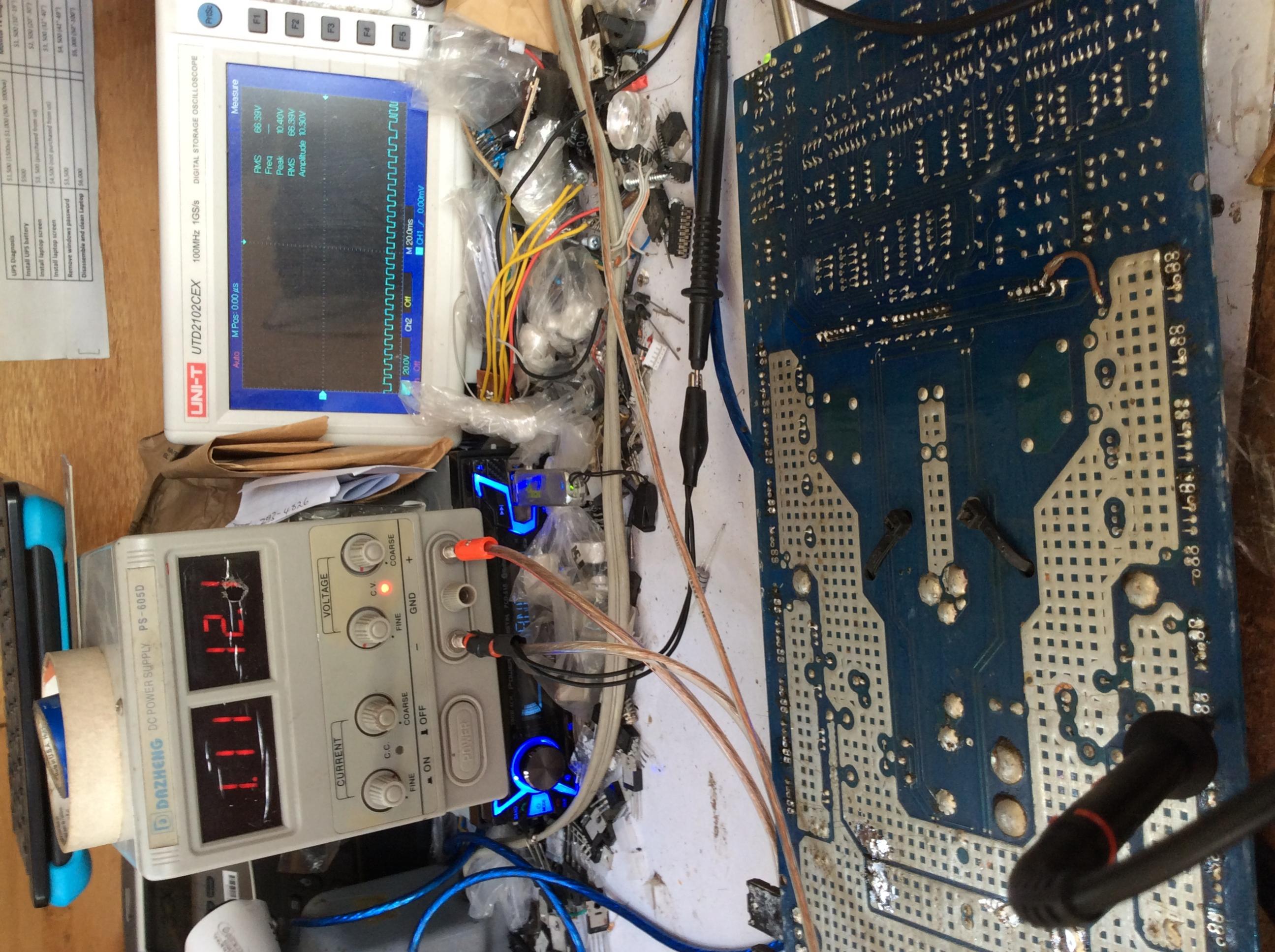

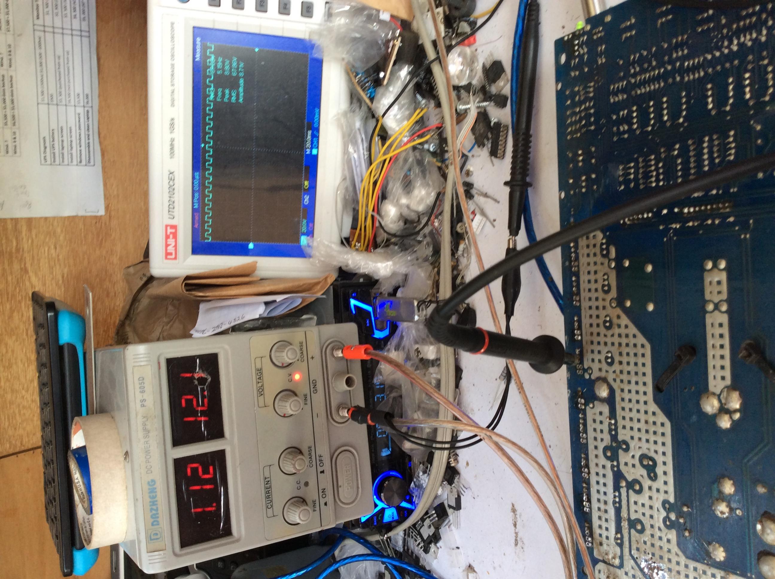

I’ve rebuilt the driver board and replaced the four rail caps in the power supply but the amp is only sinking my power supply voltages (approx 6v and drawing all available amperage also 6amp max) from 12v when I try to power it on.
It goes from protect to power and the relay engages. If left on you’d feel the outputs begin to get between hot minus and warm plus. I’m only using 8 fets (4p and 4n) out of 20 pcs.
However, when I remove the all the fets and add source audio I’m getting clean low and high side drive higher rail voltage (71+/-) and it doesn’t drag my bench PSU.
Is it that I don’t have enough amperage to boot this amplifier or I have to load all the output for it to operate properly? (Which I think would need more amperage).
