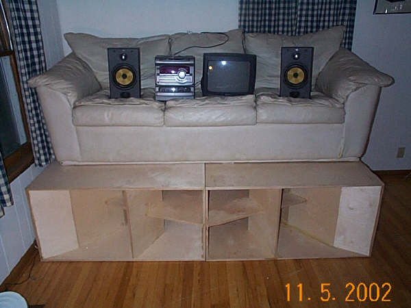

model the kicker in winisd.if you think you can make it do what you want,give it a go.
i would get a labsub or 2 if i ever was going to operate a venue of any sort. <105db efficiency and nice horn sound>
www.prosoundweb.com
90 93 96 99 102 105 108 111 113 116db <low eff sub.
1....2......4.......8....16....32....64....128...256...512watts
105 108 111 114 117 120 123 126 129 131db <basshorn.
the labsubs take over 1kw each if they have to.
2labs picture...

where can i find the plans for the labhorn?
Ahhhh, never been on prosoundweb before (thanks mike12345 !!), they even maintain a forum called Subwoofer Project.
cheers - cc
ps, mike, just bumped into their labplans , nice pics and dimensions in both mm as inch.
