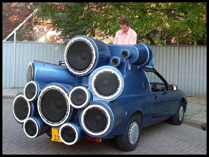

that sure sounds like fun (and I'm laughing)
hey, don't forget the Danley truck subwoofer 🙄
I guess you could build a smaller 'VAN version', and still have bass 😀
