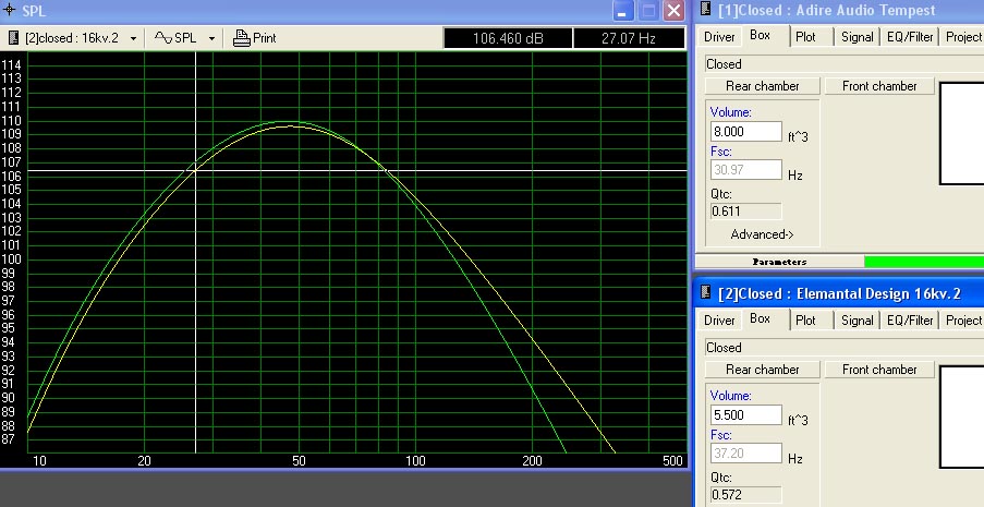

I have been looking at this sub to use at home. I plan to use a pair of these in a low Q sealed box. It models very closely to a Tempest. The sub is an Elemental Designs 16kv.2. I am thinking of chosing this over the Tempest for 2 reasons... 1 - its a little cheaper (plus an extra 10% off when you buy 2) and 2 - I can get away with a smaller box (without needing an Linkwitz Transform).
Is there any reason why you think this would be a bad choice?

The following graph represents the SPL I can achieve with 250W in their respective enclosures. Both subs get very close to Xmax at about 18hz or so (with the 12hz HPF included on the amp I plan to use). Will 250W really get these subs to Xmax in these relatively large enclosures?

actually, that looks like it models very well. This interests me if its cheaper than a tempest. Could be another new steal of a bargain for DIY HT drivers.
Id say go for it, it doesnt mdel to much different from a tempest, ahs a bit more sd a bit less xmax, and should sounds pretty similar and hit similar SPL levels.
