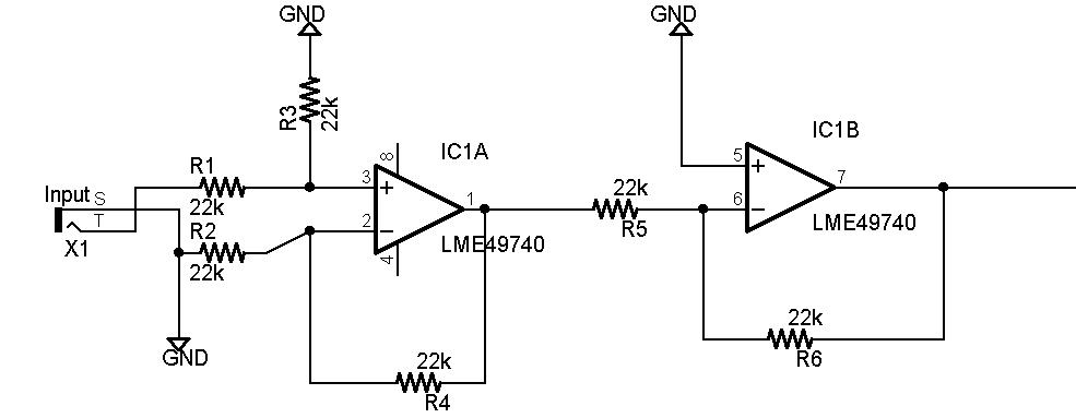

AndrewT or anyone who's implimented a differential input could you give me a little help with my differential input? Basically I only get good operation when I connect the rca shield directly to signal ground. Using a cap/resistor (tried many values of each) gave increased noise, though slightly better than nothing connected.
As you can tell I'm new to using a differential input, attached is a simple version of what I have on the breadboard right now. Power supply is taken from the output of the amps smps and regulated to +/- 15v.
It's pretty good at rejecting noise from a very crappy bench power supply (completely unusable using normal input buffer, and very listenable with slight noise using the differential input) and it's pretty much silent using my regulated bench supply, however I'm assuming that some cars "could" be more like the noisy bench supply.
I'm also not sure how to impliment a dc blocking cap on the input, if it's as simple as putting a large enough film cap on the signal line before the 22k resistor.
that's not a differential input.
That is an unbalanced input.
Is your source expecting to see a balanced input?
Is it not a differential input if the rca shield to ground connection is removed? That's where I need help since that schematic is the only way I could get silent operation using a noisy supply.
The source at the moment is a typical car cd player (alpine cda-9813) so it's expecting a "normal" input.
if the CD player is expecting a normal input then I think Alpine mean an unbalanced input.
Forget differential.
Thanks AndrewT, is there a good fairly noise free topology to use for amplifier input? I'll probably be making a few of these for friends etc, and most of them don't have the best quality stereo's. I'd like these to work well and engine noise free, atleast the best I can create.

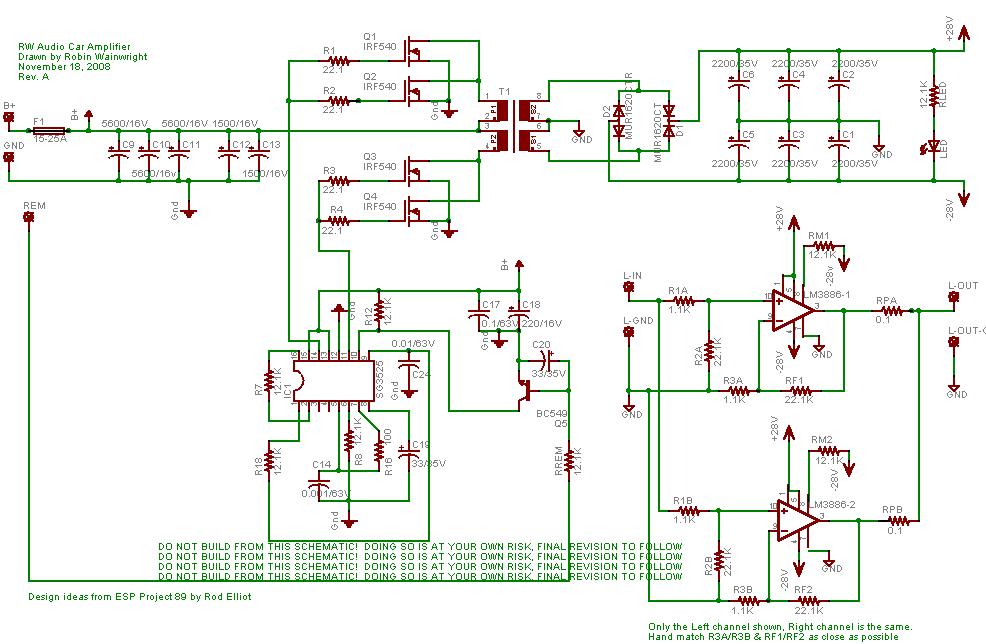

Hello everyone, I haven't cleaned up the schematic yet so I can't post that. But I do have a 99% complete BOM (this does NOT include parts for the preamp board, this is amp/power supply only) The idea of having the preamp board seperate from the main board is for almost unlimited configurability. If you want crossovers, or balanced input or whatever you can imagine, it can be added to the amp. I will be designing a couple versions, simple input, and probably highpass or lowpass crossovers.
Please note, that this version is intended for a subwoofer amplication, as many people have found the large rail capacitors I chose may not provide the best possible sound quality in a mid/hi freqency application, some trial and error may be required.

Attached is the first version of the schematic, I haven't double checked everything yet so please use it for reference or learning. Please don't build from that schematic yet until I am able to confirm it. Also snubbers will probably be added to both the power supply and amplifier outputs.
if so I can send you the g-code directly when it's finished since that's what I use on my cnc machine.

Hello. Can You help me with selecting right ferrite core. I did not found the same core as you used...
The list of availible cores is here:
http://www.promelec.ru/catalog_info/54/132/523/292/
Here are dimensions : OD*Id*H
And here is parametres of cores:
http://www.promelec.ru/catalog_info/54/132/522/290/
Thanks.

Hello Stream,
I had a look at both of those pages, but I'm not a ferrite expert. I don't know if those cores are close enough to the type 77 that most people recommend. Here is a page that lists a little more info on the core I chose I hope that helps.
http://www.bytemark.com/products/fermat77.htm
I'm using the F140-77
You might try contacting the company from the links you listed and ask them for a core suitable for SMPS or reference the type 77 core and ask if they have something comparable.

But were is the primary filter coil for +12 rail? To prevent peaks fly over car instalations?

What is wire Size (awg) for work with T1
I am interested for your DIY. I am try to finding copper wire size compatible for T1. Please advise 🙂
