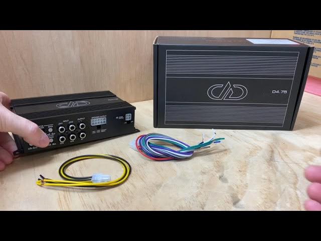

I have a 4 channel amp that is 4x75 watts rms
Max current draw is 40 amps .
The power plug that comes with the amp from the manufacturer had 2 -18 gauge wires coming out for power and 2 -18 gauge grounds .
Wondering what size power wire do I need to run to this amp the length of the power wire is less than 2’ ?
There is another plug for the speaker wires coming out of the amp when connecting speaker wires to the plug should I use butt connectors or solder the connections and use heat shrink

Perry,
I guess I worded my last reply wrong .
I’m wondering what size power wire I would need to run to the amps power and ground wires the connection to the battery is less then 2 feet .
The 2 18 gauge power and ground wires coming out of the amp is from the factory as seen in the pic
I just need to extend them a lil so I can hook them up to the battery so wondering if 12 gauge is sufficient or would I need larger wire

To answer your other questions crimp connectors are fine but you can also solider and heat shrink. One is not better then the other as long as the connections are made properly. It's a personal choice.
To extend the power leads an additional 2' just use wire that is the same gage as what is used in the amps pig tail or larger. If it is 2 18AWG wires then use 2 18AWG wires to extend the reach but 12AWG would work too. Just make sure to put a fuse at the battery even if there is a fuse in the amp it doesn't matter you still need one at the battery.
