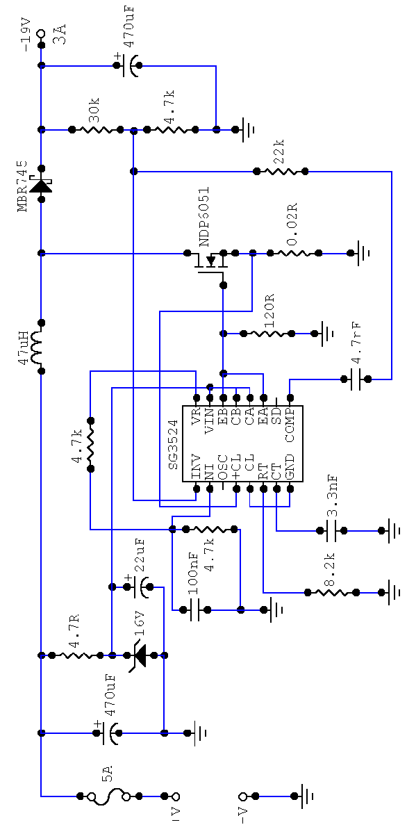

i found this schematic while searching.
I have a source for all the parts, except what type of a torrid is needed, and does it even have to be a torrid?
Also, there is a connection labeled Remote. why do i need a remote on it? Since i dont want it, how many other parts connecting to it can i get rid of?
Also, there are +/- 30V feedback connections. what are those for? Can i get rid of them?
Finally, do i need the three 100uh inductors?
EDIT: Do i need that fan also? if not, how many parts connecting to it can i get rid of?
EDIT: Also, how much amperage should this circuit produce?
I don't think it has to be a toroid, i'm not a transformer expert though (not a fan of that class in my course 🙂.
Remote is car use, turns the amp on and off when the headunit/cd player is turned on and off, so the amp isn't idling overnight draining ya battery.
the Feedback means the IC will control switching pattern and length (pwm) to maintain 30 volt rails (ratio dependant). Without this, it basically goes to max with no load, and comes down under load.
Someone said inductors were purely for the feedback circuit, to make the pulse work better, i guess it might get rid of high freq transients or something, a lot don't have them.
Fan depends entirely on your heatsinking, most amps don't have a fan. Allows an easy connection though.
I think Rod said the circuit will do enough for 6 gainclones, its very toroid dependant.
http://sound.westhost.com/project89.htm is best source of info for this circuit.

I have made three units for DC step up (although not isolated) was simple to build, just needed a choke coil (not a transformer) and got about 85% efficiency with minimun of parts. my units put out about up to 30V with a 12V input. haven't torture tested them yet. probably 2A or so. maybe more with more MOSFETS and bigger coils.
do you have the exact schematic you used to get that 30V output?
