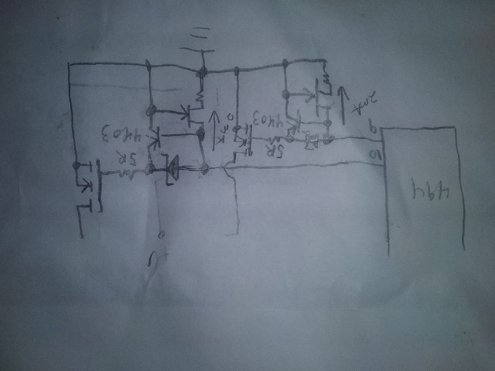

494 has open collector/emitter outputs. When using the 494 emitter outputs I like to use a J-fet CCS as the load, and a cheap 4403 as the turn off transistor. 🙂

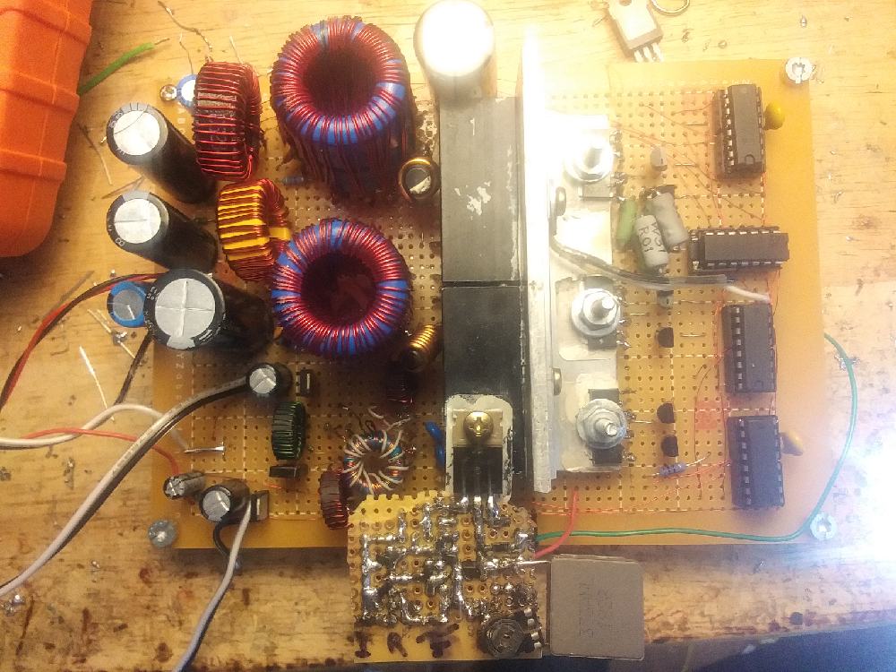

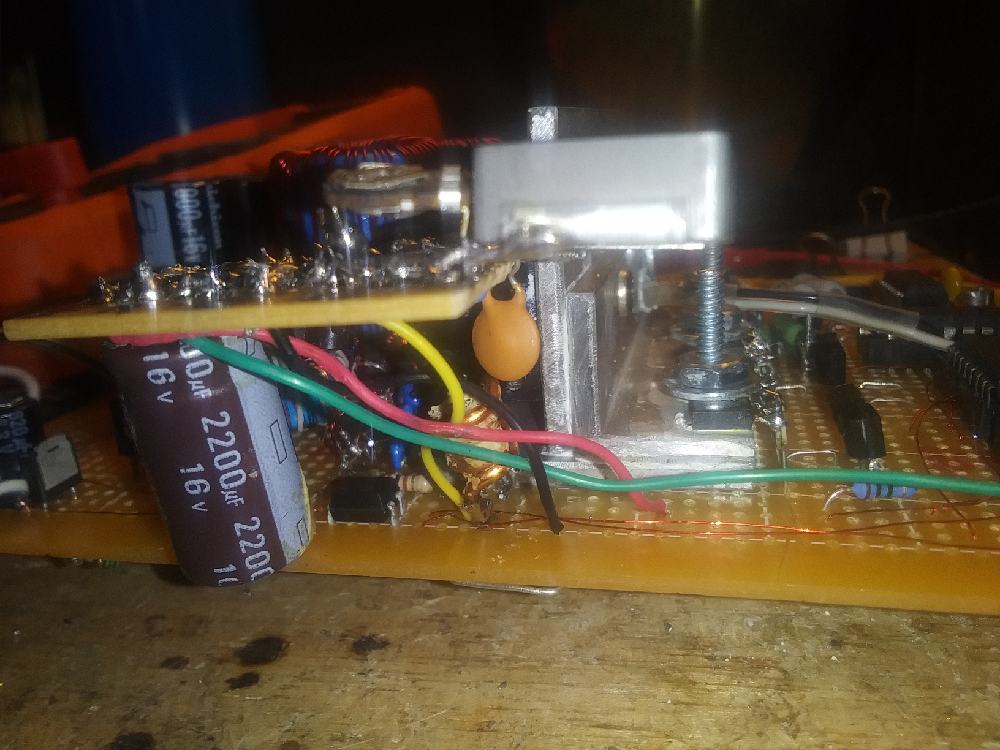

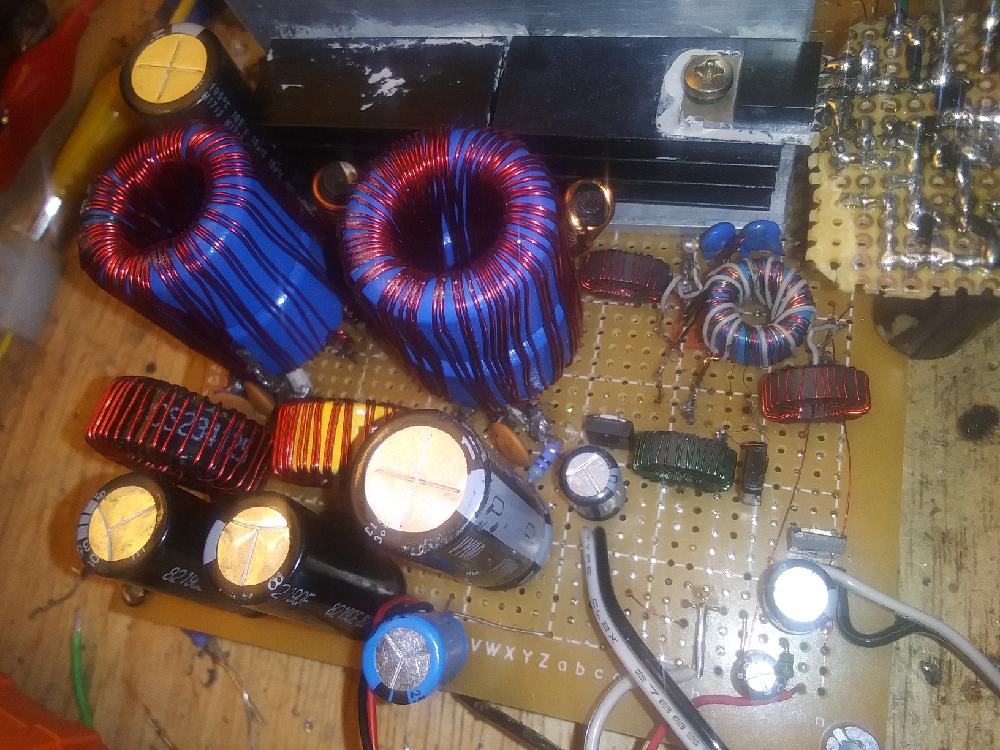

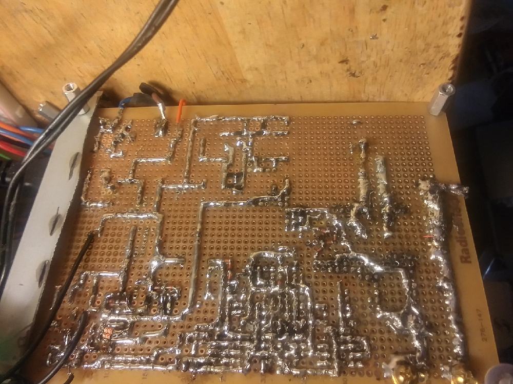

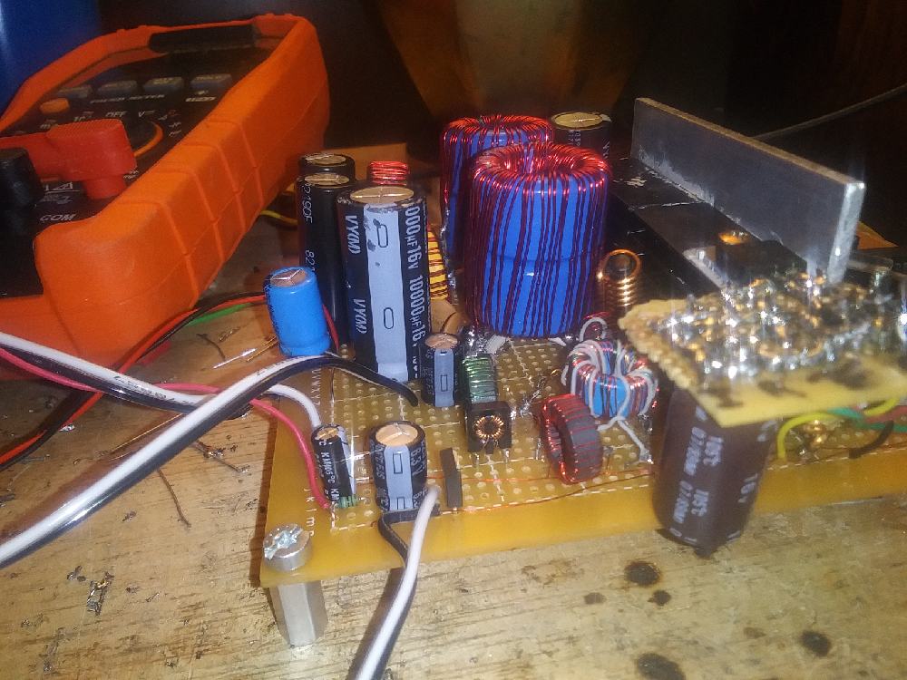

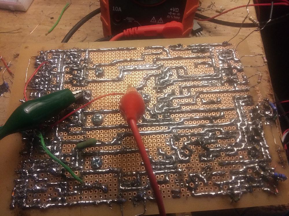

This is a Frankenstien circuit I just made to test a few things and to power a hybrid amp that have. It works pretty good.🙂
Output is two identical isolated separately controlled 30V power output sources. (connected in series at input to amp PCB.)
Pulse by pulse current limiting. (possible with cheap 494 using external components, i. e. a comparator and a latch driving pin 4 (DTC), reset via sawtooth on pin 5. (Ct))

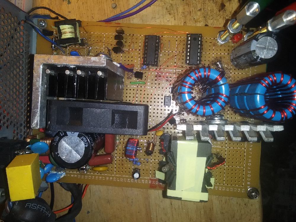

Also, a third baby toroid produces the other voltage sources needed: +50V/-150V @ 10mA (2W); 2 separate isolated 6V @240mA (3W) floating current sources for the valve filaments; and +5V up to 1A (5W) for USB, and Bluetooth receiver. The 200V is regulated by controller and is is driven by 25V secondary and voltage multiplier circuits. Primary is from 9V, regulated from small buck converter from main 12V- 13.8V source.

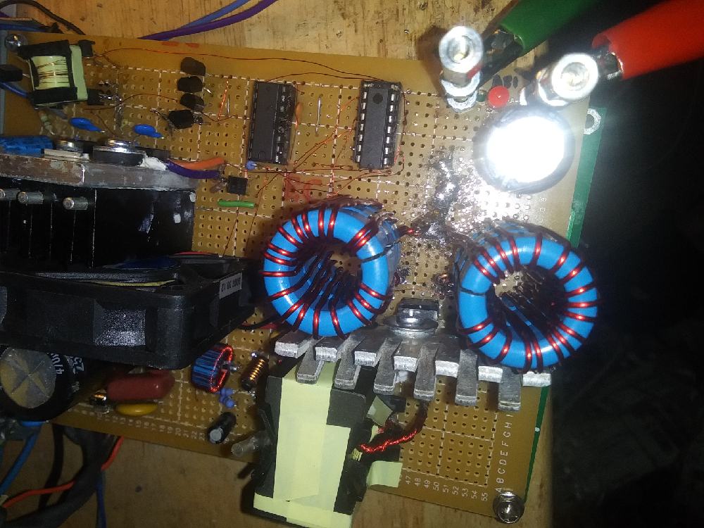

The large power transformer toroids are 25×14.8×15mm, 2 stacked, N87 material (u(i)=2400). Two parallel pri, 2+2 each, 6+6 sec. Fsw=50KHz
The baby toroid transformer is 12.7×7.9×6.35mm, N87, Fsw=145KHz
The inductor cores are powder cores ripped out of old junk.
Yellow with white stripe is good here, type 76? I think, with u(i)=76 I think.

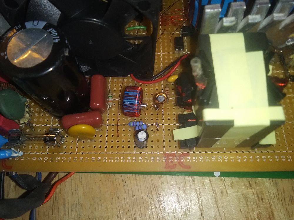

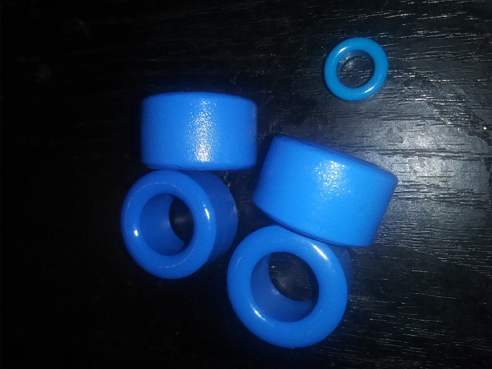

Of course this circuit is for home use though, PCB being drawn in Eagle. The main source is another Frankenstein circuit, off line 12-13.8V high current supply. Also using 494; half bridge with current doubling output. Voltage and current mode control. I had no powder cores on hand for the output inductors so I totally went Frankenstein and cut a 1mm gap in some of the cheap T38 u(i)=10,000 cores I have for CM chokes, changing them to effective u(i) of about 50. Three cores stacked. Quite surprisingly, it works OK.
However this project is venturing off topic, but as a total novice I just wanted to point out some details I've found helpful.🙂
Edit: As I am a total novice at SMPS, some details I've found out to be helpful are material types and winding techniques of magnetic parts, PCB layout, decpupling, and placement of snubber which is important. Most of which I learned here🙂.
