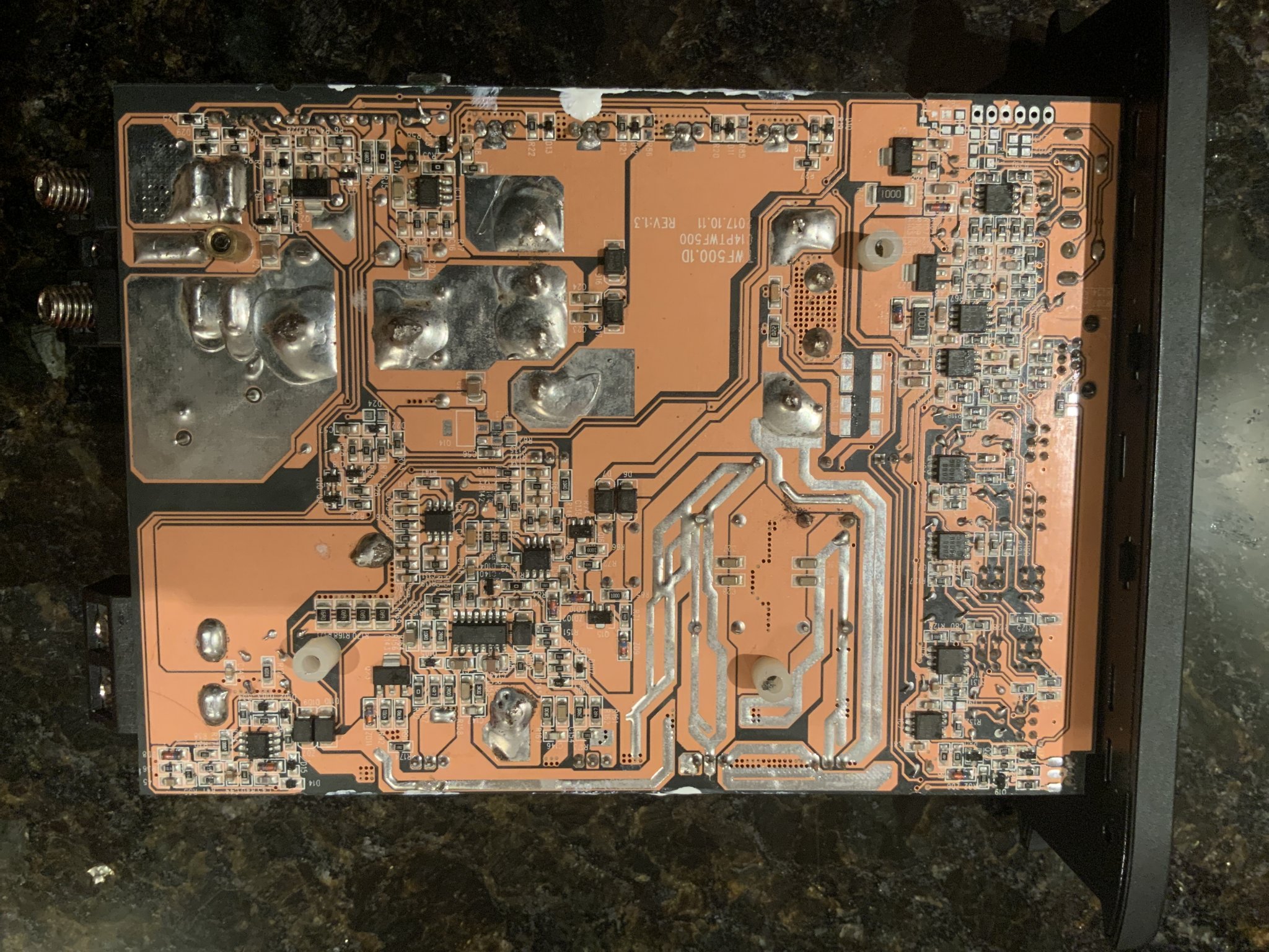

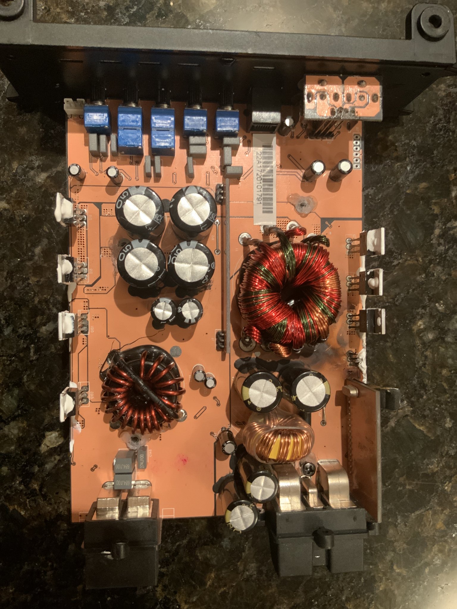

I’ve got an 750w mono block amp that’s virtually just over a years old and it failed while driving. Turns out it’s just out of warranty so I stripped it down to have a look to find a burnt out MOSFET irf3025. I got some new ones and replaced the burnt out one only to hear it pop as soon as I turned it back on. I would like to see if I could repair it. I found a thread with the same problem (kicker sx1250.1 burnt power transistor) and can follow the directions somewhat but I can’t find the QO5 driver transistor to test.
The burnt mosfet is Q8 , pins 1-2 are 4.5Mohms, pins 2-3 are 4.5Mohms and 1-3 are 68.7ohms
In the other post it’s noted that from 1-3 should be 47ohms which is what the others are except the burnt out one which is reading higher. Is there anything else I can test or am I better off buying a new one? (I’m a mechanic by trade so I have some electrical knowledge and if it’s not to complicated would like to try repair it)
