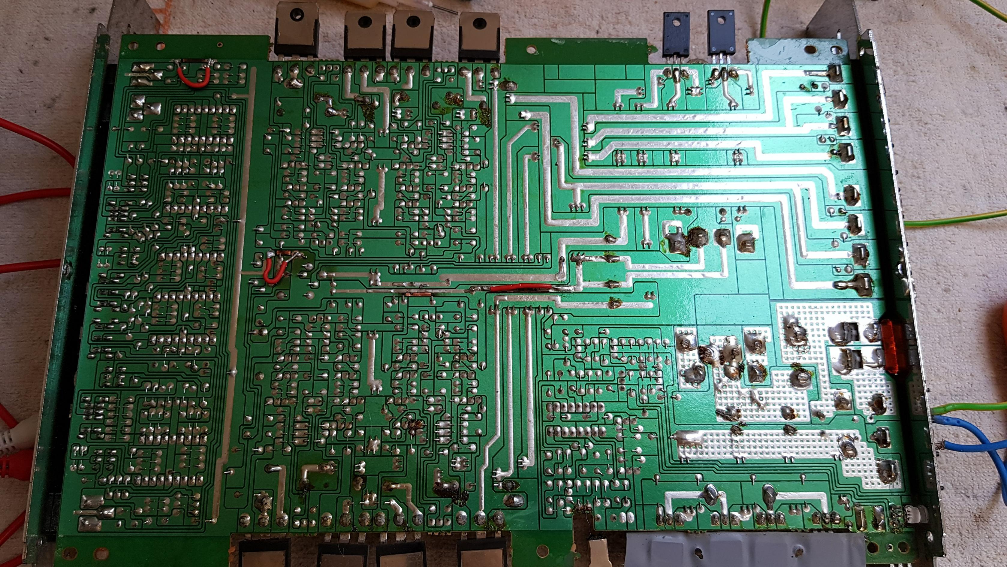

From underneath the amplifier a big (I suspect a GND trace) is going from the transformer to the pre-amp section.
This trace has been burned at several spots (I fixed this already)
What I tried to fix already
I made some clean jumper wires which replaced the trace. I put on some new solder on the traces to thicken them.

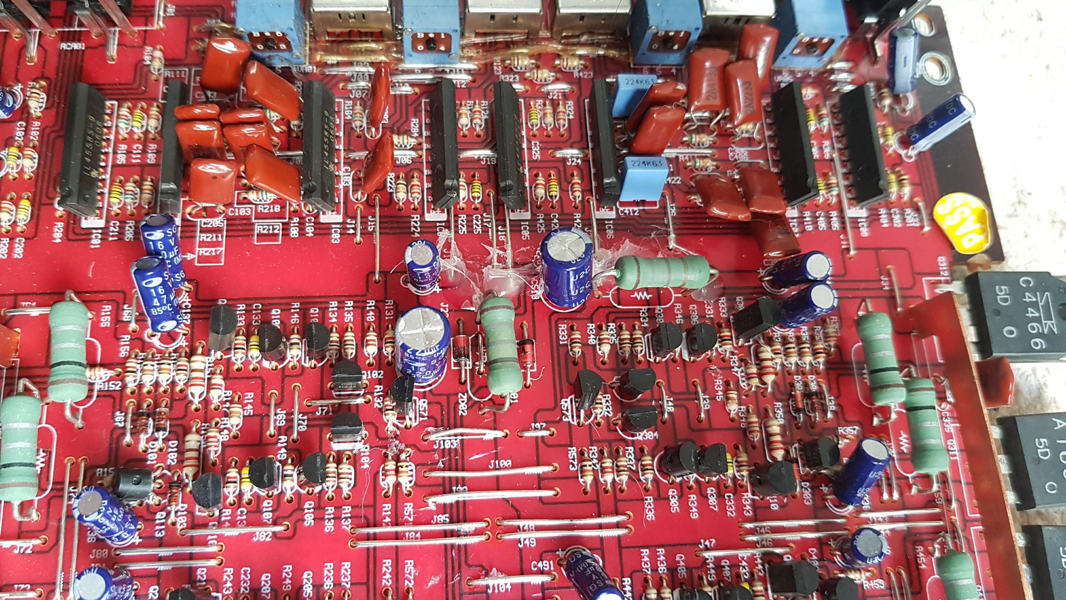

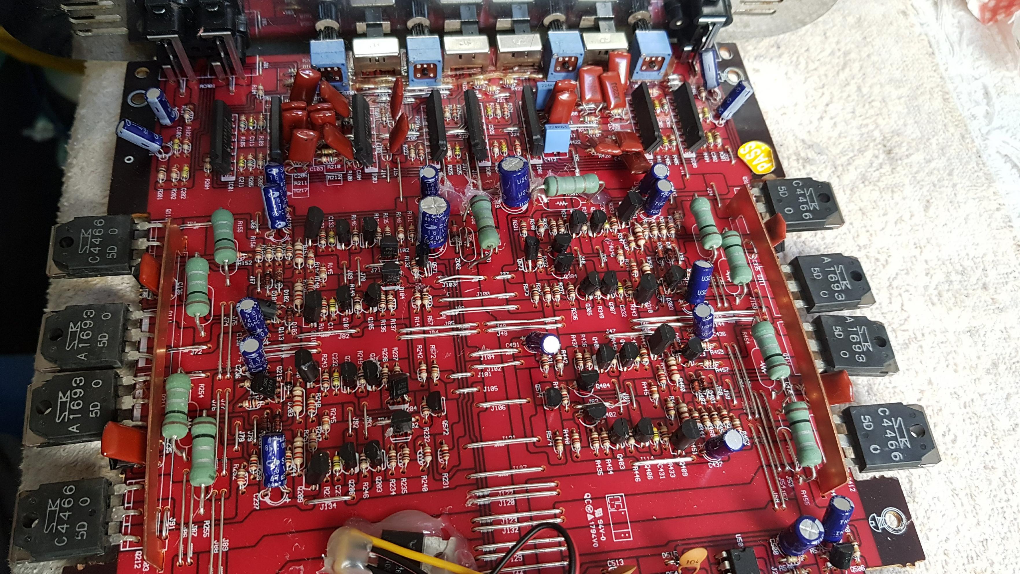

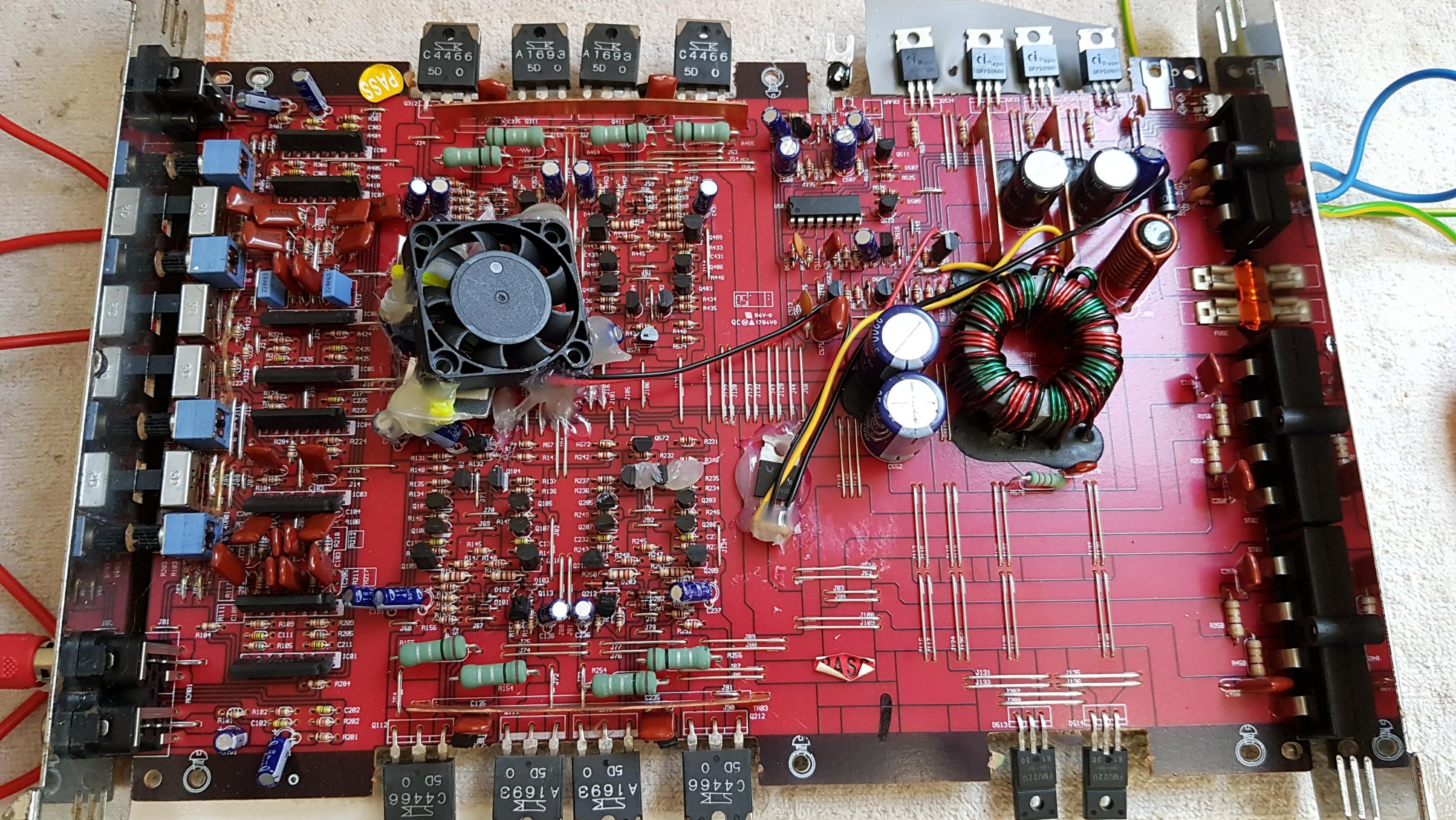

The things you see on the photo's:
On top of the amplifier you see a cooler. I made this because there are 2 thermal resistors which both read +- 150ohms which get incredibly hot when troubleshooting. I think a big part of the 0.70 ampere idle is going to that resistors.
Just to make sure they won't burn because I am not sure these should be getting that hot.
Underneath the amplifier you see the burned GND traces.
Some has snapped of the board and some just got burned.
I made a jumper wire which should be a lot thicker than the trace itself.

Attached are some clear photo's of the resistors.
One resistor reads 145.6ohm
The other reads 156ohm (which is connected to the VCC)

The glued TO-220 mosfet is used for powering the cooler. So the cooler current is not pulled from the REMOTE but from the 12v+, but it is controlled by the REMOTE. This is not original.
