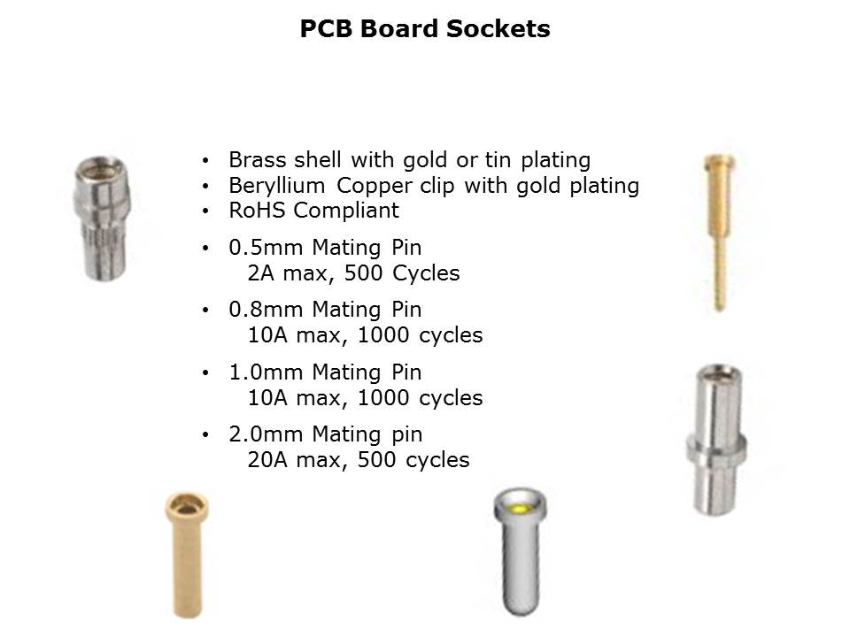

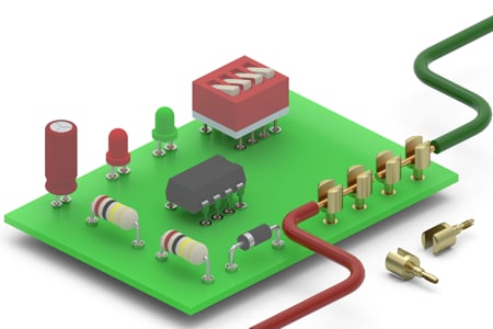

What about PCB sockets (and pins)?
Those look interesting, thanks!
Any idea for the snap-in cans?

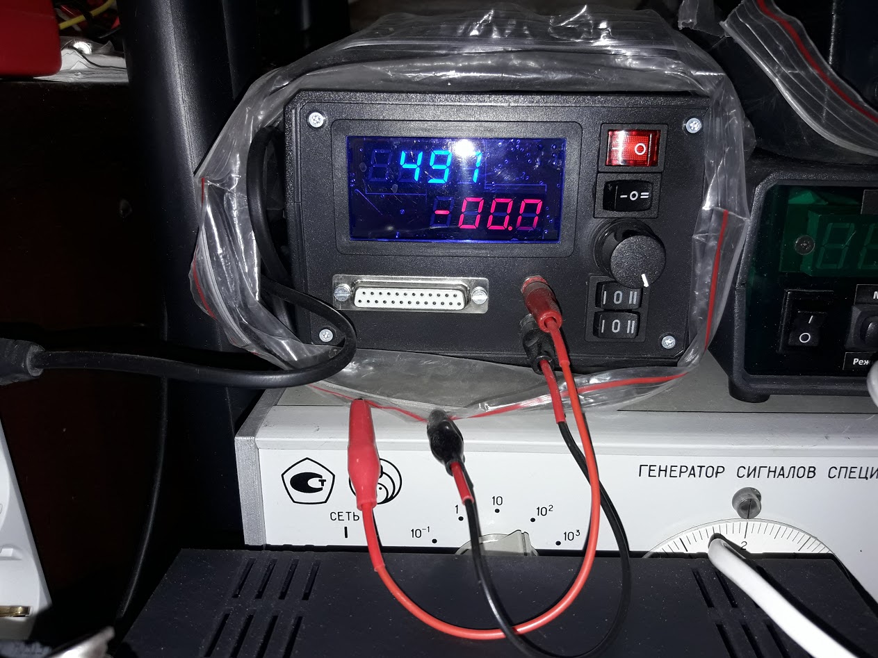

Here is my capacitor/transistor/diodes ets 0-500V tester.
DB25 type connector connected parallel to 4mm bananas with crocodiles and are universal (fits everything), usually I use crocodiles:
