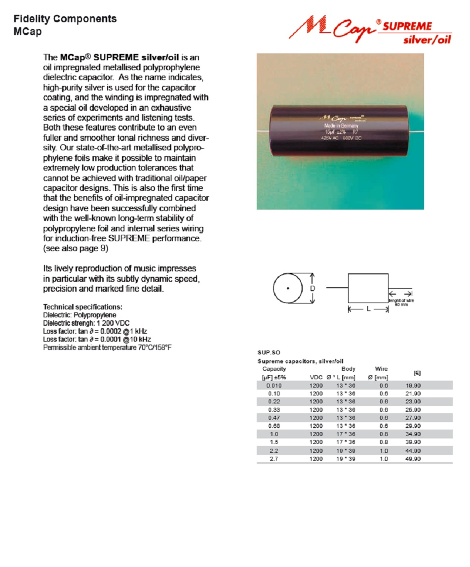

I think there may be some misinformation (unintentionally) sneaking into this thread regarding the Mundorf Silver & Oils.
I spoke to the store that I purchased mine from and am reassured that the specs on these caps state 70 Degrees
I'll have a PDF soon, and I'll post it here 🙂
Ian.

Here we go 🙂
The retailer I used has told me, he has sold a a lot of these and never had a complaint to date.
Ramallo, I'm not questioning your experience, and I have no answer to why you had this experience, I looked into this as I wanted to be sure...for myself, and I'm resting easier now and will not be changing my caps 😉

I used Mundorf Silver-oil capacitors in a recent Audio Research LS-15 reference restoration. The capacitors were mounted 0.5 inches away from the tubes. I ran the unit (powered ON) for 3 days and measured the capacitances again. They had not varied at all (5.595uF in both readings). So, in my testing, I did not observe any heat issues. I suspect the previous report was based on the fact that the capacitors were actually touching the tubes, which is not recommended for any setup using any type of capacitor.
I may be resurrecting this thread, but want to update this with possibly new information, so that people researching this will not be put off with old information. From Mundorf's web site, the MCap SUPREME SilverGold Oil caps are rated to 85C, so are OK for even overly warm tube amps.
Technical specifications:
Capacitance: 0.010 μF-10μF
Dielec: Polypropylene
Metallisation: 99% Silver / 1% Gold
Purity of silver: min. 99.97% typ. 99.99%
Purity of gold: min. 99.97% typ. 99.99%
Dielectric strength: 1.200 VDC
Loss angle: tan ∂ = 0.0002@1 kHz.
0.0001@10 kHz
Permissible ambient temperature 85°C/185°F
