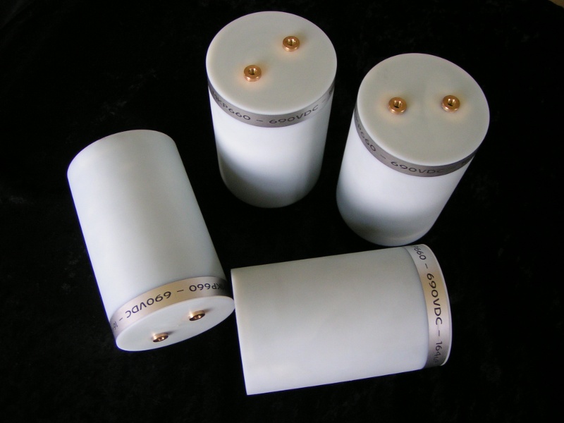

A good example of what I'm trying to say, you can see here:
I bought a few Vishay PP film caps, without housing
diyAudio
And made a nice hard and dead housing to cast them into, using a type of compound also picked from the industrial segment.
diyAudio
Result: A cap that does not suffer from microphonics, and can take a lot of abuse, due to the thermal transfer of the compound.
All at a reasonable cost.

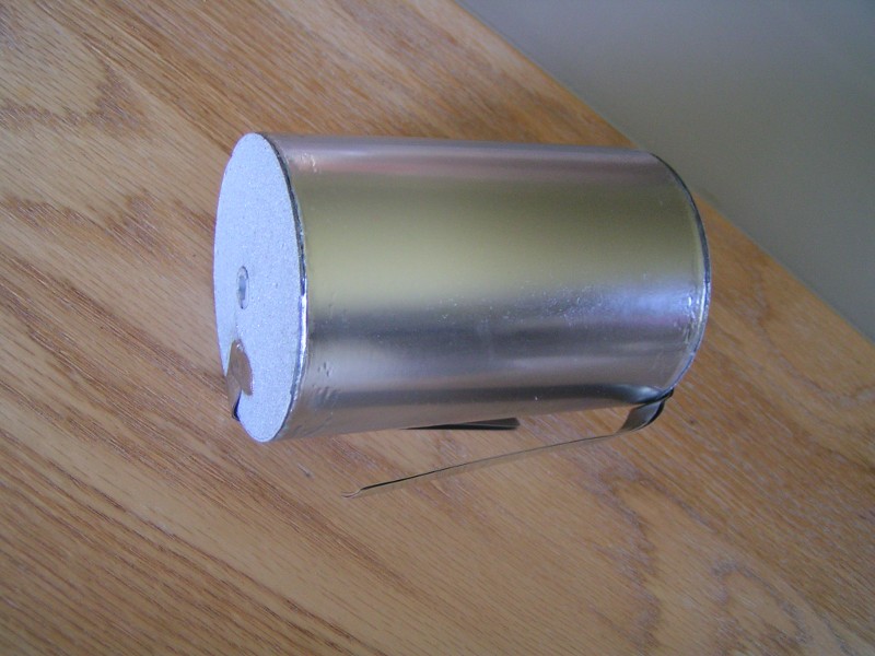

Nobody said anything about it had to be tin foil, just foil, that's all. Both Rifa and Wima makes fine specimens of those. Both can be had from Elfa, and the usual suspects.
Magura
If want to get a serious industrial film cap look for so called pulse caps you know the ones that specify current ie dV/dt or for a given C value ( like these here or here from Wima). The weak link for all film caps is the method of attaching the metalization/foil to the termation end cap or wire.
Flame spray is what Roederstein used see thermal spray details here.
