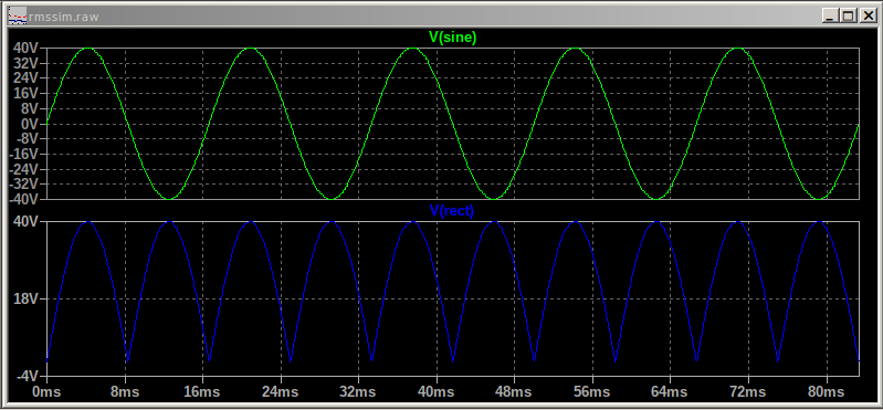

The supply is subject to a ripple voltage. Your 60Hz sine mains gets rectified into a 120Hz...
Picture: V(SINE) is secondary of your transformer. V(RECT) is after the rectifier.
Your capacitors only get charged up when V(RECT) exceeds the voltage stored on them. This is one source of ripple current. That process also means that your DC bus to the amplifier has a ripple voltage on it.

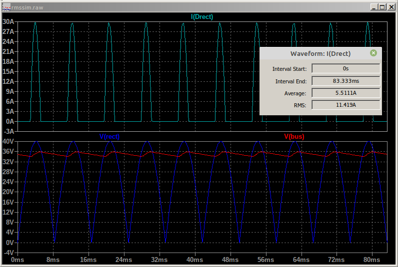

Picture: I(DRECT) is the rectifier current V(RECT) is as before. V(BUS) is the DC supply to your amplifier. You can see that the capacitors are only charged up when the voltage from V(RECT) exceeds the V(BUS) voltage and discharges when it is below.
The peak I(DRECT) current is high, don't place too much value on the value it's a model, but the RMS is lower. Of more immediate concern is the ripple voltage, how much it sags in between charging.
If the bulk capacitance, total uF, is too low then the ripple becomes high and your amplifier will be driven into clip earlier. That affects the claimed rated power. As I suggest I don't think Klipsch are being honest or they are quoting funny numbers.

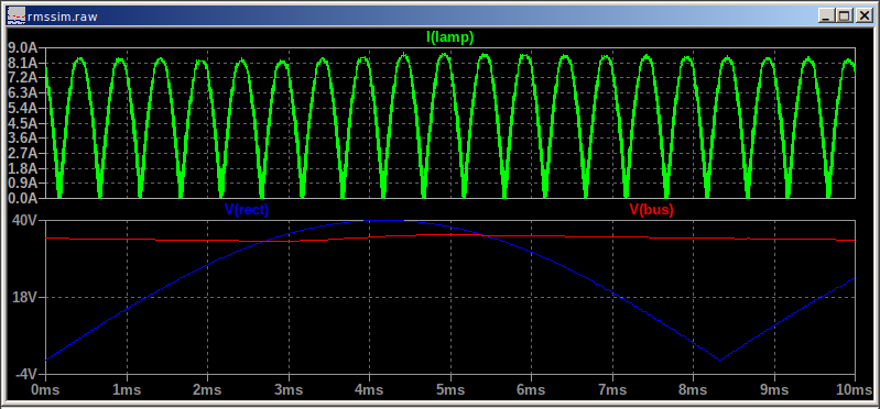

I(DRECT) is not the whole story as far as ripple current in the capacitors is concerned. On the other side of things the amplifier draws current to produce music.
Picture: I(IAMP) is what the amplifier is drawing from BUS. This is a 1KHz sine wave at the limit of clipping. If you look closely you can see the ripple voltage imposed on the peaks. When V(RECT) is above V(BUS) most of the amplifier demand will be from V(RECT) otherwise it is from the Capacitors.

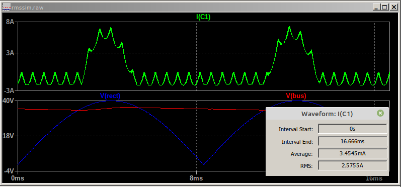

As a result the current in the capacitors is a mix of two sources. One low frequency, Mains, and one high frequency, Audio.
Picture: This is the current in one, of the four, capacitors. It comprises the mains charging current and the amplifier music current, discharge so it is negative. There is also higher frequency current. That's the ripple current in the amplifier output filter inductor.
If you care then you have to account for the fact that these currents are at different frequencies and the ESR of the capacitor is different at those frequencies resulting in different losses. However...
