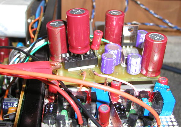

The best approach is to add external Very Low Noise and ultra low impedance Vref Generator. Below is a circuit I often use. Pls. note, it’s for designs where Vref is 2.5V. Due to the “High” impedance of the internal Vref (VBias) Gen, they don’t normally mind the addition of the external Gen. Nevertheless; it’s prudent to match the output voltage of the External Generator, as close to the output voltage of the internal Gen as possible.

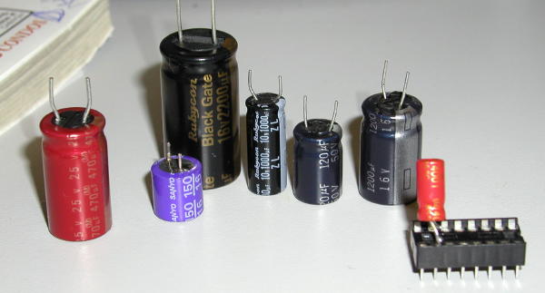

Due to the Feedback of the OP-AMP, the impedance of the Generator appears almost “flat” within the Audio band (in fact, the output impedance is much LOWER at LF) – thereby limiting the sonic “footprint” of the VRef Capacitor used. Its important to realise that RF decoupling is still required, and the OP-Amp will offer very little correction - due to its limited gain Bandwidth at RF. The RF quality of the 100nF ceramic is critical, try placing it directly across the DAC Vref Pin and Ground – and the electrolytic C5 should be a Low ESR such as an OS-Con or Tant. The quality will now be less critical, due the active correction of the OP-AMP.
Note, the feedback is taken FROM the DAC Vref pin; this removes the effect of PCB wiring and any noise. The limitation at LF is now due to the DAC’s package bonding impendence.
The FB connection should be as short as possible back to the Op-Amp.
19746d1073832412-capcitor-type-vref-dac-vref-gen-jpg
