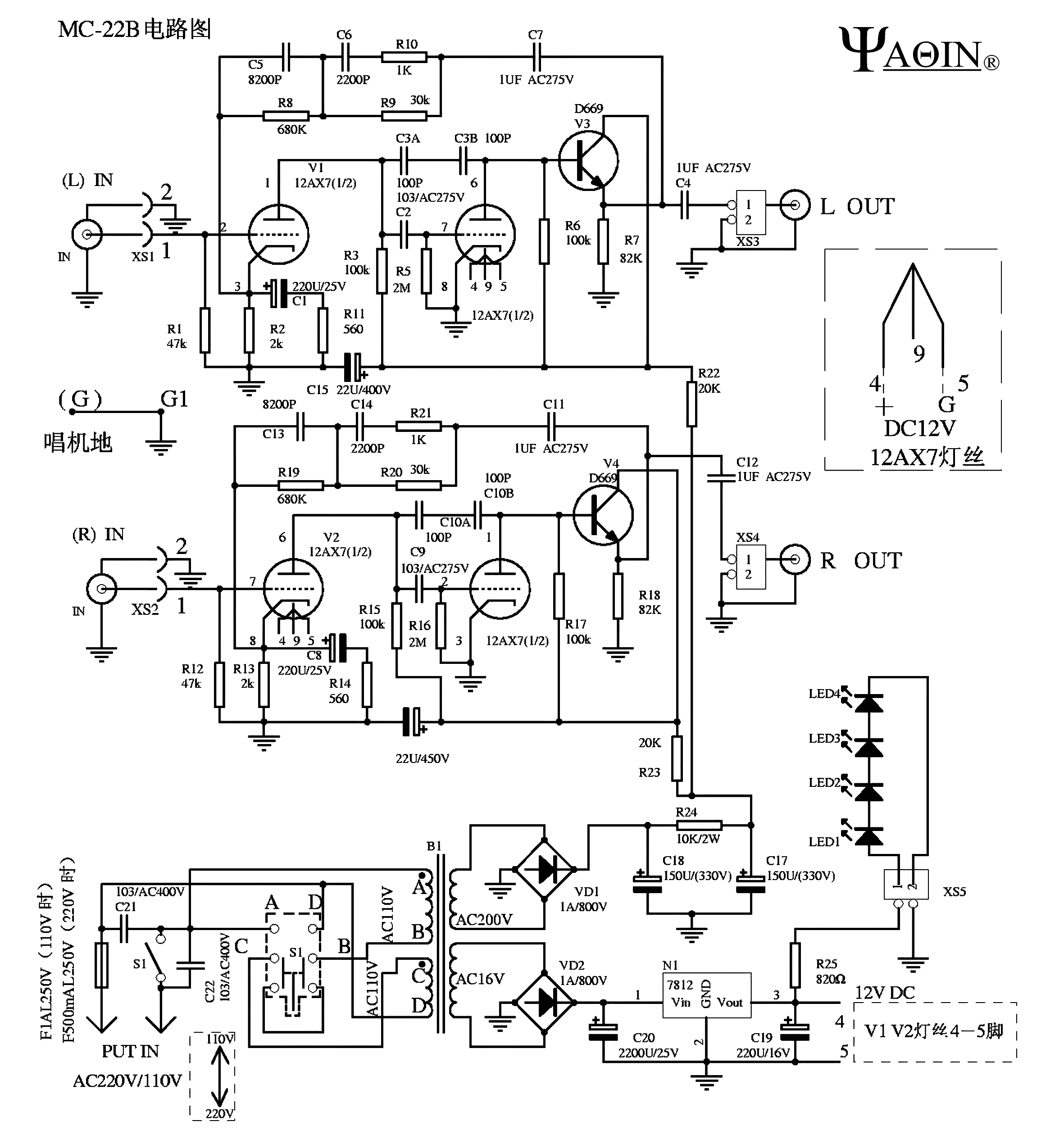

You can't improve a bad circuit by replacing a few components. You could build a different circuit in the same box, but that is not a re-build but a replacement.
Show us what your friend Les says, and we will comment on it.

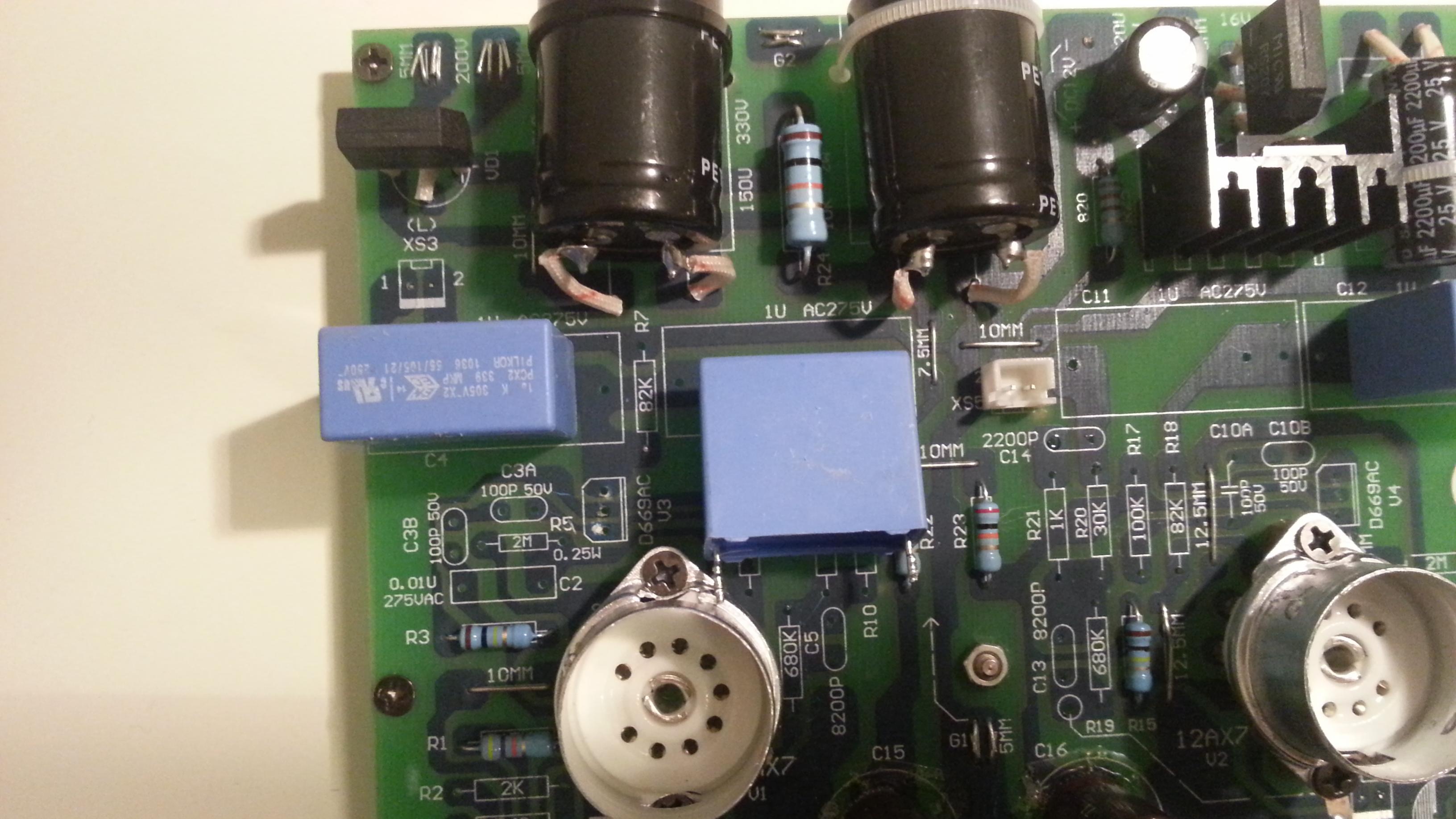

Is this the rebuild you were speaking of? If so, it is a replacement yet cunningly using the same PCB. At a quick glance it looks to be a much better circuit. No longer a useless MS-22B, but a reasonable preamp which just happens to occupy the same space and re-use some of the same components in a completely different circuit.
This seems to be the modern way of doing DIY: buy some Chinese junk in a pretty chassis, rip out the innards and replace it all with something decent. Then everyone is happy: the Chinese have their sales, and we have decent audio. Sadly, the gullible just stop at the first stage.
Yup that's the rebuild that I was talking about. I thought I did attached the file and I just realized I didn't.

If you really want a RIAA compliant phono tube amp... You can always take the case, transformer (it is a 200V secondary from the schematic), the 12AX7 tubes, possibly some caps and some resistors, and try to build this instead.
Groovewatt a DIY Vacuum Tube (Valve) RIAA Phono Preamplifier Project
Otherwise, go solid state (like the one in the link I posted a little while back) -- runs cooler, some would say easier to build, and it will probably last longer (no tubes to deteriorate). Of course, there is this one with low parts count and low voltage too.
