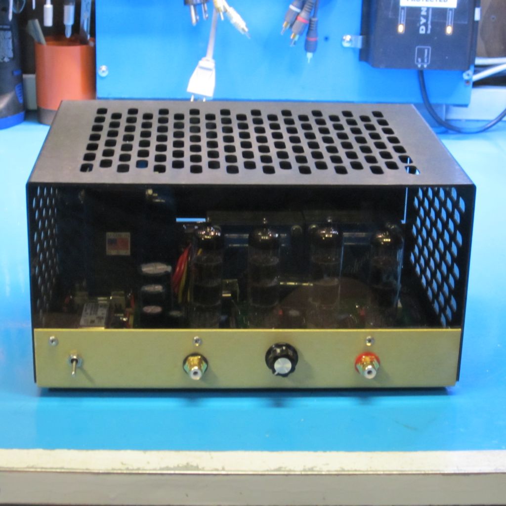

Help me pick four (4) coupling capacitors for my K12G tube amp, 0.22µF. I think I have it narrowed down to these three (3) based on reviews & the link below. My budget is up to about (roughly) $60 / Shipped for all four. I figure I can splurge on these because I don't believe I'll be upgrading the OPT's for this build.

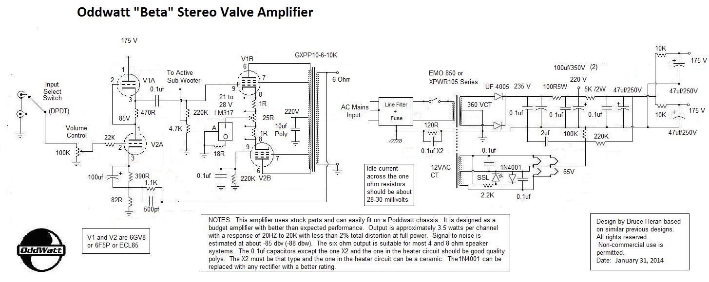

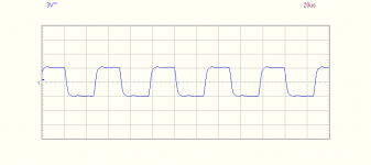

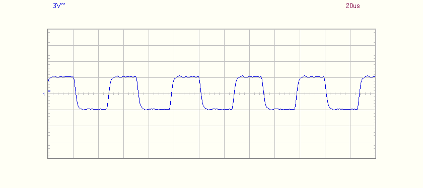

Hi, For what it is the amp is OK, trying to extract a lot of quality sound from it gets costly quickly. I would opt for the CXPP10-MS-10K trannies and Russian K40Y9s in .22uf (just 4...skip the input ones). Replacing the cheap rectifiers with UF4005s would be worthwhile as they are cheap. Pass on everything else. Having modded a few in the past, it just is not cost effective to do much more. The schematic shows an amp made from a K12 just for the fun of it. It has excellent performance and shows what can be done. Not for the faint of heart as there are numerous changes. It was fun seeing what could be done to the K12 to make it sound like I thought a real amp ought to. The squares are perfect in the mid band and quite good even in the bass region. The biggest issue is that it can only deliver 3.5 watts RMS per channel. The square wave is at 20KHZ.

Hi, considering that the actual voltages on the caps are relatively small and the Russian K40s are rather robust I would probably use the 0.33uf / 200 volt ones. If you want though the 0.33uf /400volt ones are plenty sufficient. Both are a lot smaller than the ones you picked. The input capacitor, the 0.22uf that is right in front of the volume control is seldom needed. It is there primarily to block any DC that might accompany the input signal. Since most equipment that can have significant DC on the output already has blocking capacitors the one in the amp is redundant. I have worked with numerous pieces of equipment and have not seen any with significant DC at the outputs for a long time. Unless you have something odd, skip the input capacitors. Less stuff in the signal path virtually always results in better sound. The reason for the 0.33s is they are usually easier to get and cheaper than the 0.22s.
BTW if you are on a tight budget the Edcor GXPP10-6-10K transformers work rather well in these amps and are quite inexpensive (last time I looked they were under $20 each). You will lose a little in the sub 40HZ range, but otherwise pretty clean sounding to about 18K.
