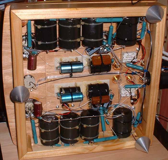

Why a bunch of unnecessary theory.
Buy very cheap great Russian teflons, open the iron case, unwrap teflon and alu foil and make the capacitor you want for your RIAA preamp.
It will be unbeatable, surely.
