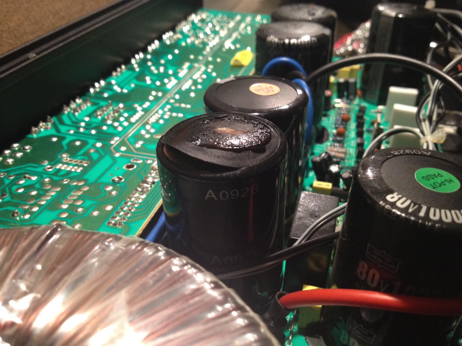

I have a subwoofer amp (Reckhorn A402) that has some swelled caps that need replacing. Lots on Ebay, I was keen on these (2 pcs ELNA Audio Electrolytic Capacitors 80V 10000uF | eBay) but saw a thread on here which debates the authenticity of them. (it was well over a year old though)
Would they be ok? or if not, what would anyone recommend for a replacement of the below caps? they are rated at 80v 10000uF size 35mm width by 50mm height.
I will aslo post this in another thread, but just in case someone local is reading this. Im not 100% confident on replacing and testing these myself. Is there anyone on the forum from the inner west of Sydney or near abouts that can either point me in the right direction of a repairer, or wants to make a bit of cash on the side? ( Im not sure if this would be a stock spare a repairer would have, so id prefer to supply them with the part, unless you think that crazy)
thanks for any help
dave

Hi Dave, I have one of those caps that was posted to my by another forum member who was selling them. Whilst I can't say definitely yay or nay as to whether it is a real elna, It certainly appears to be a good quality cap. He was not from HK though so no idea about the ones you linked to.

yes if it has failed and is rated at 105 deg, then running with 85deg caps will likely result in even earlier failure (unless the original caps were faulty).
The life of the caps is rated at their temperature rating (say 3000 hours at 85deg) if you run then at less than the rated temp they last a lot longer. If you run them over the temp then expect dramatically shorter lifetime.

Hi Dave, the ebay ones are a bit of a lucky dip. firstly because there are no specs, and secondly because of the notoriousness of fake caps on ebay.
The ncihicons whilst not having an audio label, do have good specs. they should be low ESR (tan theta of 0.2) and they have good ripple current handling (over 6A).
The Ebay ones may be fine, or maybe they won't be. I'd personally go for the Nichicons as at least you know what you are getting, and the cost is not too much higher.

OK it is probably good that it was still playing. I've never had PS caps go like that so can't say from experience whether the noises you are hearing are a result of the failed caps, or the failed caps are a symptom of another problem, but I would guess it is more likely that your noises are due to the failed caps.
for the job of replacing the caps I'd recommend getting a solder sucker and some desolder braid.
I've got one of these Metal Desolder Tool - Jaycar Electronics which I find much better than the bulb type.
I use it to get the big blobs of solder off and then clean up with some of this 3.0mm GOOT Desolder Braid - Jaycar Electronics
You are much less likely to lift the tracks on the board if you use a good desolder tool and some desoldering braid. the caps should come straight out after that and the holes should be clear for putting the new ones in.
