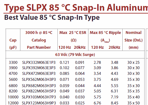

No, ESR tends to go down as uFd goes up. See attached clip from CDE SLPX data.
(Any other result is not natural.)
I have seen it that two smaller caps parallel give a lower ESR than one big cap. This does not show in SLPX data; you should of course read the specs for the caps you favor.
What *does* scale poorly is max ripple current. A cap with 3X the uFd is not even 2X the max ripple. My impression is that this is "never" a problem in audio, particularly hi-fi speech/music. Max ripple is mostly about outside surface, skin on the can. We audio-dudes aim for low ripple which means BIG uFd which means a can which is big for the job. Also we may burst to 100 Watts, even cook for an hour on the bench, but real use is under 10W even under 1W. In an AB amplifier the average current is quite low, and the ripple current also tolerable. For an amp drawing 50V 1 Amp, 10,000uFd, the ripple current is about 1.44 Amps. (Varying VERY little with uFd.) These "best value" caps are rated 5+A in this size. Even at 3,300uFd we have 2:1 safety margin. We get in trouble below 1,500uFd (not on SLPX data) where the can is very small (<1"x1"!) and max rip falls below 1.5A. But also ripple voltage is 16V, which is clearly awful for 50V audio supply.
And this 50V 1 Amp is Full Output. In listening we would be down near 0.2 Amp or less. Cap ripple current is near 0.5A, 7:1 safety factor.
