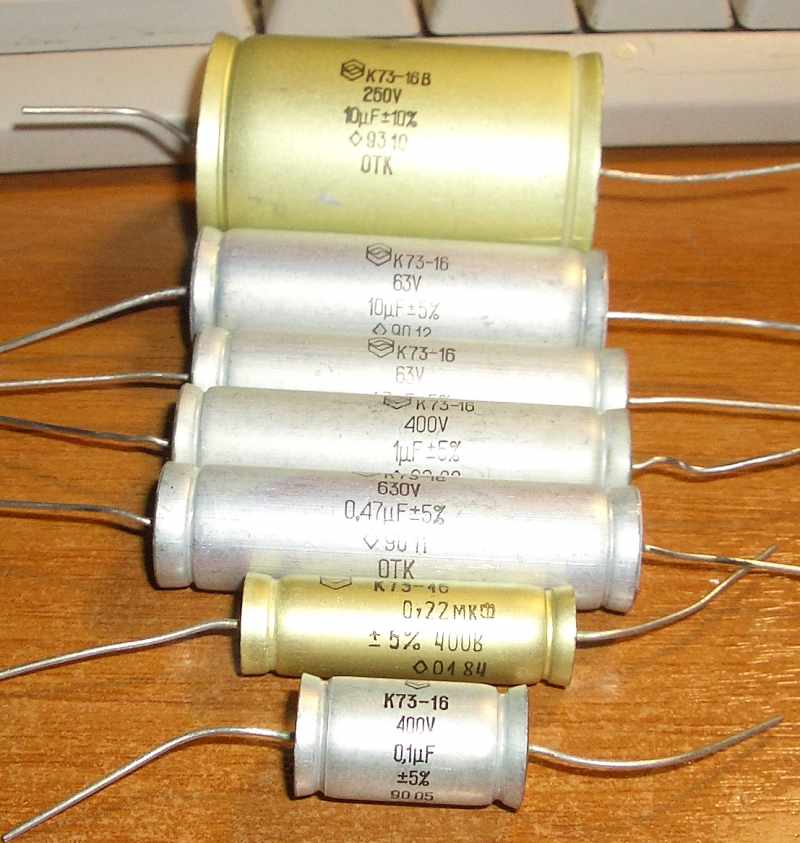

Search on ebay PETP capacitors, they costs 2 cents and are simply great!!
I just ordered some K73 to try out.
I also ordered some .5uF silver micas, more k40-Y .22 200 and 400 volts, and more FT3. I've got around 30 of the .22 uF 600V K40Ys on hand.
