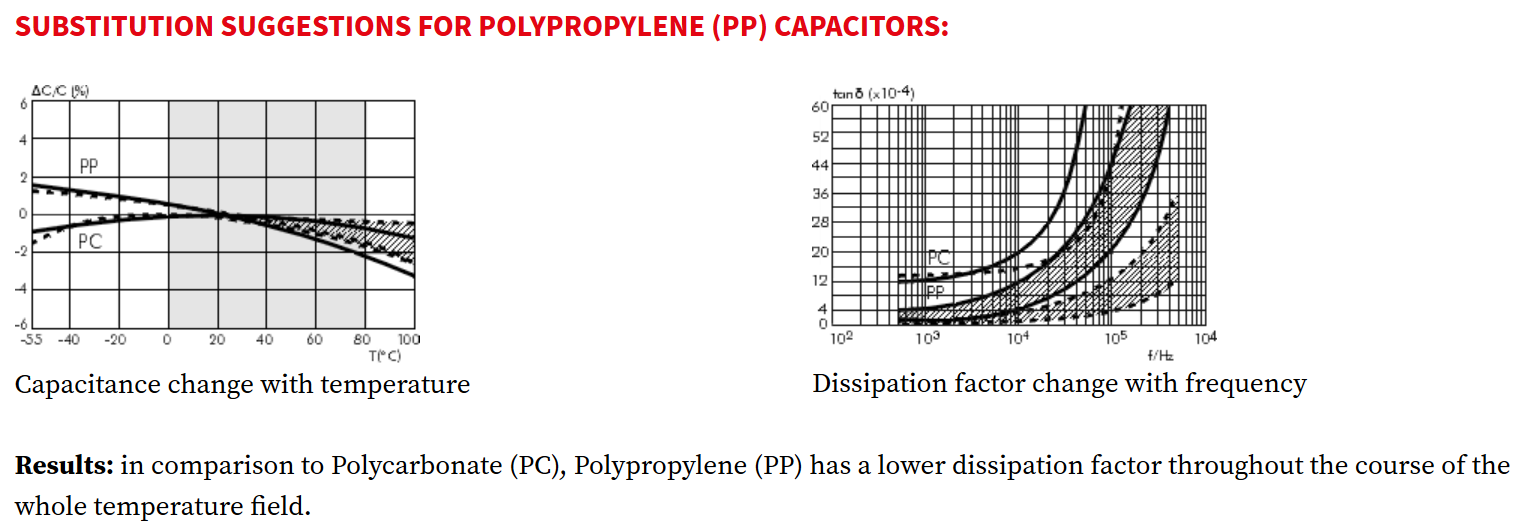

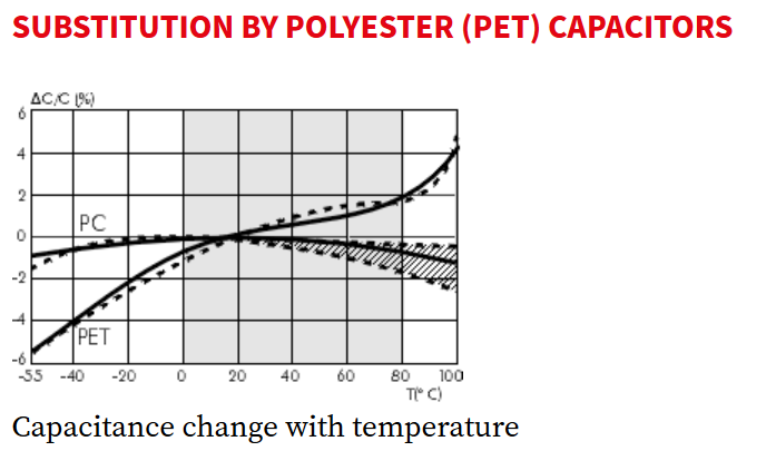

WIMA polypropylene caps have the tempco in the datasheet: FKP 3 film/foil capacitors - WIMA – Competence in Capacitors gives a figure of "Temperature coefficient: -200 x 10-6/°C (typical)"
And then there are some Graphs here: Special technical subjects - WIMA – Competence in Capacitors (Look under "Substitution of obsolete polycarbonate (PC) capacitors")

Indeed, polycarbonate capacitors were of the best stability.
They don't exist anymore. We must do with substitutes.
It seems the substitutes are not as good.
