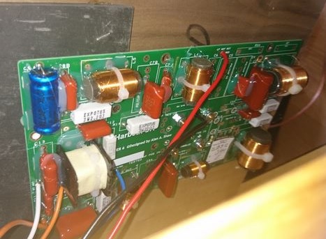

What we know about wet Electrolytic Capacitors is that they age badly, overheat and have a significant resistance. Alan Shaw of Harbeth admits this.
After 25 years or so, the wet electrolyte dries out and they cease to behave as origonally intended! Evaporation of liquids, an' all that.
Nevertheless, they had a place in early Harbeth designs, along with MKT capacitors, this being a Harbeth HL5 IIRC:
The blue thing on the left. Way cheaper than a (MKP) polypropylene capacitor of the same value.
What I find interesting about Harbeth, is they use ferrite inductors in the tweeter circuit. Ferite is demonstratably non-linear. Capacitors are far easier.
