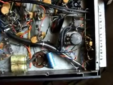

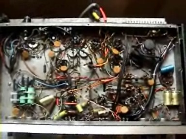

the photos !

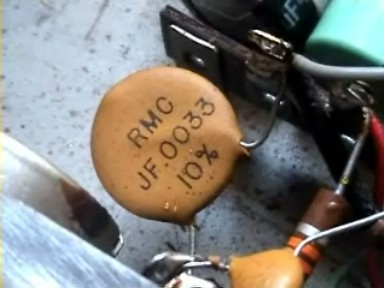

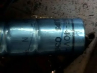

Are those replacements caps good, Or could I change for best one ?..the last picture : original conoc ceramic caps (to change ??)

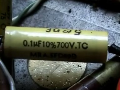

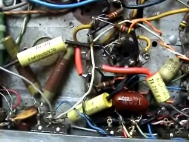

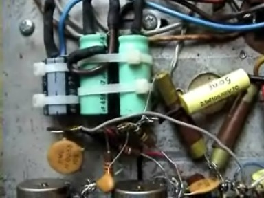

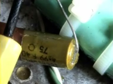

Thanks for your reply v4lve lover ,but , as you can see in the pictures , they already have been changed underneath :my question is :are those electrolytic replacement caps good enough ,or what brand should I take ,if you have an advice about that.
.The same for the other caps you can see in the photos ( for instance , the yellow ones marked 0.1µf..., (they look paper caps(Safco is the brand) ,( I'm a newbie ...)which should not be the best....
Any answers?
Many thanks
Any answers?
Many thanks
