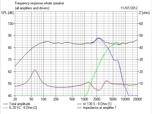

Frequency response changes of 4-6dB and Phase changes of 45 degrees would be expected with critical components like bass shunts and notches. Below is the simulated effect of changing a 15uF (assume 1.5 ohm ESR) non-polar for a polypropylene in a second order bass filter, you must take my word for it that phase alignment (and imaging) gets ruined too. Shocking, isn't it? The exact effect will depend on the filter topology and how load tolerant your amp is, which is probably why no-one will ever agree on this subject. 🙂
