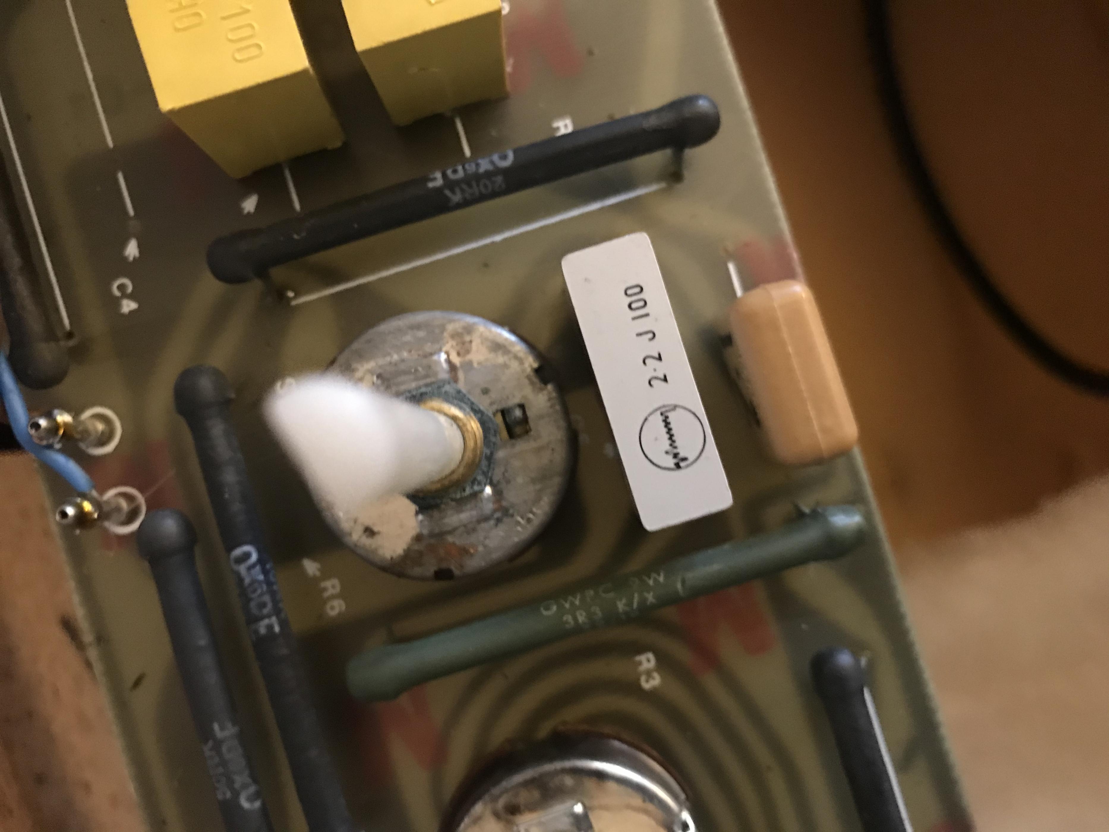

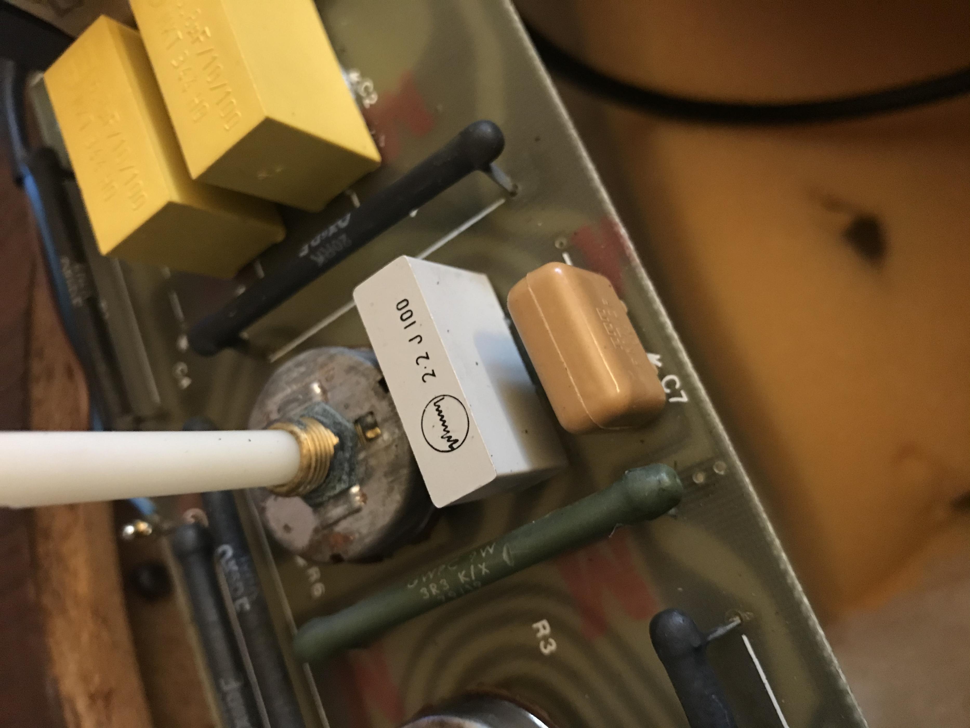

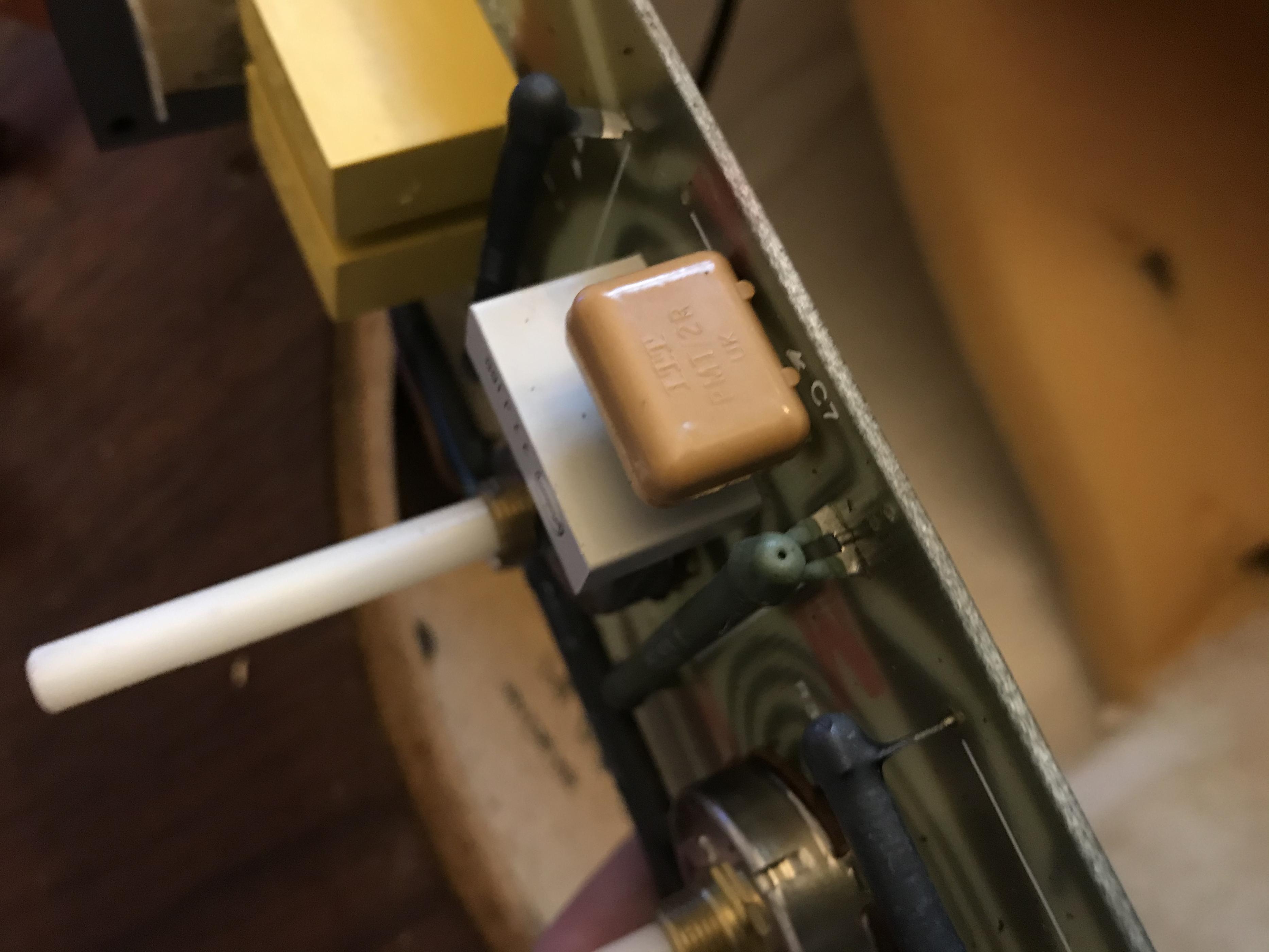

I have my Tannoy SRM12x speakers that I recapped back in January with equal value Ansar supersound capacitors , and gave them 3 months of daily usage to burn in but I was never happy with the sq so 2 weeks ago I put all the old capacitors back in and hey presto the magic was back , some had strayed from 6.8uf to 7.1uf ( I tested them all when I initially removed them ) . So I now have all 8 identical nos caps on their way to me ( they’re Philips) but I need to get 2 identical ones seen in the picture, there is no brand name on them , they measure 27mm x 8 or 9 mm and have 2.2 J 100 printed on them ( and the little wave thing )
Anyone know this brand ?

It's a film type capacitor made by Plessey. By the markings its probably a 2.2uf 100v capacitor.
btw, film capacitors don't stray in value but will vary because of tolerance in manufacturing and are typically available in 5%, 10% and 20% tolerance values, so a 6.8uf capacitor that measures 7.1uf is actually within tolerance (+-10%).

Yellow are maybe MKC from Philips and the white MKT (Plevey so), size of the pot makes me think about that.
Why did you recape if already film caps ? they last a life... Better is to solder back the one you have if you keeped after a carreful measurement. Philips is more or less BC component... while not sure they are exactly the same, I found subjective changes at ears between MKT of small size... it may also be bias...
The only problem with desoldering & resoldering a film cap may affect it due to the temperature.
MKC are hard to find these days, try Ebay with old Wima NOS or russia. For the white if really a MKT, you have excellent K73-16 ( 5% 100 Vdc exist) and are often in the 2 to 3% range when you measure. Cheap and good sounding too, not squarred casing though.
