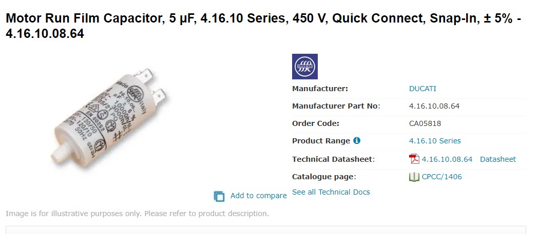

Cheers guys!! :) Yes very similar, it's for a small motor I guess but if I do use it down the track I'll have to work out if it's a run or a start cap, if you use a start cap as a run cap it can damage it or even explode as a run cap is in circuit all the time. If it's a start cap the motor starts then a centrifugal switch kicks in after some time taking the cap out of circuit to prevent damage.
I don't think it's clear which one it is??? I'm hoping that someone finds it familiar haha. I'll look at those links you suggested :)

yeh that is true BUT I heard from multiple places if you use a start up capacitor as a run capacitor it could even blow up as a start up cap is not designed to be in circuit all the time, the start up cap in devices like bench grinders lets the motor spin up and after it gets to a certain rpm the centrifugal switch takes it out of circuit preventing damage.
The silly question is how do you know if it's a run or a start cap? wouldn't you think it would be clearly labeled as it can blow up!! You don't want 250v at 10amps going bang in your face. I've seen caps go off like bullets no joke they can be so dangerous.

The EN 60252-1 standard mentioned at the below right on the capacitor gives the definitive answer. The standard applies exclusively to motor run capacitors. If it were a start capacitor, the cap would have been covered by the -2 version. So look no further, it's a motor run cap.
If you want to see for yourself, go here and read the standard's scope in the preview:
