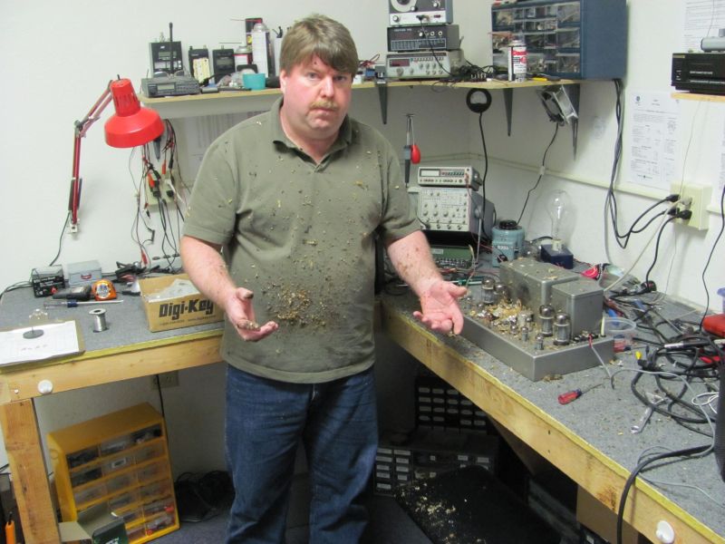

Hello guy's, I see that this is an old thread, but I need to post something in response to your questions. I amp the one that got exploded upon.
Attached is a photo of me after the explosion.
It was not a fun experience....

Judging by the mess... "she blowed up real good!"

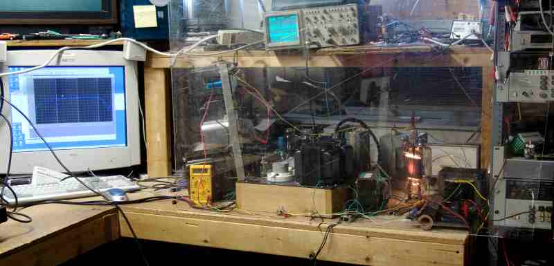

When you build something totally outrageous, powered by a 1500 volt 1/2 Amp power supply, you put a 1/4 inch sheet of Lexan between it and yourself, grab a fire extinguisher, then hit the explode button.
The 833A SE Amp Prototype

The plexi blast shield looks like a good idea! Probably should be 1/2" lexan though? I also have blown up many components, but this was by far the worst. My face was only 4" from the path of the aluminum can as it rocketed to the sealing.
I lost access to my old youtube account and it went away. I will post the video again and put a link in this thread.

I'm still laughing at the size of those transformers,
The largest one (behind the yellow meter in the photo posted here) is on a power supply from a tube type Motorola radio transmitter. The power supply is rated for 1500 volts at 1/2 amp. I am sure it could put out a lot more than that if things went wrong. I had 4 of them and tried to give them away. I got no takers so sadly they went to the scrap dealer. The major objection was the weight. The power supply weighed over 100 pounds, 75 of which was in that transformer.
I had that prototype running for 2 days. People could hear my guitar two blocks away. Imagine a 200 watt Fender Champ. That was dissasembled, but I still have the parts to make the final version. It would be cool, especially with that big glowing tube in a clear Lexan box. Unfortunately I doubt that it will ever get built.

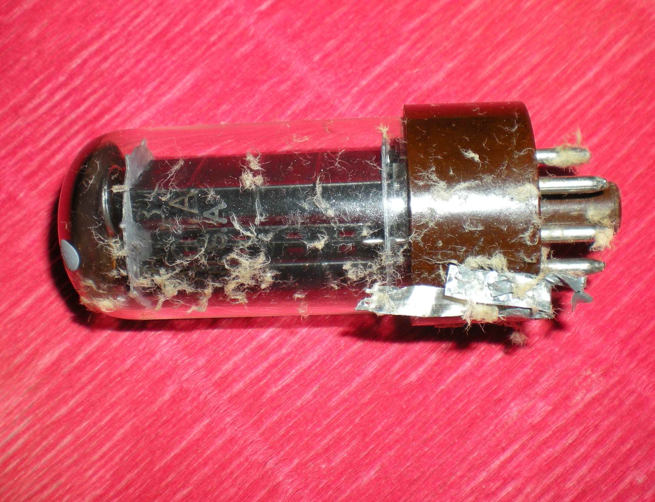

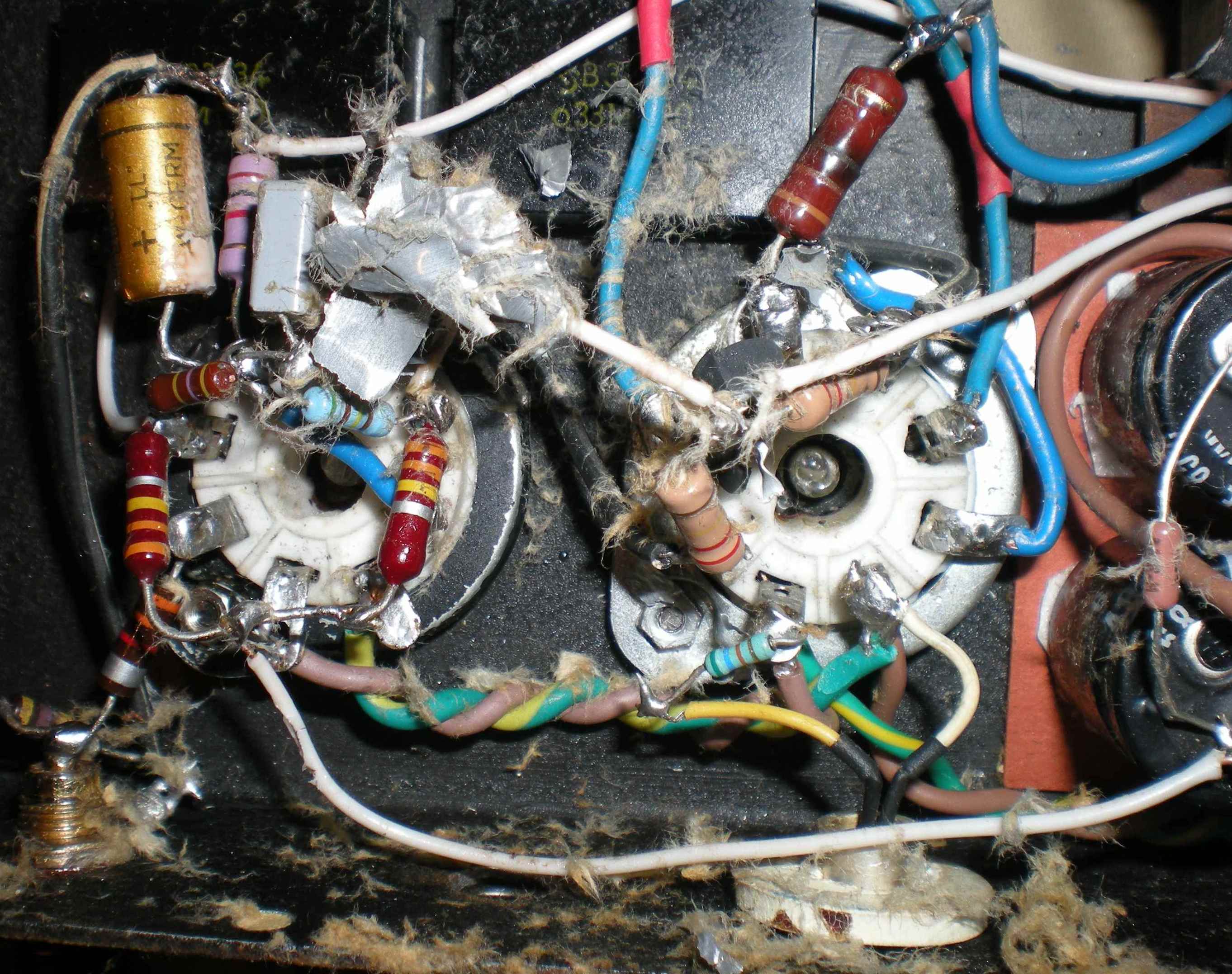

Haha, I got some cleaning up to do
I was prototyping a circuit, turned the amp on and there was this big hum telling me this thing ain't working as planned. I didn't turn it off, just waited for something to go massively wrong - those burned out resistors are very easy to troubleshoot. But no, no resistor smell, the first to tell me "you got me messed up' (in a loudly way) was the cap. It was a bypass cap, you can see the burned out cathode resistor in the pic. That 5Y3 was sitting nearby and received some collateral damage.
Curious thing: the metal carcass is intact, looks like a bullet shell. Completely empty and clean in the inside.

Sounds like you exceeded the capacitors ripple current rating. A reverse polarity connection maximizes the effect. A stiff power source that won't give up will often lead to a successful launch. 😉
Good thing you didn't loose an eye. Those tiny dipped tantalum capacitors can explode and do such damage. Launched electrolytics can punch holes in ceiling tiles or exit through closed windows.
Play safe.
Play safe.
Well I did let it run intentionally knowing something was wrong, guess that's not the way to go but I was never in danger (cowardly hid myself behind a wall). Anyway, it was fun.
Nothing cowardly about that at all. I agree allowing the circuit to melt something telltale like an inexpensive resistor is a valid troubleshooting technique...in some unique instances as his may have been, not as a first to try blanket generalization.
