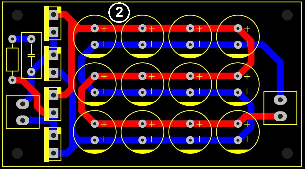

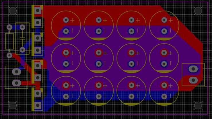

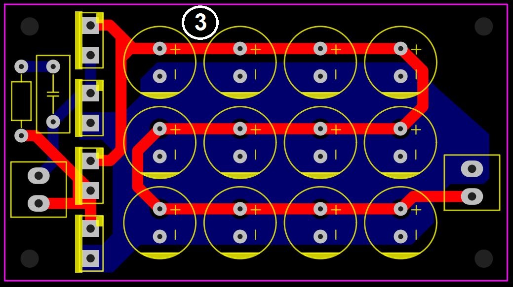

What would be the best way to connect these capacitors?
I made three options ...

I understand.
I will make the recommended change.
EDIT.
About this way, if I understood correctly?
Better! I would place the connectors in the middle for better looks. Also I would use either CRC or CLC with fewer but larger value caps. Plated through mounting holes would make it a sturdy board.
A power LED and series resistor would serve 2 purposes: visual indication that the device is powered on and the LED would discharge the caps at power off also when there would be little to no load.
Now ... if the board will be used for a device where an extra regulated PSU is needed (relays, digital volume control, muting relay..) then a small regulator could be added. If the board would be used for a source device of sorts then a main regulator could also be added, preferably a modern low noise LDO regulator to keep heat and energy wasting as low as possible.
Generally we use a square pad for the + terminals, and a round pad for the negative terminals,
for electrolytic capacitors. This helps to avoid mistakes when stuffing the board.
For diodes, the + anode has a square pad, and the - cathode has a round pad.
Check the bottoms of the snap-in capacitors. Sometimes there is a large flat contact next to the lead.
This can touch a nearby trace and cause a short, either immediately or after some time
rubbing on the solder mask.
Also the square pad is good to use for pin #1 of a terminal block.

For now, it's just a sketch, I leave the details like this at the end.
I thought of using zenner and a capacity multiplier. If there are other better solutions, I will adopt them.
I thought of using a Zener diode and a capacity multiplier. If there are other better solutions, I will adopt them.
