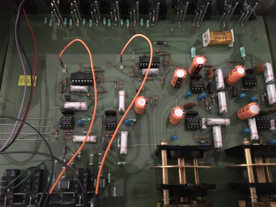

I am in the same boat, I am looking for 11 100uf 250 V film capacitors for a good price.

Maybe those are 100nF (0.1uF)? Defiantly not 100uF....?Here is a pic of the 13 Film capacitors I want to replace
@SirPaulGerman
The film caps are not 100uF. They would be the size of red bull cans.
They are very likely 0.001uF, and I also suspect not all are that value, some are 0.068, some 0.47.
Schematic here - https://www.crownaudio.com/en-US/product_documents/sl1-owners-manual-sl1ownersmanual-pdf
Replace them if you want, I guess, but film caps do not go bad with age, and changing to a "better" capacitor is usually a psychological change rather than an electrical one.

Back 50+ years ago MF on a capacitor meant microfarads. There was also MMF which meant picofarads. You're thinking M means milli, but in modern nomenclature milli is represented by a lower case m. Capital M is (now) mega. Modern prefixes are listed here:

Here is the manual for the Crown Straight line one
.1mF 200V Filmatic X12
Page 15
https://www.hifiengine.com/manual_library/crown/straight-line-one.shtml

The manual was normal for the time it was printed. Most capacitors on that page say mF meaning microfarads at the time (ahem, I was there as a teen when I was first learning this stuff). Again, see the "historical markings" link in my post #35.
Reading "1000mF 40V Axial" using modern prefixes would be a 1 farad capacitor, but no, m was short for the micro prefix, and it's 1000 microfarads.
