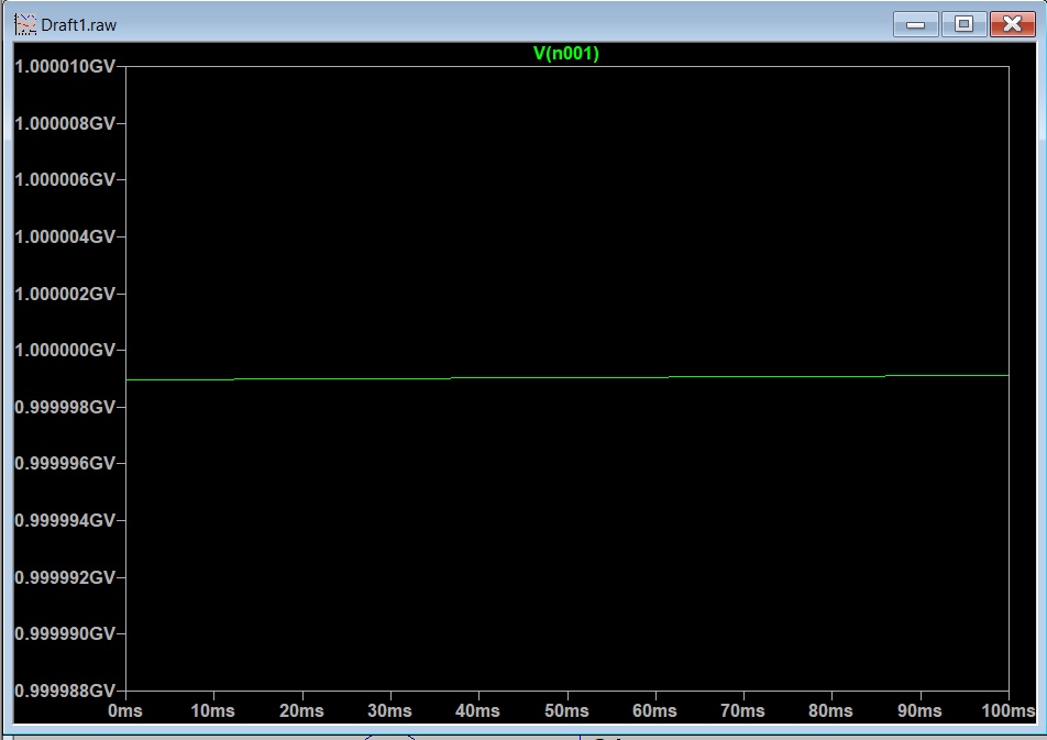

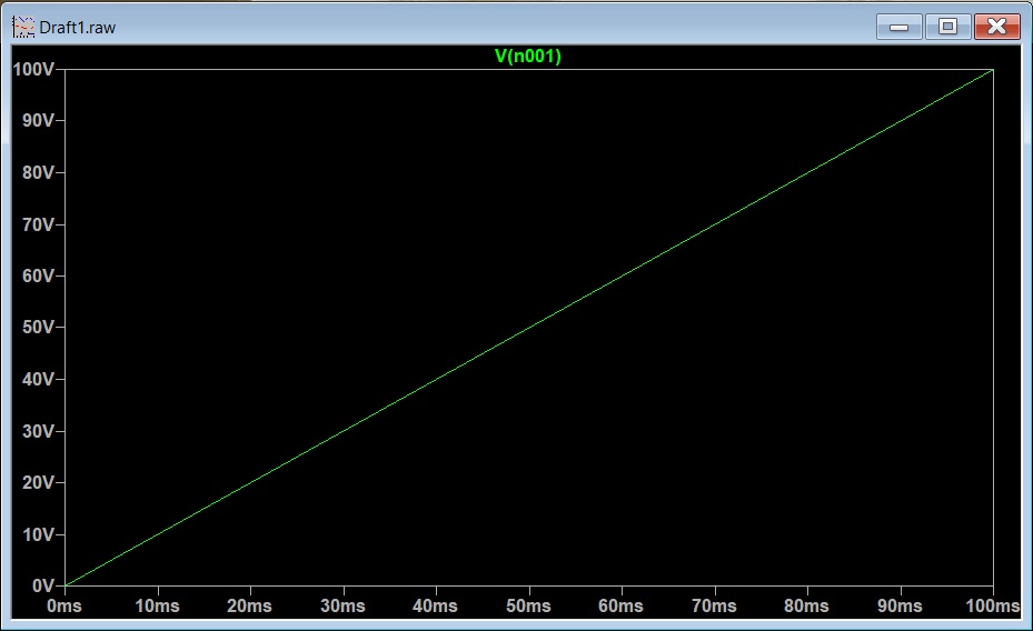

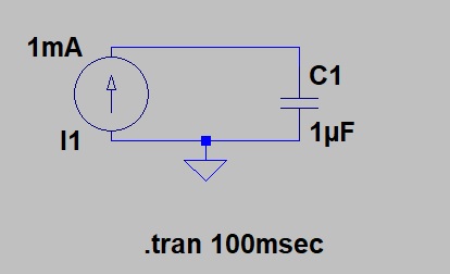

I am trying to simulate very simple circuit where a capacitor of 1uF is charged with constant current source of 1mA. According to my calculations the Voltage across the cap should reach 10V in 10 msec, however SPICE time transition simulation fails to confirm it. What am I doing wrong?
The schematic and sim results are attached. The voltage is as measured across the cap.

I think you will find that the Help File section which discusses the LTSPICE directive ".IC" (Initial Conditions), is incredibly useful. For this one example, and more importantly, for some future day when you decide to try .TRANsient analysis of bistable and multi-stable circuits. Such as the Jung-Didden Super Regulator (and many others).
