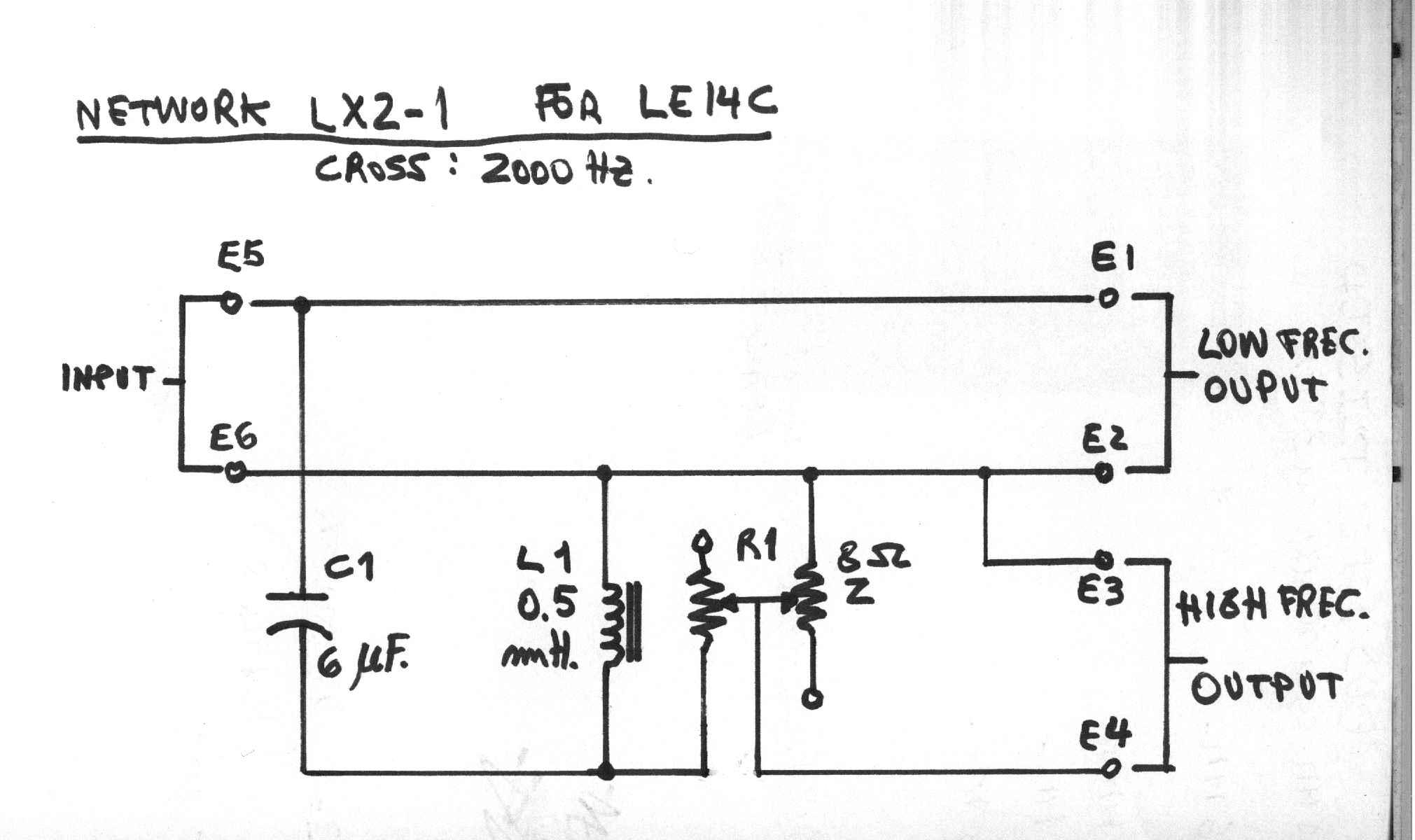

A typical (high pass only) 2-way car speakers are 4ohms, the tweeter and woofer would each have to be much more than 4ohms otherwise impedance drop low enough to damage the amp, since the woofer overlaps with the tweeter... right?If they are car speakers, they are likely to be 4 ohm.
If that is the case, then it would be best just to half the value of the currently fitted capacitor.
No. The tweeter is crossed over so the power at low frequencies doesn't reach it, and since most of the power comes with LF, the amplifier effectively sees only the woofer. This isn't completely true, but it's close enough for a working point IMHO.
Wrong, I'm afraid.right?
The woofer and tweeter do not form a parallel combination in the way you think.
Consider a 4 ohm coaxial car speaker:
Due to crossover action, the amplifier sees the 4 ohm woofer as a load at low/mid frequencies and the 4 ohm tweeter as a load at high frequencies.
Hence the load across all frequencies is effectively 4 ohm.
Like kodabmx's explanation, this is a simplification. Suffice it to say the parallel resistor rule does not apply when a crossover is involved.
Thank you all for bearing with me. So, in sub $50 speakers with 3" to 5" woofers that only have a single capacitor high pass filter, no low pass "proper crossover", are the tweeters set so high that that the don't over with the higher woofer frequencies (3khz-6khz) or is there something else happening with the power throughput?Wrong, I'm afraid.
Although the woofer does not have an external electrical low pass filter, it will have its own 'built-in' filter due to its voice coil impedance rising with frequency plus a natural roll-off due to the mechanical properties of the woofer.
