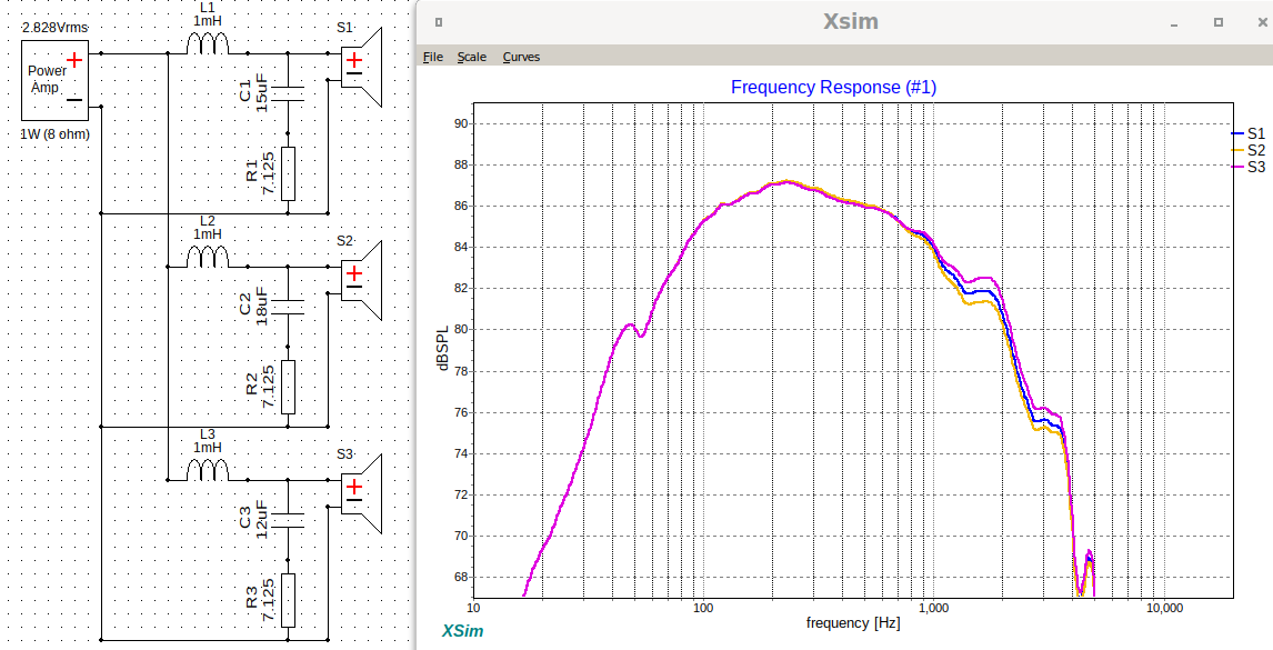

I have been simulating both zobels in XSim with the 8 ohms driver of the soft : plate spl curve.
The area is realy larger than I thought.
For instance at 150 hz, there is 0.7 ohms deeper atenuation with 130 hz than 100 hz. That indeed means the attenuation is beginning before. Something 2.7 ohms at 150 hz instead 2 ohms attenuation.
However I don't see in XSim the spl moving. I assume it is different in the real world related to the amp you have...

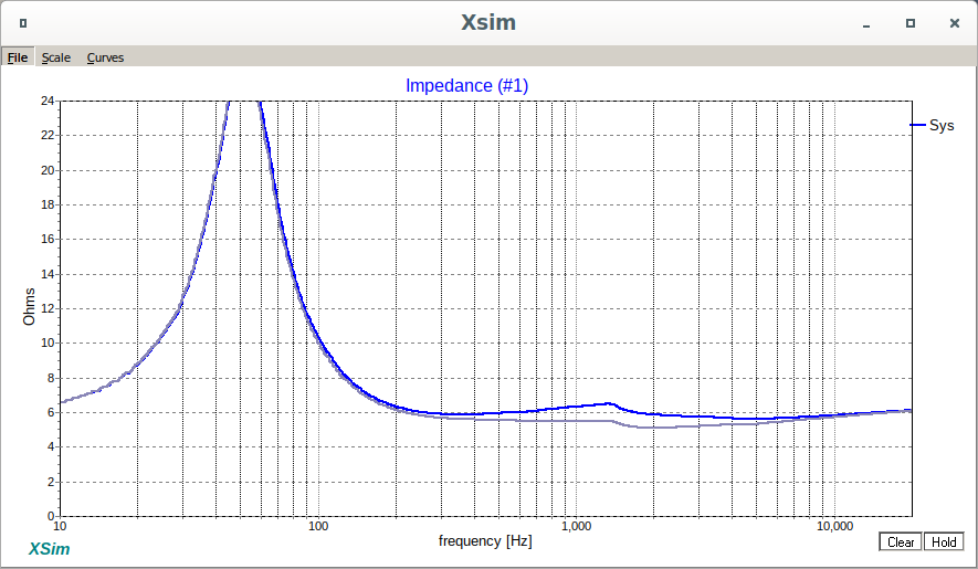

The top circuit is the 'normal' one, then +/- 3uF. The impedance shown is 12 and 18uF.
You can see that the response variations almost go along with the impedance variation, some allowance for impedance phase.
seamlessly the impedance
I would look more at the response result. Also note that most of the difference is in the stopband.
